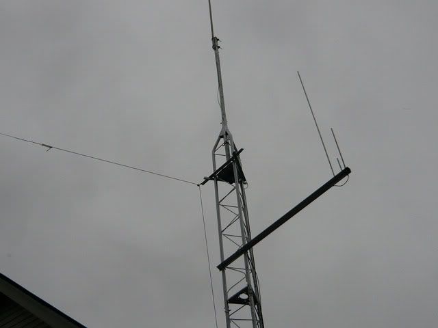

I finally finished installing the dual-band J-Pole I built for 146/440, and installed the wire & coax for the 40m dipole yesterday. The J-Pole tuned to 1.2-1.3:1 across the 2m band, and 1.4-1.5:1 across the 70cm band. The long wire tuned to 1.5:1 on 40m and my first contact was to a fella in North Carolina for about 15 minutes while he was driving home. 40m sure is a lot quieter than 10m, but the nightly radio programs will drive you batty.
That's it for the Winter. I'll do some enhancements in the Spring, but for now I'm well covered from 40m up to 70cm. Here's teh J-Pole on the aluminum yardarm, and the pulley for the 40m dipole.
Jev....whats the range you are getting from that???
I routinely talk all over the UK and Europe, Spain, Italy, north Africa and Central & South America. I have taked to Australia beck in October on 10m...all off of wire antennas. The 146/440 is for around town in the truck. The are not long distance bands.
