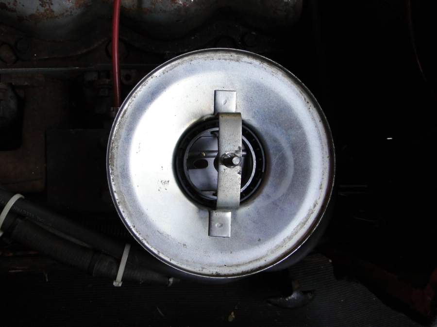

My Spryte came with an oil bath type air filter. It make a mess with all the bouncing around and whenever I take it off I seem to spill some. I was thinking about switching to a paper filter type. I don't have a lot of dust. What has been your experience? If anybody with a 170 cid has converted to paper, if you have part number or supplier for the filter canister, I'd appreciate it.

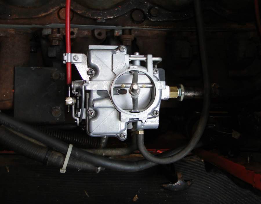

Mine came with a paper filter set up. (1986 LMC 1200) I recently had two Holley #1940 rebuilt at carbsonly.com If you go to their website they have an toll free line or you can send a message. If you call and ask for Carlos he can walk you through the website and show you what he has. I remember seeing the paper filter set up for the Holley #1940, but cannot navigate to the page to put the link up now. (make sure you know what model your carb is and / or have a picture of it)

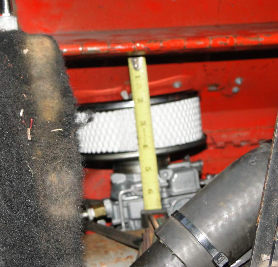

Did some measuring. I have a Holley model 1940 carb with an air intake OD of 2.230". There is 3.375" between the top of the air intake and the top of the air filter screw. The insulation on my cover touches the top of the current 9" diameter oil-bath filter, so I know how much room I have. Thanks for the tip about powder snow and paper filters. I would have learned the hard way without your experience. Now I just need to search the web to see what I can find.

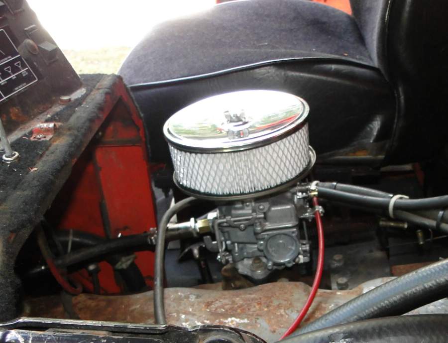

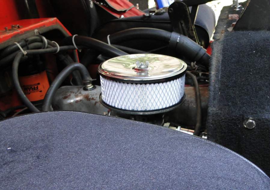

Thanks for the info - I bought a K&N #60-1010. For my 170 CID, it gives me about 40% more filtration than needed. It is made for a 2 5/16 diameter carb. My Holley 1940 measures 2.230 so to get a sung fit I made a washer out of sheet aluminum. Its about 3 OD, with a 2 1/4 hole. I siliconed the washer to the air filter base. I put a small O-ring on the carb before I put the filter on. I also had to plug a 1/2" port in the air filter base. I found a plastic plug at the hardware store and siliconed it in. As soon as I get a pic of it I will post it. Just curious, did you do any modifications? The Mr. Gasket 1490 is for a 2 5/16 carb too.

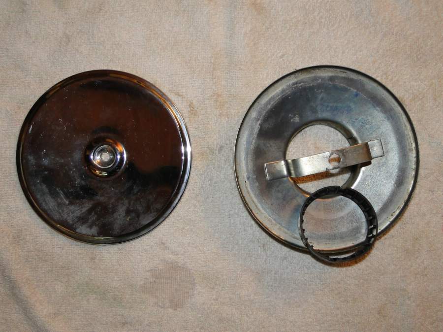

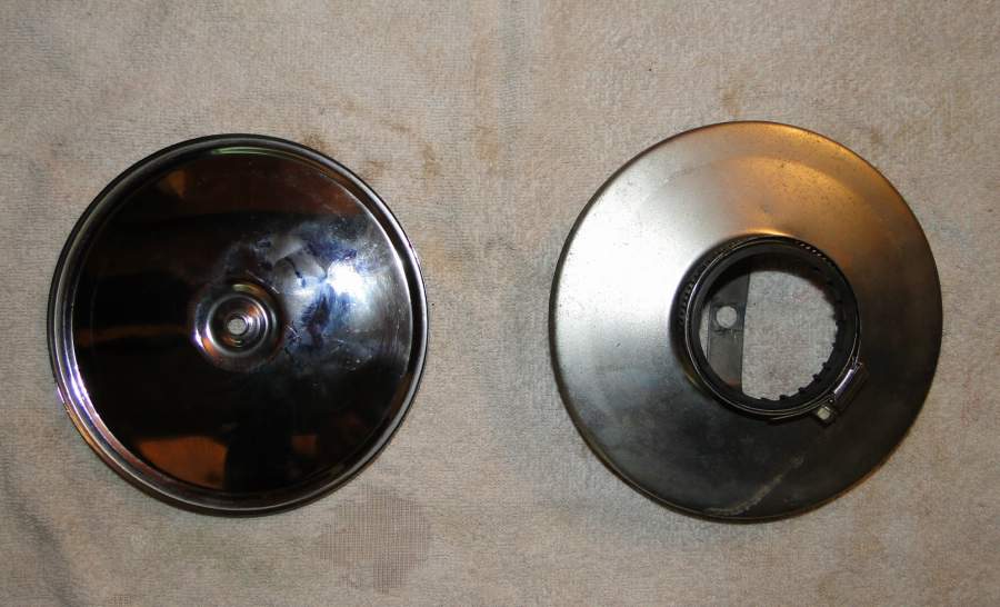

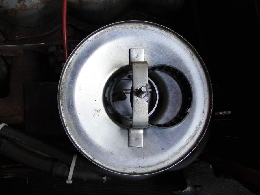

As I recall the bottom of the chrome unit is tapered. There is a hose clamp around the tapered part that holds a plastic piece that fits perfectly over the carb top. (It also appears that you have to twist it a bit and it falls into place) The top nut holds everything in place. The cat is at the Cabin (it's summer resting place) and I left the chrome part of the cleaner on it to discourage critters from taking up residence in the new carb. The snow should be gone in the next couple of weeks so we can drive in. I will take my camera up next trip and shoot pictures of the unit.

Just returned from the Cabin and took pictures of the after market aircleaner that came with my cat. Not sure if the Mr. Gasket unit comes with the black plastic piece that fits the top of the carb. I looked on the black plastic piece and there were no markings to identify it. The black plastic piece fits into the top of the cone, and rests on the top of the carb. (Holley # 1940). I tried to show that in the pictures, but may have taken too many pictures. I am not sure how many I can upload, so if I get cut off I will load the rest in a following post. Hope it helps.

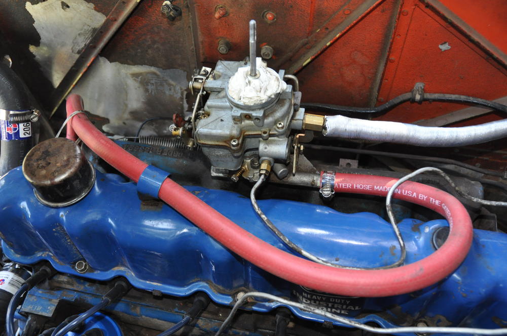

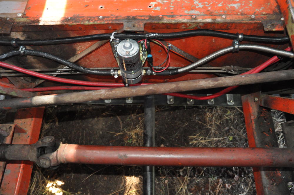

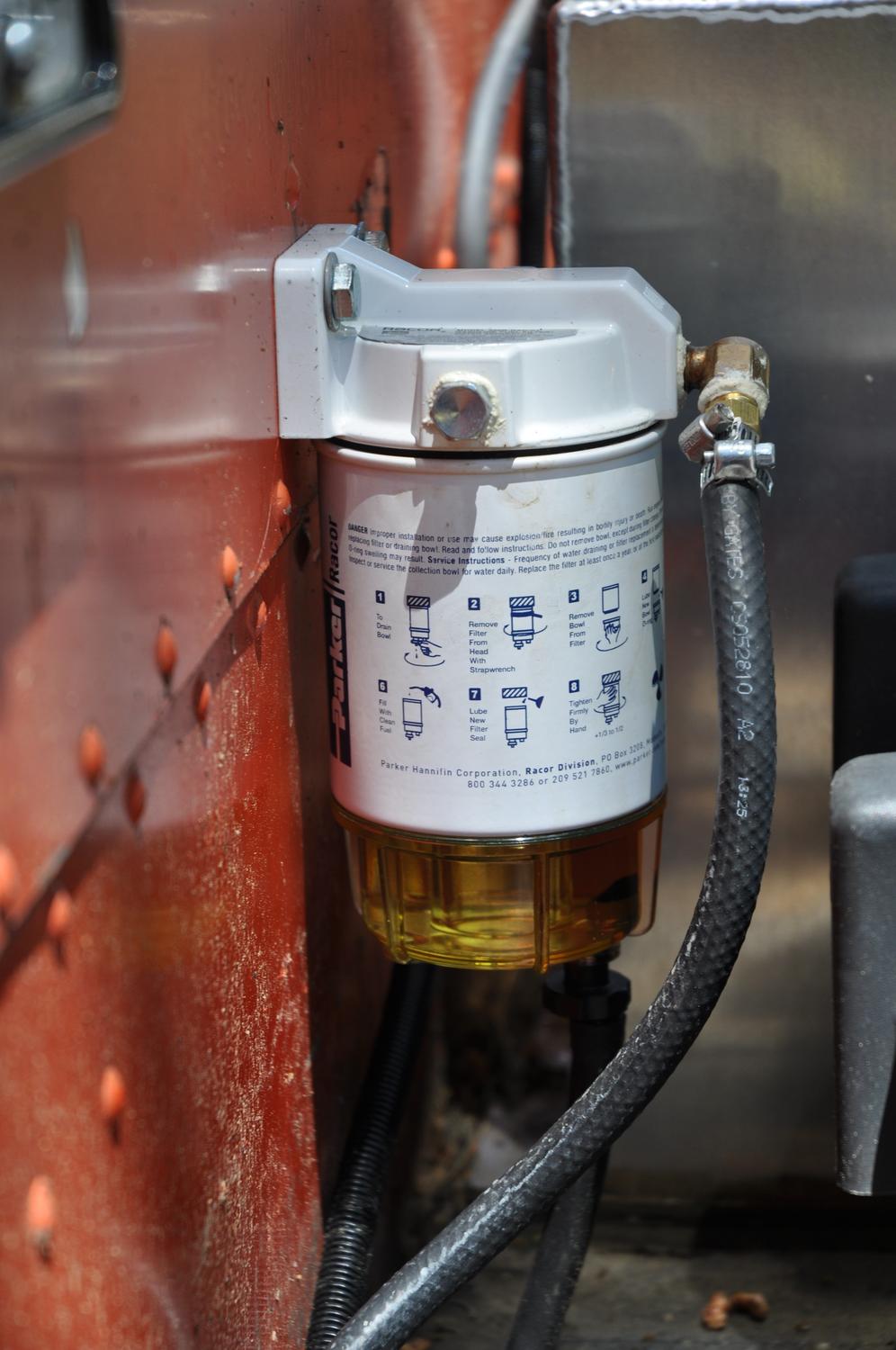

Last season I added an electric fuel pump and reran the fuel line from it to the carb with braided hose. In the engine compartment I put the line in a heat shield tube. Yeah - overkill but not starting with the whole family due to vapor lock is not fun. I did not get any vapor lock last winter or spring.
The Napa electric pump I put in jammed up in the beginning of the summer so I put in a Mallory pump. Much quieter and is supposed to handle stuff in the fuel line better. I mounted it under the floor under the back seat. I bolted the pump to a piece of 1/2" thick conveyor belt and then bolted the belt to the frame. The screws that hold the pump to the belt are recessed so they don't touch the cat frame and the bolts that hold the belt to the frame doesn't touch the pump bracket. No noise in cab now. Added a marine filter/water separator back by the tank. I will see how it works this season.
Found a K&N air filter that fits. Need to take a picture of it. Based on the info on K&N web site, the filter has about 40% more area than a 170 cid needs.
