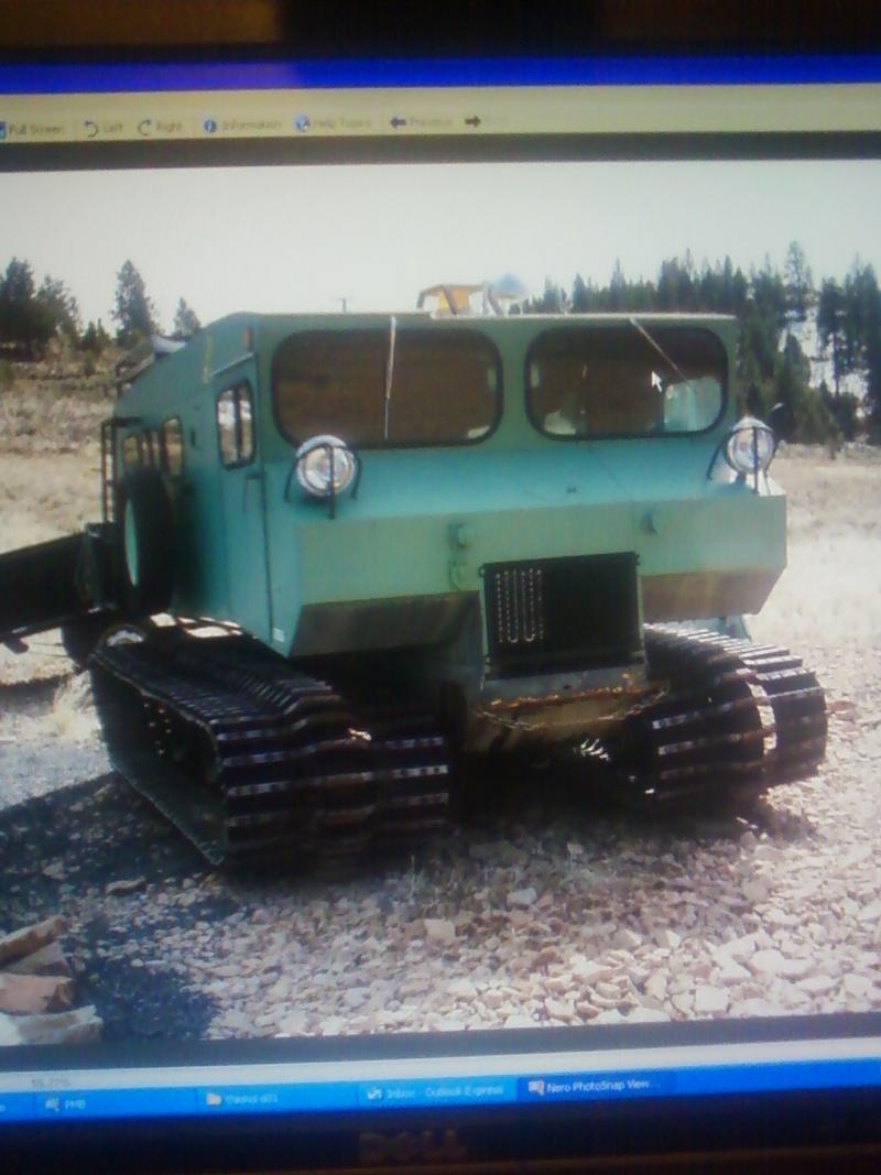

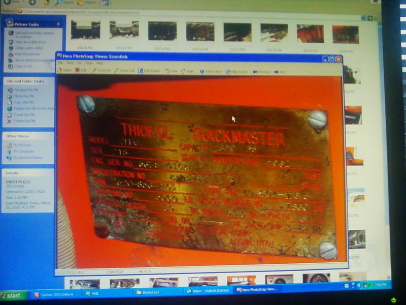

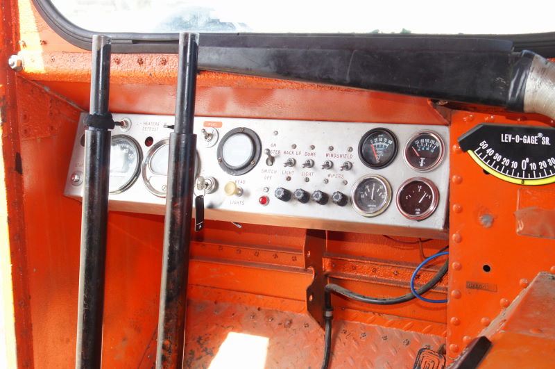

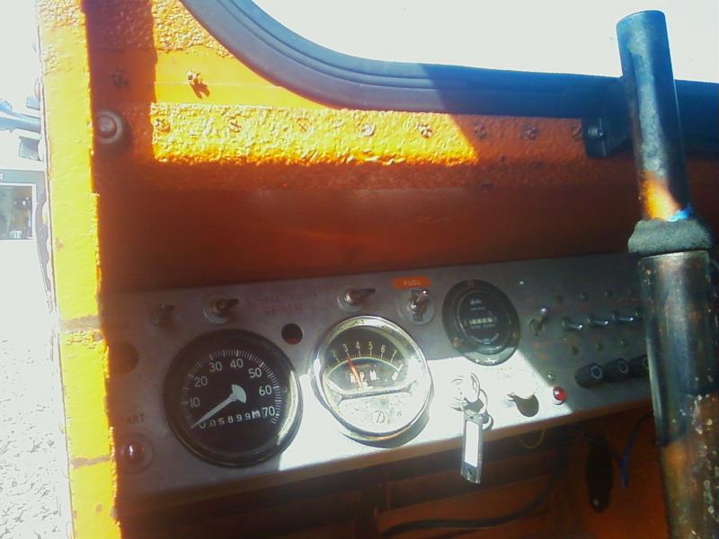

I found the ID tag in the front of the cab and it says 4t10 made in 1962. It has a c5 ford 3 speed auto trans and an oc-15 rear end. The bogey drive wheel looks like the ones on the 601. Sorry the pics are not the best.
601 or 4t10?

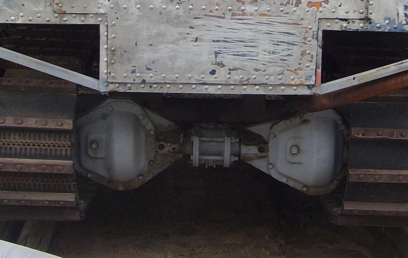

It's a 4T10, highly modified.
You see there are no axles... and hence it is not a 601.
The way the OC-15 is fitted, it shows it is not stock.
The tracks are 601. The OC-15 is obviously 601.
The transmission is neither 4T10 or 601. Sprockets are 601.
I've never seen a conversion like this. Machine itself looks to be in nice shape and the conversion looks to be quite good.... the axle-less design of the 4T10 is most likely weaker than the 601 yet gives you clearances.
Clearly a mixed bag... the most valuable piece of that conversion are the OC-15 and the tracks. If in nice condition, the OC-15 is worth about $8K (the lighter OC-12 is about $4K). The tracks are worth about $4-5K if also in similar condition...which they look from the photos.
Whadya think? Pick it up for $6K? Good you're asking questions... but buy it before someone else does as there are certainly people hunting for it as you contemplate it. It's a hybrid... it's a great conversoin... it's a stupid-good price if it's running. Your decision should be made.

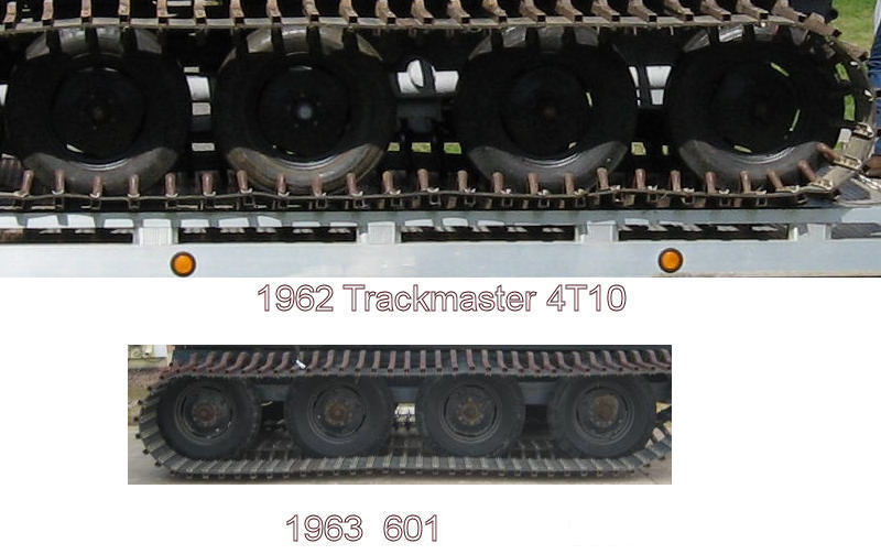

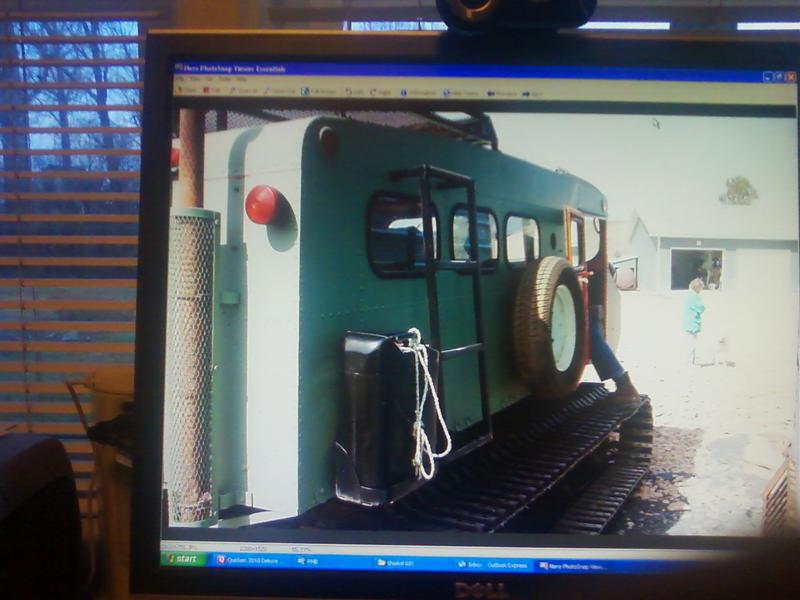

Personally, the 4T10's are often misunderstood ... like the one you have found, it's the original cab design and the predecessor to the 601 that this one is made out to be...
See the below... this was the design of what this machine was... schematic and photo of the back-end 4T. Also you will see sprocket variations between 4T's and 6's and also track style differences between 4T10 (with wheel guides) and 601.
Subtle nuances that we are all so very passionate about. 8)

ihave seen some electronic tachs jump when the power is shut off don't ask me why but i have seen both aftermarket and oem do that on certin cars.

The tach is apparently stuck at 2800. No batteries in it at present. The ignition switch was left on. Going to see if I can get it started today.

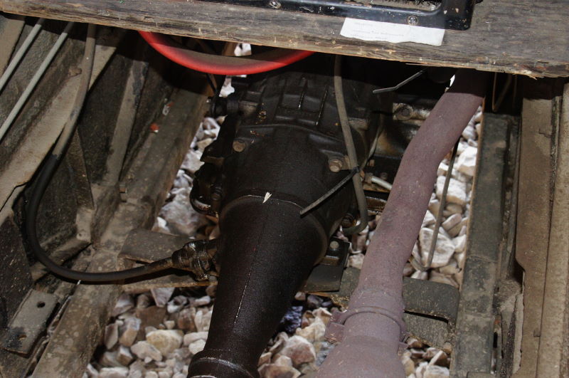

Here is a pic of the mods around the c6 auto trans. I fired it up today, ran great, and will load it on a trailer tomorrow and bring that sweet thing home. will post some more pics as I go

Although there are several 600's around with the auto tranny upgrade... this is the first ever posted photo of the guts. Keep those pics high-resolution please so we can enjoy the details! Keep 'em coming. Once you get in there, a thorough photo shoot around mounting brackets, etc. would be interesting... you should be able to tell alot based on how well some of the gear has been mounted...OC-15, tranny, etc...

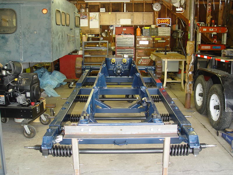

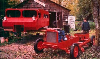

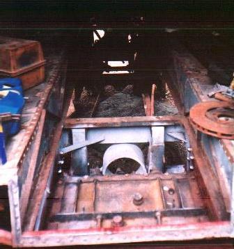

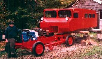

...Is there a good pic posted some where of a 4t10 with the cab removed so I can see what it looks like with out any mods. I plan on crawling under it to day to see what all was done....
Like Weatherby, I've never seen a pure untouched 4T10 tub photo... these are the closest I've seen from a forum member...diff was changed to a Bombi diff... not too high res.
I think there may be some very nice 4T10 tub photos in process from one of the forum member with a T10 in process...that will be going under the knife soon...but before it does, certainly some very hi-res photos will be taken.

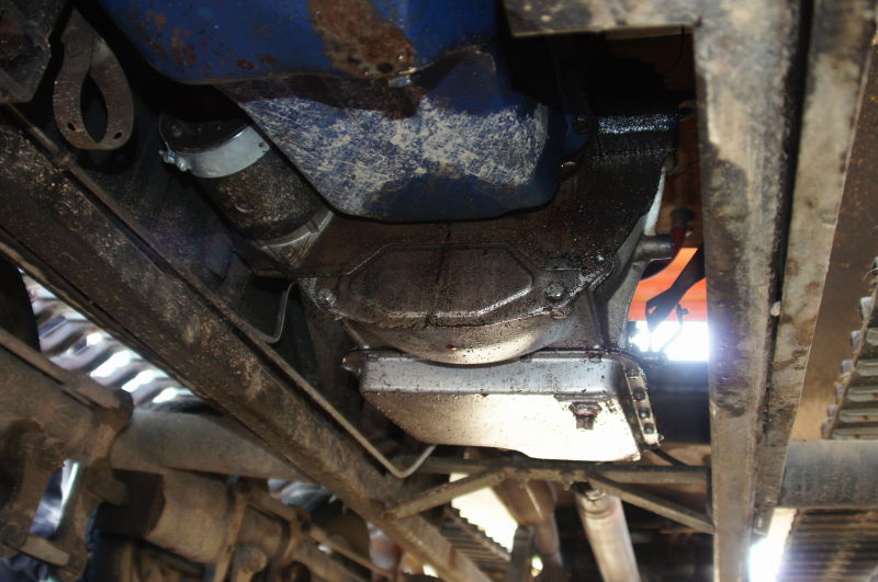

Here are smoe better pics of the mods on the 4t10.

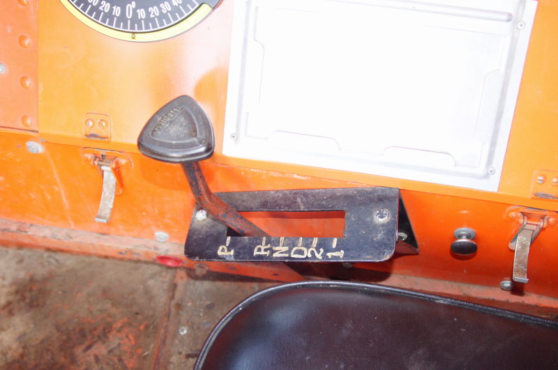

a few more pics

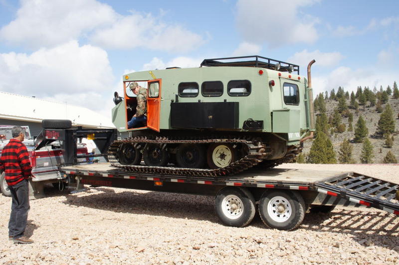

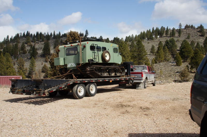

Loading up and heading home, gonna be fun

i like the drain plug mod added to the oil pan you should always change the filter to but the drain plug makes the job neet and clean
Greeeat photos! Really luv the blow-by-blow... looks like a great machine. Nice and neat and nicely accessorized. I like the color...haven't seen one this color before... I've seen a couple dark green units that were forestry units. Some Army tan, Army green, etc... but not this sage color that blends like a chameleon to the landscape. If the mods of the tranny and OC-15 were done well... properly aligned, etc... then you got a great machine & deal there!
