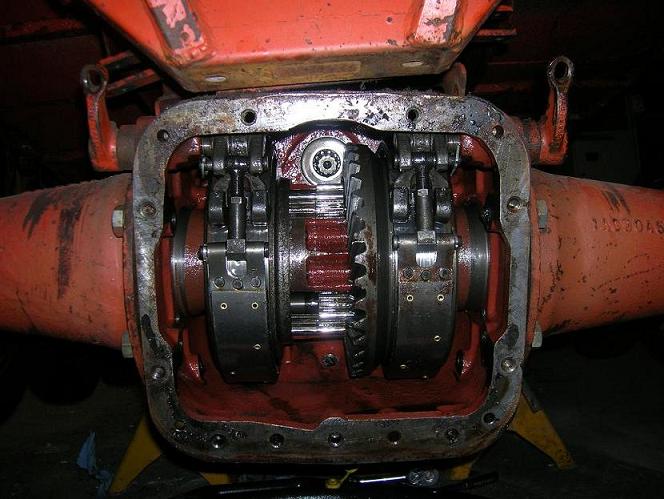

As far as the brakes go, you either have a master cylinder or slave cylinders not working or need to be filled with brake fluid, air bled out or rebuilt. The brake bands themselves adjust in the back. Here is a photo of mine when I took the rear cover off last year to check it and inspect the brake bands.

Brake bands.JPG.
