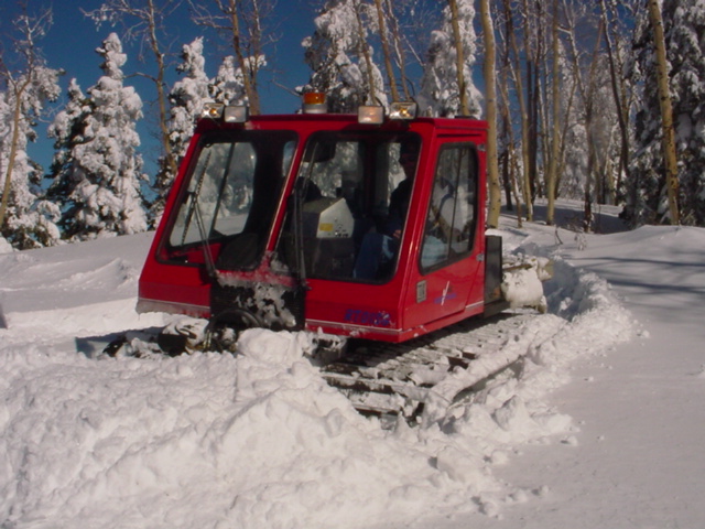

Pic Of Your Dream Machine:yum: Close huh??????
Is that a factory roll cage? That is not a "just in case" roll cage, it is a "it's going to happen sooner or later" roll cage. :cool2:
It is a factory ROPS for the 1997 VMC. The biggest problem with it is, to tilt the cab forward you must first remove bolts holding the ROPS before tilting the cab for under cab maintenance. :confused: :mad: :confused2: As for sooner or later,
As Aksnocat said, my terror threshold is lower than its tilt threshold.
:eek:

Does the roll bar really help that much ? It seems like it would just sink in the snow .Or do you only use it in the shop ??:yum: :yum:

BigAl said:
Bill,
BigAl, that is actually a rack to carry the broken down Kristi snow cats out of the woods. That ole KT7 will look like a dead animal on parade riding on the ROPS of the VMC.....:yum: Just call me Mr. mow and go guy.....:eek:
The VMC looks like the wide track version, is it? Was the snow wet and heavy? Did any other snow cats handle the same conditons any better? What models and brands? I know the underneath clearance, tire size and total height of the track to ground can make a diffference in deep snow conditons.

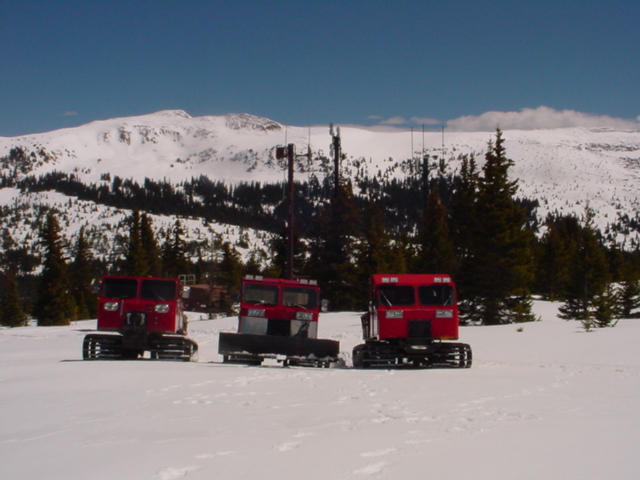

the vmc does have wide tracks it also has a cummins 4bt in it i had my 1200 there it sank in the snow about half way up the wheels it was the day after we got five feet of powder didn,t want to jump in so never got out of cat to get a picture of 1200
let me know when your comming to colo are you brinng your cat if so we will plan a outing if not maybe we can take you out for a ride Snow 016.jpg
