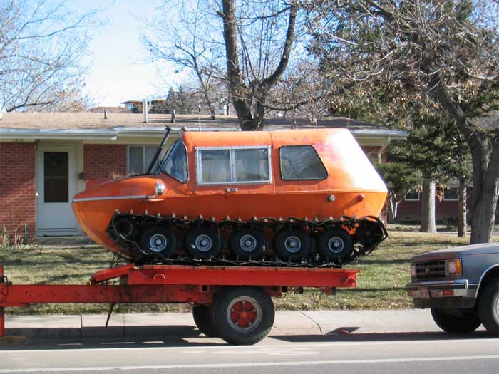

As an example, here are some photos of Kristi snowcats on a couple different types of above the wheel trailers. No visible attachement points for chains on the sides. No way that I see to contain the snowcat if there are any lateral forces on the trailer. Although the Kristi in the bottom photo is sitting on a trailer that is wide enough that you could actually secure it from the sides too, but the other trailers don't appear to offer that ability.
I know that many of the Tuckers are also narrow like my Snow Trac and can fit on a trailer similar to mine. But what about the wide track Thiokols and all the other similar wide snowcats like the Kristis in these photos?
