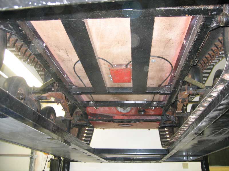

:1062:There is a steel frame chassis under the plywood floor, but it is a simple square steel tube frame. The plywood simply sits on top of the frame.
At the front of the Snow Trac, the body panel extends down under the engine to not only protect the engine, but to act as a skid plate to smooth the snow and both deflect snow under the ST and to act to raise the ST up onto the snow. Behind that panel is where the square tube chassis is exposed with the plywood sitting up above that.
I put my Snow Trac on my 4 post lift and this photo below shows the underside. It is taken from the rear looking toward the front. You can see the black steel chassis. Looking forward you can see the very bottom part the orange skid plate that curves upward toward the front bumper. (this is an old photo, before I sprayed the 2-part epoxy to protect the underside)

Thanks for the pic Bob.
For snow (the primary intent of the vehicle), that seems quite adequate.
If I was to have one of these machines, it would be used all seasons, in all terrain/conditions. With the potential of branches kicking up when driving over them or the possibility of running over saplings and such, I would probably put polyisocyanurate insulation between the steel framework (for insulation as well as noise reduction), then cover the entire belly with a sheet of steel.

Hmmm. Bob your plywood floor is different from mine. I cant figure it out yet but I know mine is different. I believe mine has cut out for the emergency brake cables? I'm not sure. I will take a look.
The red box in the floor with the two black cables coming out of it is where the emergency brake is located. That box covers the underside of the mechanism.
