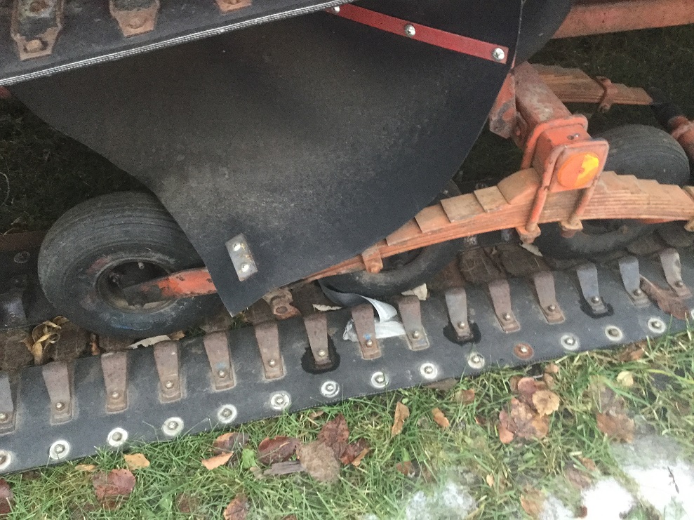

i have a few projects on my 2 cats to finish up for getting them ready for play time.
one of them is installing snow deflectors. these were on my first cat and thought to reproduce them for the machines i have now. As my shop is Vegan and no dinosaurs will be harmed in providing for my personal comfort and its -10 in my shop (out side)
I am postage this instead of working on them...... for anyone interested
they are a good idea to have help keeping the axle from snapping from over packed snow
more fun breaking them by hitting a stump....
don't ask me how i know.......:(

300 H and H
Does your machine have ice scrapers on the drive sprockets?
Add those and you can be nearly worry free, as the keep ice from building up on the drive sprockets. :thumbup:
I have both snow chutes and scrapers. At speed it is like a boat some what as you can see the snow ejected by the chutes, like a boat wake beside the machine.

300 H and H
These are original parts installed in North American fashion. Originally they mounted behind the drivers to the axle housing. Wrapped around the sprockets then up form behind. This caused a ball of ice to developed surrounding the axle housing.
By adding a angle iron to the frame you can move them out away from the sprocket and the cuttings fall in the track line.
A must I think. They were originally for the Trac Masters btw. All should have them IMHO....

300 H and H
Original scraper only scrapes the insides of the sprockets and are open in the middle.
I wish I had a detailed picture of my snow chutes to share. At the bottom I can tell you the shute bolts
to the last pair of boggies, the front one of the pair, to a stud welded on the wheel frame.
I really think they are a good idea. I am amazed at the snow I see rolling out the side of the machine in deep snow.
Reminds me of the wake a boat makes. On crusted snow you can easily see the ejected snow out side of your tracks.
It might even save a bit of power keeping the track line clean of snow as well.... ?.?.?
Makes sense it might.
I like the material you have chosen; it should work very well. Mine are old truck mudflaps lol...
