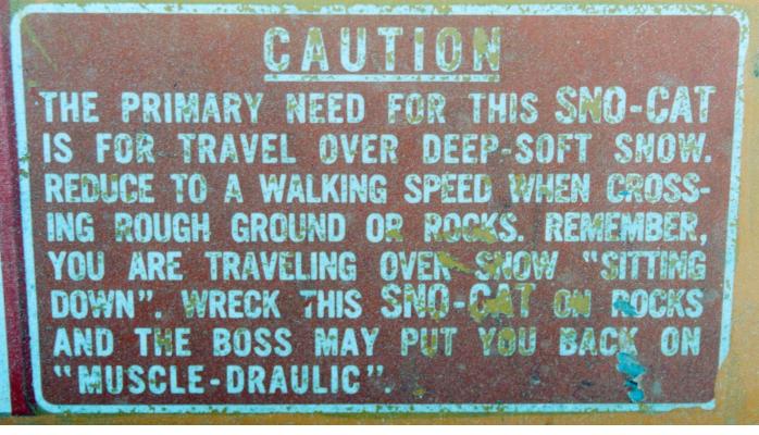

Sounds he needs one of these in the cab Dave!
That and a couple spare grousers. Actually, if he was a member of the 30GC, he would be able to fix that problem 4 times!
