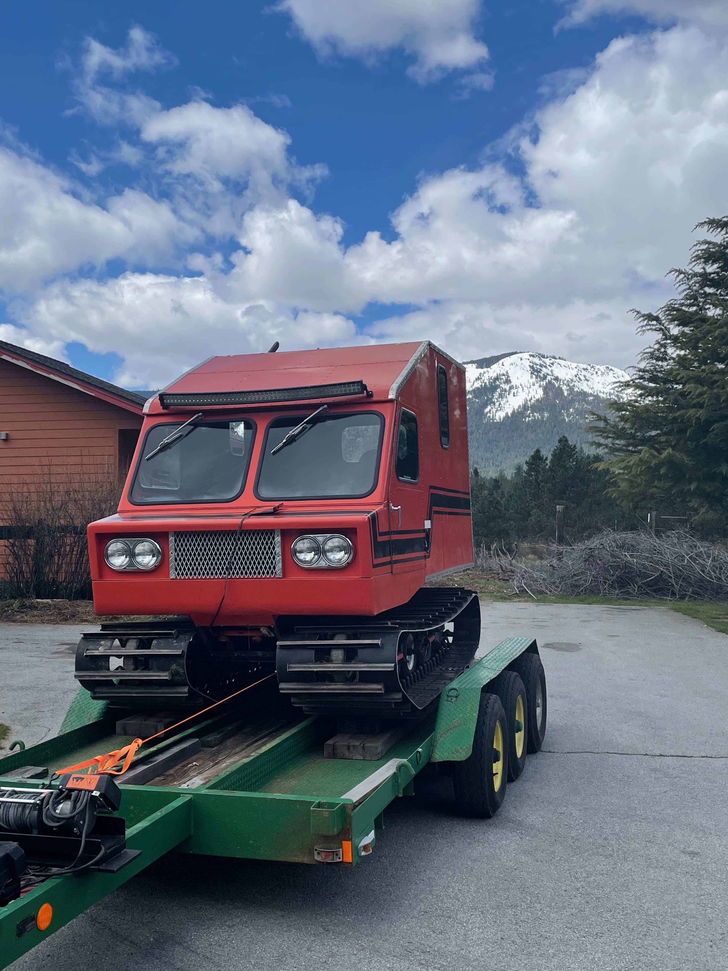

I picked her up and brought her home yesterday and there were no issues. I took her off the trailer and drove around a pasture a little. I shifted the rear end into 3rd and it goes faster than I might want to go! Good news is that it ran fine in 3rd gear and so I can see why they disabled the shifter as it was a transport for search and rescue, not used as a recreation vehicle. Took my wife for a short ride and she now realizes how brilliant I am in waiting 2 days to buy it, LOL.
I adjusted the clutch and it shifts fine now (front transmission). Before it was hard to get in and out of gears a bit. The engine temp remained constant and normal (it ran hot before I changed the water pump as it was loosing fluid) and purrs like a kitten!!
I am fortunate that the previous 2 owners missed that it had the 4 speed rear end or they would not have sold it.
You can see in the trailer photo below that I had to put two 4byes on the trailer to elevate the cat above the center of the trailer as it was 6 inches high and the OC is less than that above the ground. This did allow me to crawl under to visualize the drain plugs for the OC and note that they were hex Allen wrench and get the right size. The one for the differential was rubbed down a bit by running over things that scraped it. I will have to clean up the entry as the hex will not go in until I do that. Thus I suspect that it has not been serviced for a while, which I will certainly do soon (by driving it onto these boards to elevate it as on the trailer).

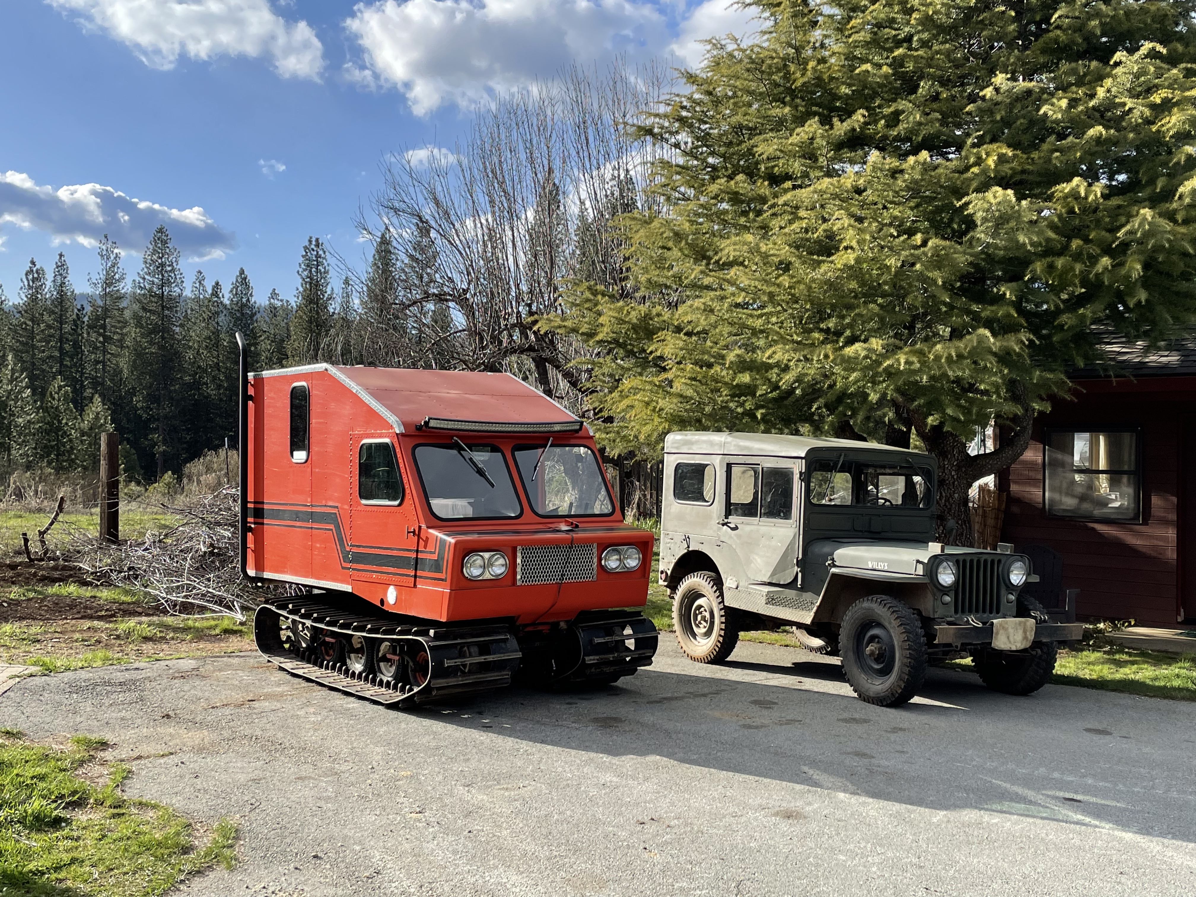

The old M38 has a new friend !!

Seller was in Mexico, LOL. He is OK with it, glad I have it, and glad I figured this stuff out (with the help from those on the Forum...)
Thanks for all the help and I'll keep things posted as I clean it up and make it mine!!
