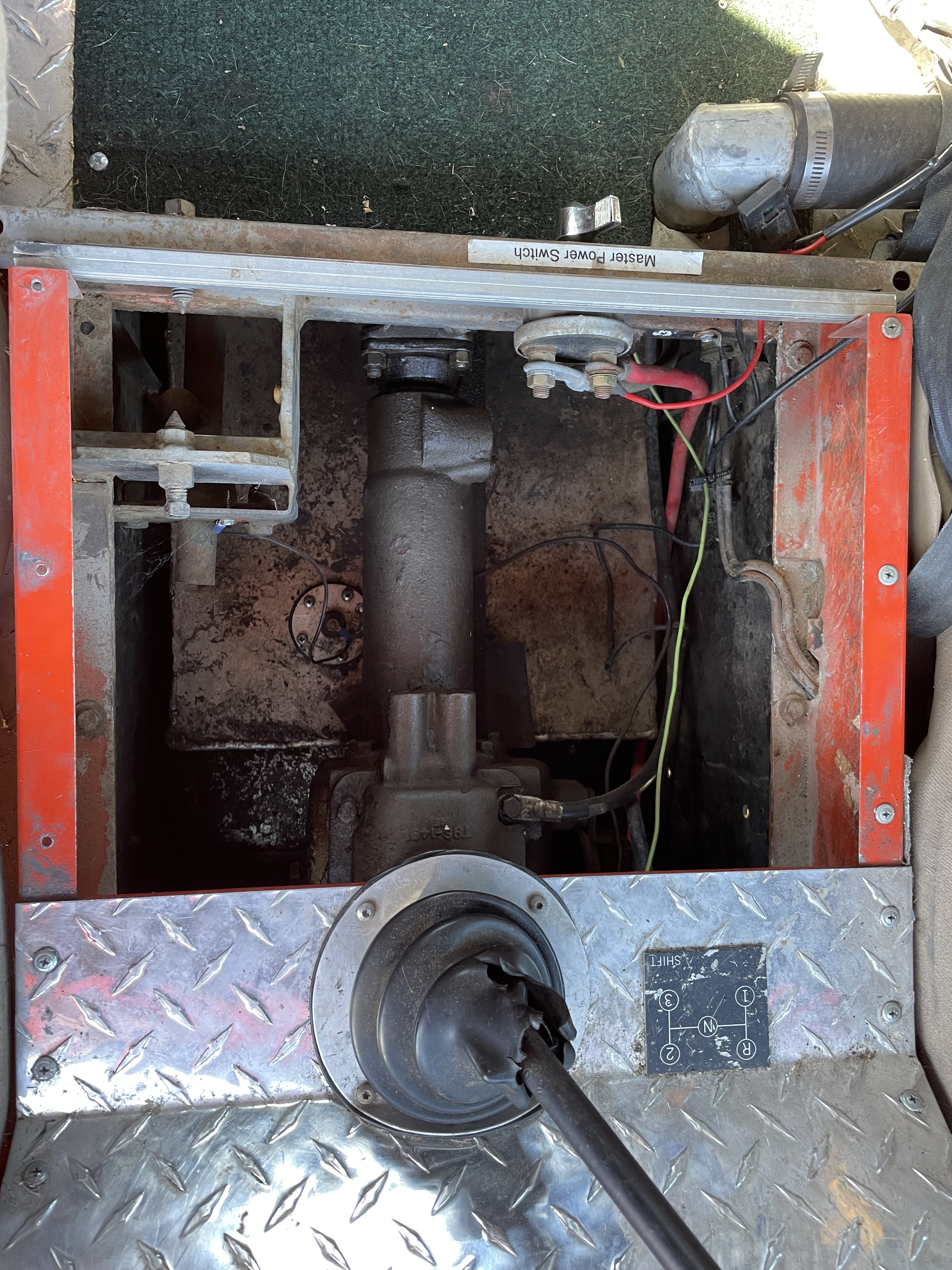

Looks like it worked so here are some more. You can see what I found and traced to the rear transmission. I can gain access to the bolts for the cover on the right (passenger) side of the OC-4 and slip the cover off to view.

In the IMG_`1361 photo, it looks like the shift rod is forward and to the left? That would be 3rd gear? Someone with experience might be able to tell...
You are in the first range if you pull it straight back you will be in the third range
1 r 2 across the front
3 _ 4 are to the back.
The odd placed screw in the cover is the alignment screw. pay attention to it When you pull your cover.
Aaaahhh Yes. I do recall the shift pattern on the OC, duh on me. I saw it, it is in the photo, and so there you are. Thanks ! The reason I got confused is in the attached pic that I got off a YouTube video on someone working on their IMP.. but it must have had a different rear end.
Redsqwrl, (and by the way, squirrels are my favorite comedians in the forest!!) What does the alignment screw do (yeah, I know it aligns something ;o). But specifically, what does it interact with on the interior of the transmission? Any advice on this would be helpful and thanks in advance..

Is it in 1st or R? If its "R", maybe the carrier got installed 180 degrees off like BoyToy's did (thread Tranny woes on 1404 Imp) and disabling the OC-4 shifting is how they addressed it. If it really is in 1st gear, I pity the previous owners.
I have found out more thanks to Nancy at Spryte Improvement. The panel that I was thinking of removing to look inside is what the shift forks are on so It is not simply, pull the plate off and look. For one, there is not enough clearance to the frame of the cat to allow removal and inspection and also, it would be difficult to impossible to make sure the forks are aligned properly when putting the plate back on.. or at least that is how it appears. Anyone the reads this that has done this, let me know please!
It is in first gear in the rear transmission, as redsqwrl noted in the shift pattern. So, you pity the previous owners but not me, Z ?? LOL. If it is in first gear and shiftable.. then yes, too bad for them and great for me. I'm still trying to get the name of the Truckee search and rescue that had it. My local contacts have not gotten back to me on this.. so maybe I will just call around Truckee to find out contact info and do the search on my own (likely the thing to do).

SHIFT IT MANUALLY FROM THE BACK!
the suspense is killing me. Z spryte is 100% onto something that is very common amongst OC4 operators...... for the love of god, move that shifter at the rear...... in 2 minutes you will know the data necessary for the us cheer leaders to cheer for you.
and yes that screw aligns your shift forks. don't take that cover off until you feel you need to, as opposed to want to. imps are hands down the most versatile cats ever created 90% of the problems are created by the operator.

Another thought here, if you haven’t already, drain the lube from the rear end and use your camera to see what side the ring gear is on. You may have a case of the backwards ring gear. Seriously though, in my previous post, I lined out jacking up the machine or removing tracks and manually shifting per Red Squirrel, and hand rotating drive shaft to see what you have going on. If you have a borescope or have a gastroenterologist for a friend, stick a camera through the drain. I think there are some fairly easy steps you can take to diagnose your issue.
I don't know why I did not think of that, Idaho IMP. My dad was a General Surgeon and I have his scope (I've offered, over the years, free colonoscopy's to my friends but (pun intended) no one took me up on it....) Actually, I have a perioscope for endoscopic periodontics that has a 8x10 computer screen and a strong light at the end of the camera fiber that would work perfectly (with a protective disposable sheath so tractor fluids don't contaminate the sensitive camera fiber). Duh (which happens to me now and then...). Thank you for nudging me out of the weeds on this one!!
