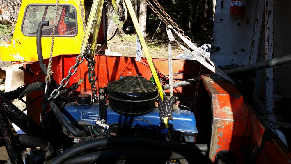

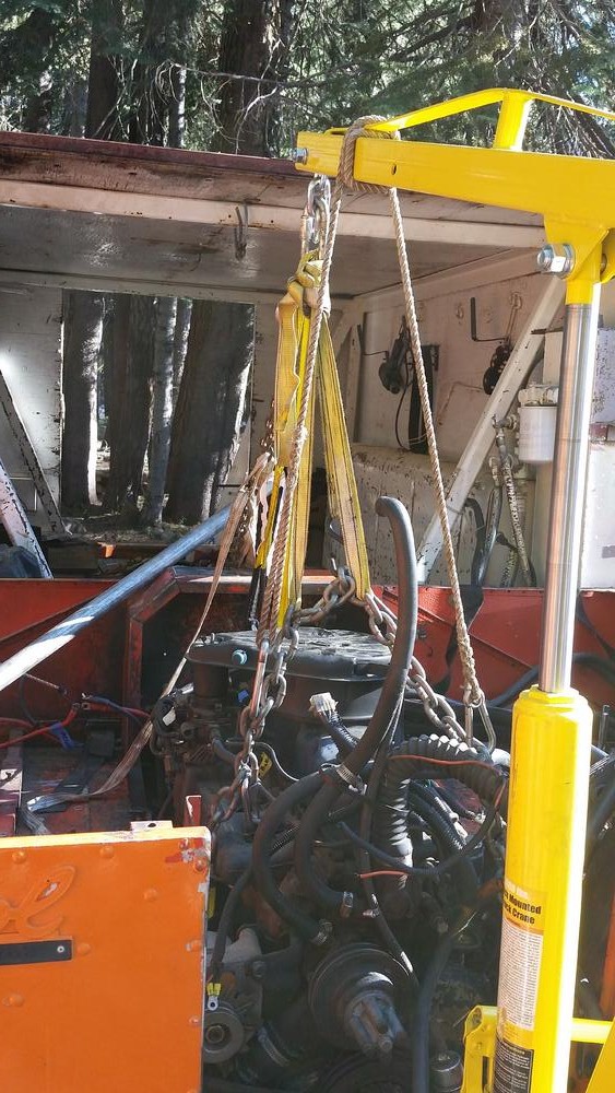

Chains, slings, ratchets...Whatever. That engine + Transmission is stuck
Will the crane break? What is the total weight engine + transmission?
Scary moments....

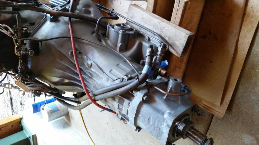

I did! In the process of repairing the engine + transmission and few other things (I mean a lot of other things).
Success -
Looks like you have a few leaks on/in your oil pan. Good time to address them! I am lucky compared to you. I just have to get my slave cylinders rebuilt. After 50 years of service, it was their time.

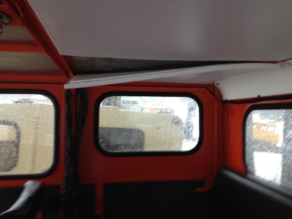

I am desperately looking for weatherstripping tape, the rubber coated fabric found between the cab and the frame and between the gas tank and its steel cover. Out of luck. Anybody can recommend something?
Also looking for foam insulation to glue in the cab: panels, roof. Any ideas / suppliers you would recommend?
Thank you,
JB

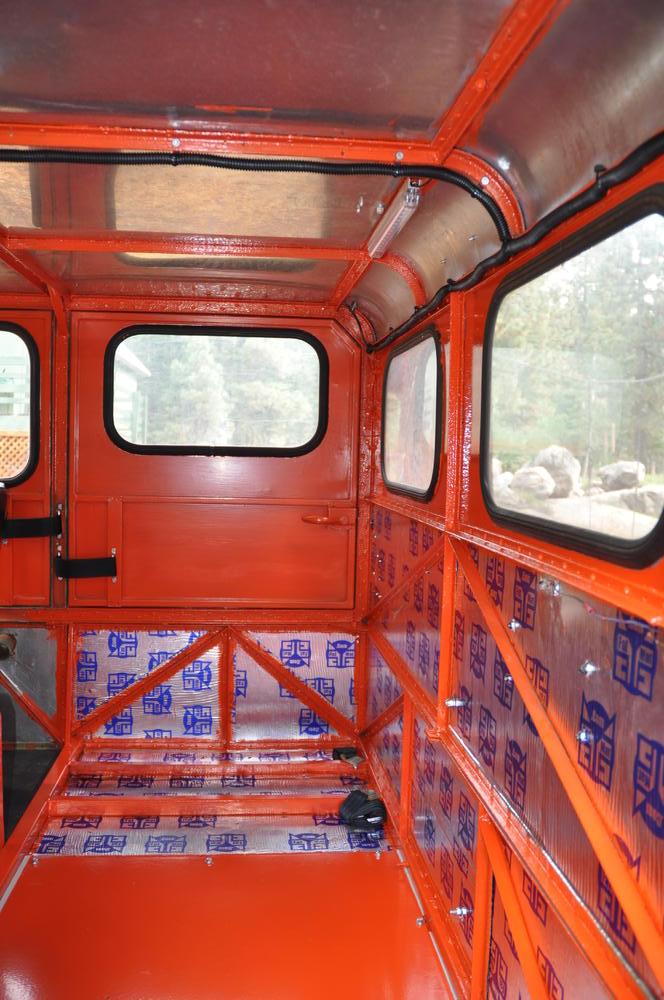

I used 1 inch thick polyethylene closed cell foam (2 lb cross linked). Polyethylene does not absorb water - plus it is closed cell. I bought white foam for the ceiling, but found out it yellows after a while so I put marine grade upholstery it before I installed it. To attach the upholstery to the foam and the foam to the cab, I used 3m super 90 spray adhesive. I used a router to cut a step around the edges of the foam on the side facing the aluminum skin. This made it lie flat on the supports and gave me a place to tuck the upholstery fabric into. On the doors and bottom sides, I got black foam and did not put upholstery on it. Around the bottom portion of the cabin I put in a Mylar coated sound deadening material on first and the foam on top of it. The foam on the ceiling has eliminated the tropical rains (condensation) I used to get during winter inside the cab. If you can pick the panels up, you will save $. The stuff comes in big sheets - 4'x6' and is pricey so look around. There is a company called "Foam Factory". It has multiple names and the price varies depending upon which web link you use. You might find it cheaper closer by.

c) I used 1 inch thick polyethylene closed cell foam (2 lb cross linked). Polyethylene does not absorb water - plus it is closed cell. I bought white foam for the ceiling, but found out it yellows after a while so I put marine grade upholstery it before I installed it. To attach the upholstery to the foam and the foam to the cab, I used 3m super 90 spray adhesive. I used a router to cut a step around the edges of the foam on the side facing the aluminum skin. This made it lie flat on the supports and gave me a place to tuck the upholstery fabric into. On the doors and bottom sides, I got black foam and did not put upholstery on it. Around the bottom portion of the cabin I put in a Mylar coated sound deadening material on first and the foam on top of it. The foam on the ceiling has eliminated the tropical rains (condensation) I used to get during winter inside the cab. If you can pick the panels up, you will save $. The stuff comes in big sheets - 4'x6' and is pricey so look around. There is a company called "Foam Factory". It has multiple names and the price varies depending upon which web link you use. You might find it cheaper closer by.

Thank you Nikos!
I still can't figure out how to rotate the photos, and the website crashed several times as I was trying to upload the photos.
Great crossing your tracks this weekend. You definitely bought yourself a project cat.
The Mylar backed sound deadening stuff I used under the foam is called FatMat - www.fatmat.com
