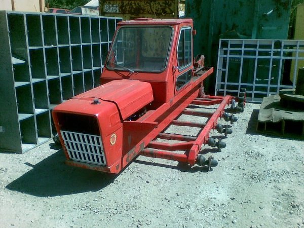

I was very lucky on last Friday receiving a call from a friend. He told he's standing next to a Ratrac snowcat that can be bought very cheaply. It has wide tracks which I could be interested of.
<snip>
Looks like the Ratrac version of a Thiokol 2100.
The sheetmetal forward of the cab looks almost exactly like that of a Ford model 3000 farm tractor from the late sixties/seventies.
It looks like you got a steal!

The spare snowcat (which looks like Thiokol 2100) is now disassembled to a state where I have to choose whether I rather build the Sprite on its chassis or move the stronger axle (OC12) and gearbox from 2100 to Sprite. The difference between the chassis is only about 1-2", but in the 2100 its in much better condition. Anyway, the outcome will be wide-track version :)

I'm going to rebuild the Sprite on the spare Ratrac ST -chassis I bought/showed previously. Unfortunately I have changed my photo storage provider so all the previous photos have vanished... Too bad it makes this thread look really bad, sorry about that.
On the spare chassis I will build a new body, due the dimensions of the Ratrac ST the "new" Sprite will be 22" longer, making it a total of 161,5" long. The new aluminium tracks from Ratrac ST are much wider than the originals, 57" per each, this will give a total width of 135,8" for the vehicle.

Here are some photos showing what the tracks look like and the new basis for the Sprite (I loaned the photos from www.pistenraupe.de - an excellent website, please visit for more photos!):

So finally I moved the spare Ratrac chassis in the garage - now this will be the chassis for the "hybrid". Unfortunately my plans with the Ford 7.3 Diesel went downhill since firstly it was way too big (that radiator is huge!) and secondly someone came and offered me good money for it... So, I´m going to keep the in-line six.

As the Ratrac is now in the garage (and not waiting outside "when I have time"), I decided to start the disassembly... Before:
The parts on front are not for this project..
After...:
This thing will need a total rebuild. I can see lots of shoddy field repairs... The basic metal is still in very good condition, if dirty.. but not rusty.
