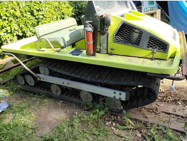

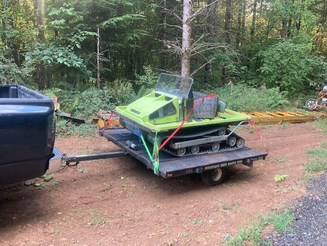

Well, We picked it up.
It was a long drive, but relatively without incident. The old sled trailer looks like it will be the home for this little project at this point.
My son and I will be rebuilding it as a team, (first real interest in a project so I am absolutely supporting this!) We decided to leave the original motor in it for now, and see how it works, while I get the big 4 stroke ready to go.

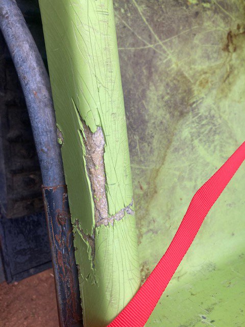

The body needs some serious repair, so will be glassing it. Any pointers would be greatly appreciated!
It gets a winch on the front, a plastic gas tank, and new wiring etc.
If anyone knows how to get some new tracks, or if anyone has tried making them?
I saw one video where a guy used snowmobile tracks, but then he had to replace the entire side pod on both sides. Can't imagine that was cost effective for my purposes.

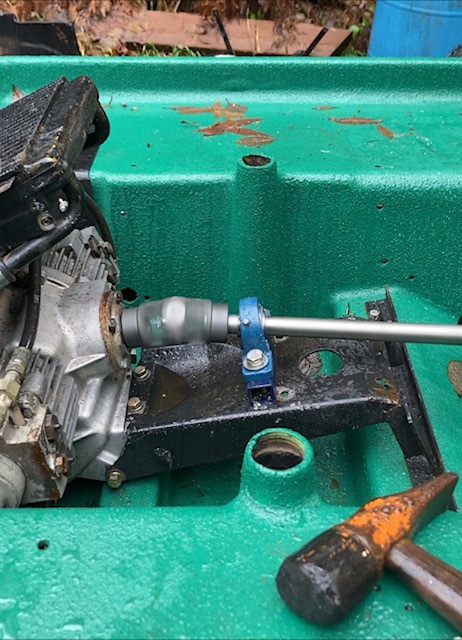

So. I know this will upset the purists, but so far, everything about this little tub-cat has been worn out. Completely. So, I am going to a rear-mount setup, with twin 18hp motors running in parallel. I know, everything on the internet says don't. But it's really not a lot different than a twin cylinder. The old motor does not run, does not make any sense to me, (not a 2 stroke guy) and is for sale. The ignition timing cam is broken because I am an idiot, but my new motors are here so I don't care. lol
I want to run a 1" shaft from the back on pillow blocks, but it appears I can't level out the transmission, so I will need to run some sort of joint. Has anyone seen a CV joint without splines? I can splice a splines piece onto the shaft, but that seems like something that will take some careful balancing... it will be turning 5700 rpm between my legs. I plan on putting a schedule 80 PVC tube around it like a driveline tunnel, but maybe I should put a couple metal crossmembers above it just in case.

I read in the manual the stock 2 stroke runs at 6k rpm. Obviously a Briggs style motor won't do that, so I figure I have to gear it up at one end or another... Just gearing the axles up won't run the pump at optimal speed to build pressure, so it will lose more to heat loss and friction. Maybe I am way off, but I think of it kinda like a torque converter, in that once stall is achieved, it's a way more efficient machine.
Then again, I am newish to hydrostatic specifics.
Does your driveline run along the bottom of the tub or closer to the top?
If I gear it up at the front end, the whole shaft could be lower, but that's another belt to break.
Is your build on youtube or anything?
Alright! For everyone who was waiting with baited breath for an update.... It works! Ok, really the only thing I have tested is the hydrostatic transmission, but it's what I was worried about. That engine is a Chinese clone 18hp, and I want to get the whole thing built before I add the second engine. Tuning is obviously going to be a huge issue, but I am really excited to have dual drive. And yes. I am well aware that running two motors to one shaft is not recommended, (It's literally the image that came up when I initially googled the idea,) but I like the concept for two reasons: First, a two cylinder motor will not get you out of the woods if one cylinder blows up, and with this system, I can switch all power to one motor and get out at half power. Also, these motors were cheap. Like $350 each. To see if the thing even works, I didn't want to spend the 3500 on a 35 hp motor. And, the separation lets me lower and balance the weight. Am I a little concerned about a 6000 rpm stainless shaft between my legs? Absolutely. Do I like the hum it makes when I wind it up? Um... Also yes.
