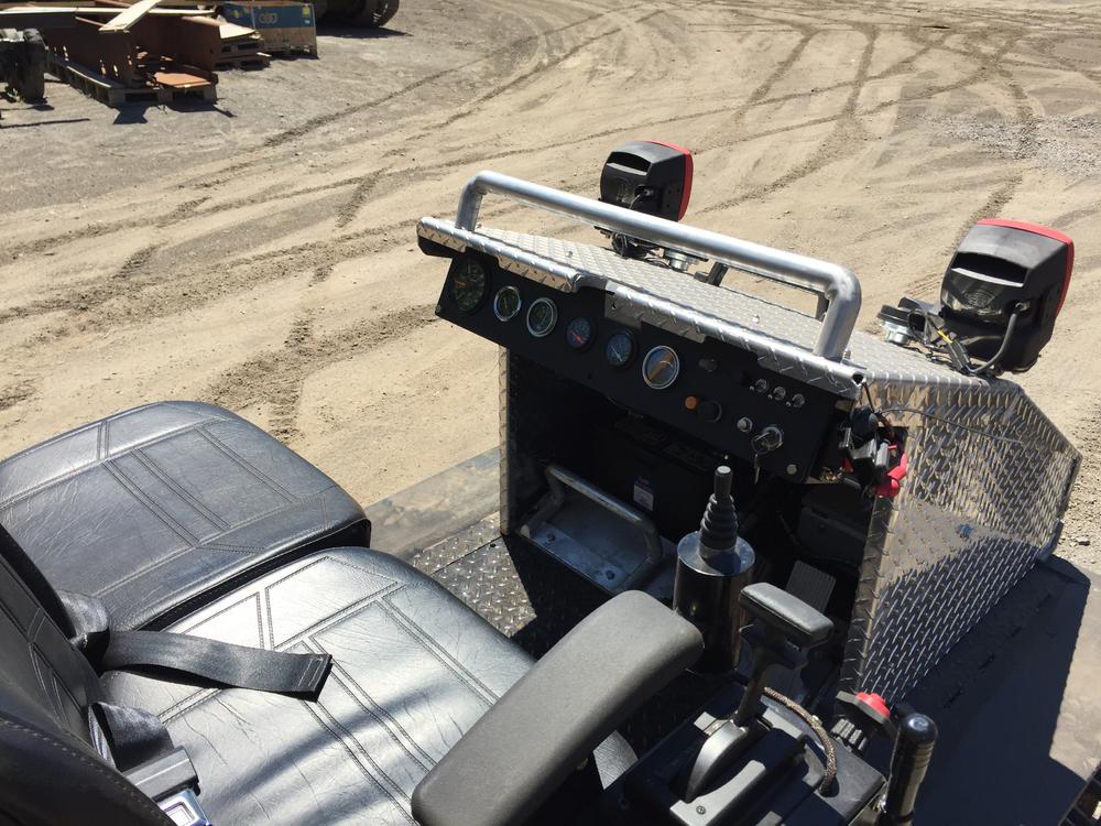

We had a need for non hydro mechanical drive small firefighter so we contracted a Canadian Company to build one. first one almost complete,to be used for wildland fire fighting.
86hp Perkins diesel
Allison 545
New differential using the T16
Basic Bombardier sprockets,tires,tracks
Joystick steering
Two seats
Stainless steel tanks
Picture is not complete, it was during testing full roll cage will be fitted tanks not on etc.

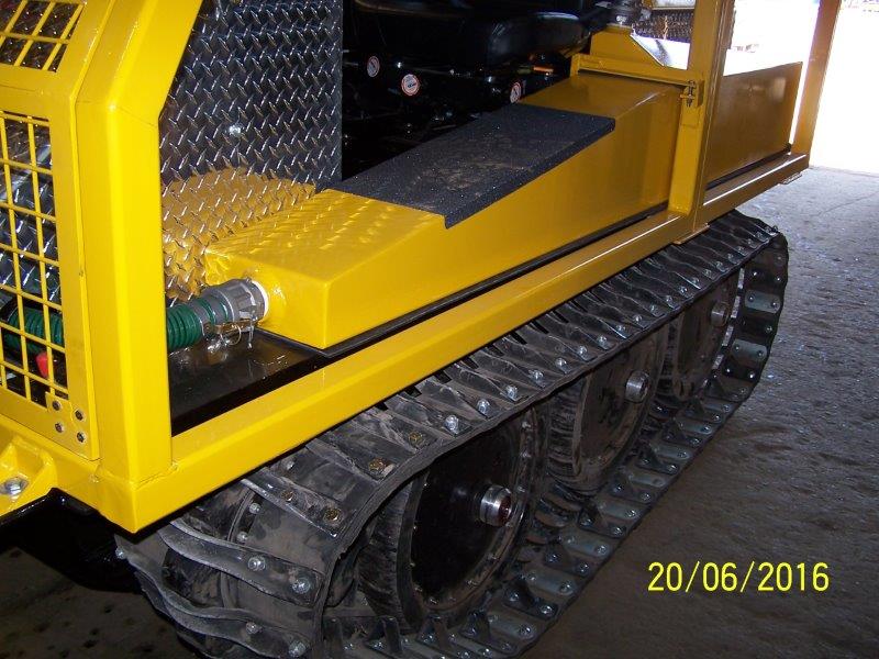

Ready to start plumping the fire pump to the tanks a manifold will be placed in the bottom of the tub area as a sump area to be the lowest point for all angles it also adds a little water capacity

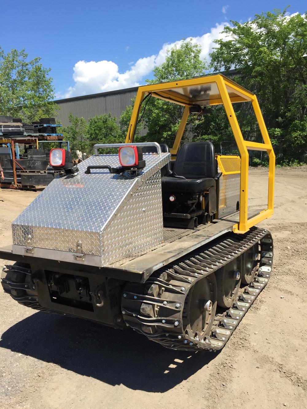

Picture, built a basket for the extra hoses and suction hose for drafting, nozzles
Etc. still needs two fire shelters and fire extinguishers to be supplied by customer
