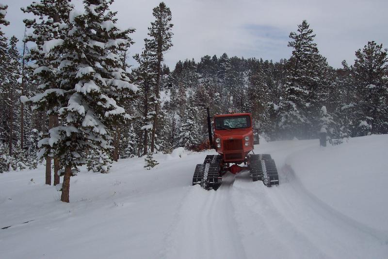

That's the rig, crappy photo but that's it.

Had it out about 3 weeks ago to burn some slash piles.
