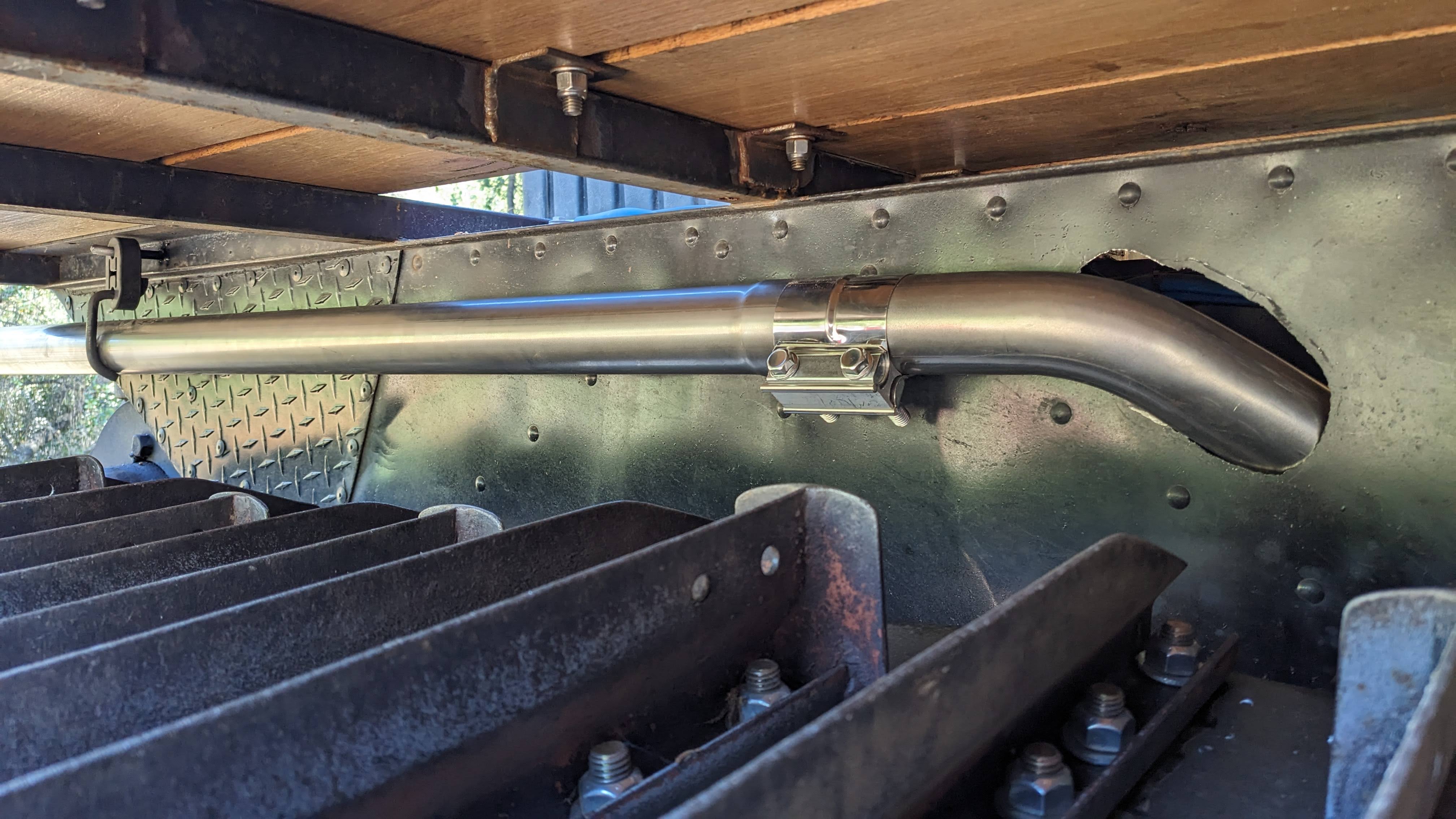

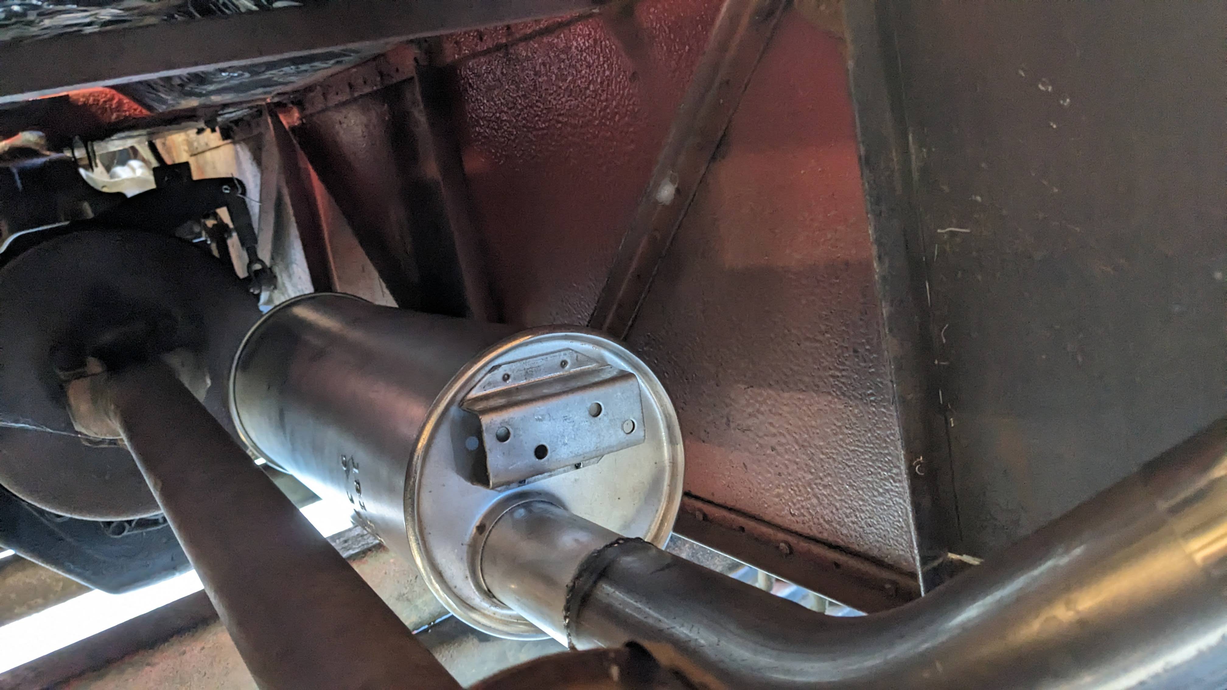

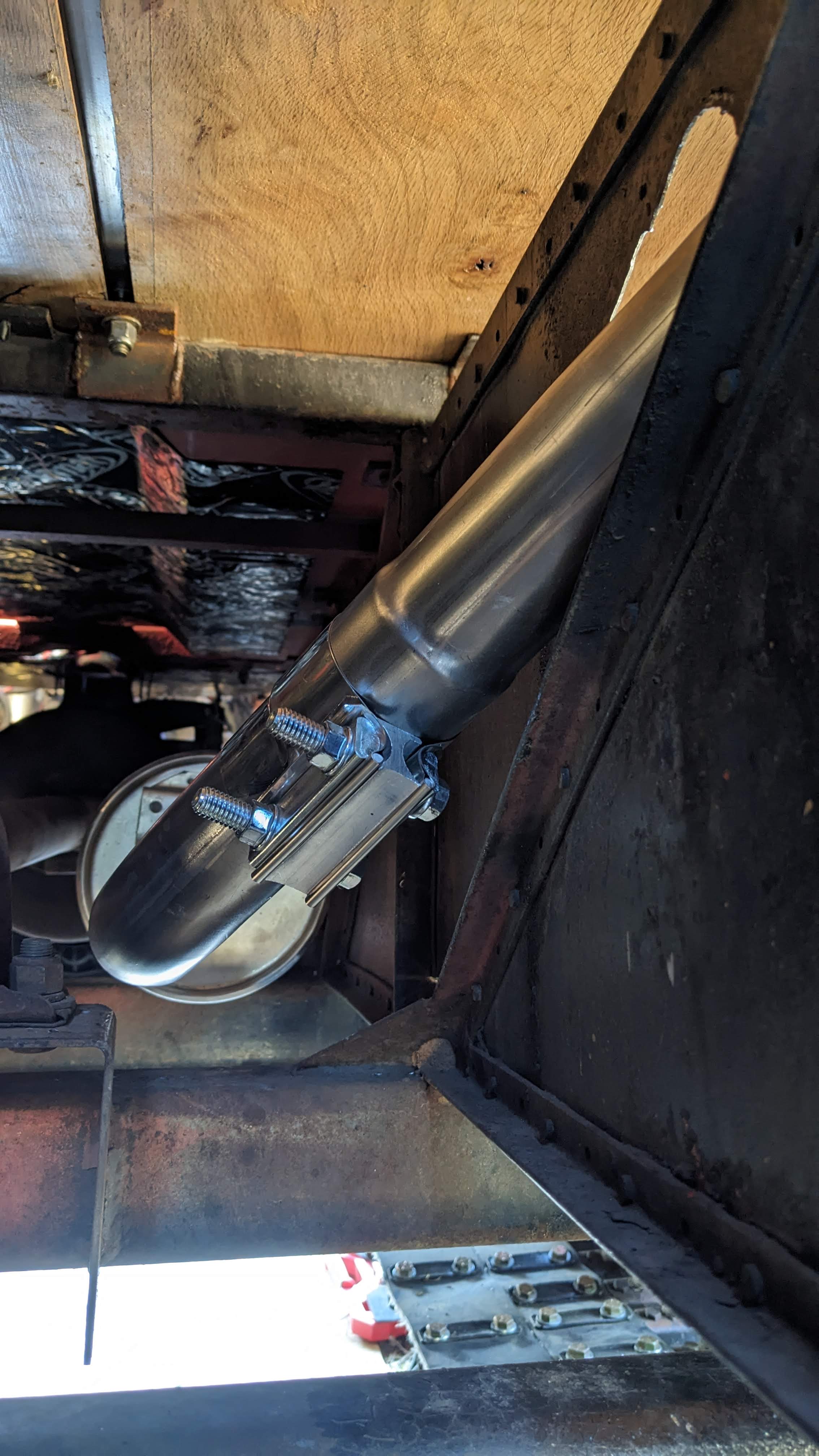

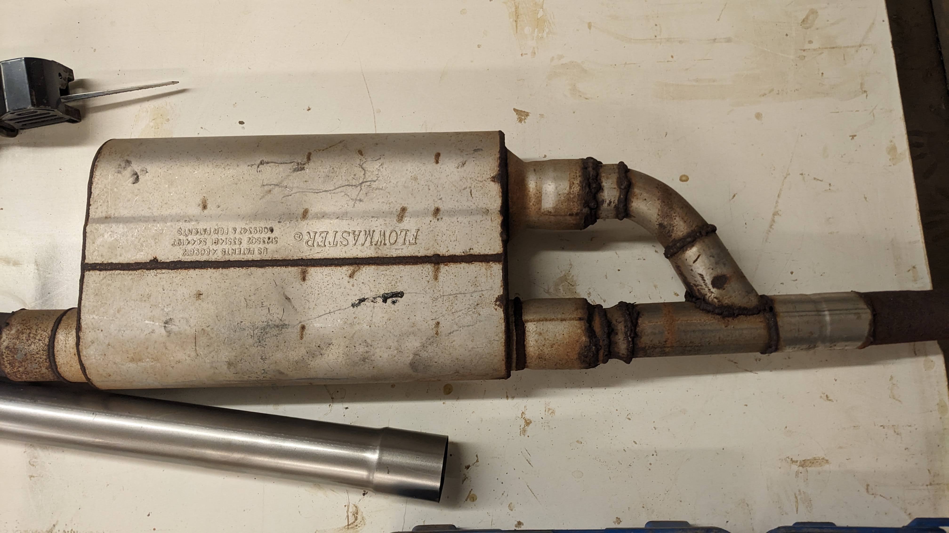

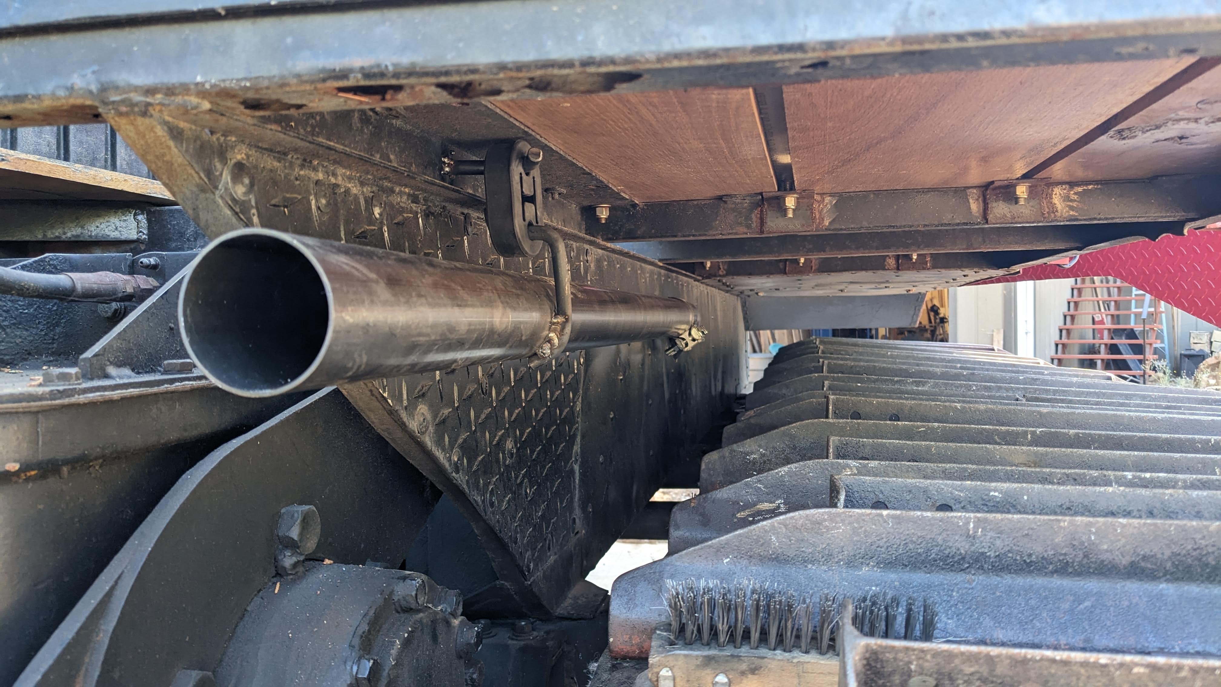

Thought I'd come back with an update not he change out. I ordered a set of pipes that were pre-bent as a start. Once I got he sizes figured out and ordered the correct clamps (band style) I set off to work not he exhaust system. I decided not to pull the engine to replace the gasket to the head and settled on the doughnut on the down pipe. I cut the pipe jut front of the muffler and pulled the remainder out. Puzzled on hoe to run the exhaust out beyond the back of the cat, I reached out to Pat at sprite improvement for suggestions. Following his idea, I set out to finally get the job done. I think the pictures tell thee story on how I ran the pipe. the result looks clean but not quite as quiet as I had hoped but I'll live with it. The old can and pipe had little holes in it and I did not care of the one in and two out set up that was installed.
