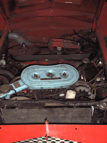

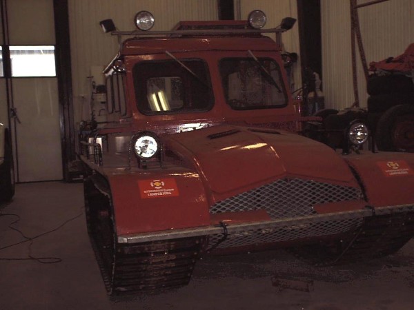

This Snow Trac have Subaru engine and gearbox high and low top speed 60 kmh

The gearbox is from Subaru with 4 speed and high and low total 8 gears.The variators is mixed on the Subaru gearbox .

What kind of automotive gearbox has a dual range high and low? Are you saying it has 4 speeds forward in high range, plus 4 speeds forward in low? If so, that would sure be a nice transmission to have on varied ground.
Can we see a couple photos of the inside, particularly the gear shift, shift pattern, and the range selector? :weneedpic

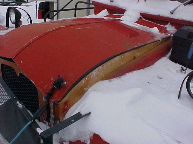

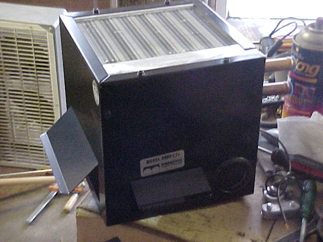

I like the looks of the subaru swap, but would like to know more about the gear box set-up.I used the toyota in my rig because that is what i had laying around at the time i got the wild hair up my [trac rig]I got the trans adapter from Kennedy Engineering,I had to put front motor mounts in and raise the hood up about five inches,but I am real happy with the end results.I think that the subaru would be a easer swap .it is a lower profile and looks like it fits real good .If you can let us know more about the subaru trans- variator mix .that would be real nice!I like your swap beter than mine.
Re: Moter swap ?
Larry,
How about some photos of your Toyota/Snow Trac with the hood closed so we can see how you raised the hood? Also how did you set up the cabin heat?
I do like the more compact Subaru installation, and I am very curious about the speed obtained with the Subaru gearbox. I'd love to see/hear a lot more detail about that install. I think 60kph is roughly 35+mph. That seems pretty darn fast in a machine that has rubber belts for tracks, but also would probably be a blast to drive on an open field of fresh snow.

This Snow Trac is number 748 made in 1966. Subaru engine and Subaru gearbox it is for sale $ 3.801 in Iceland !!!

This is the box heater i used,mounted it on the pass-side floor boards,I hope you can tell by the pic. how I raised the hood.I sure hope Villi tells us more on the Subaru trans.
