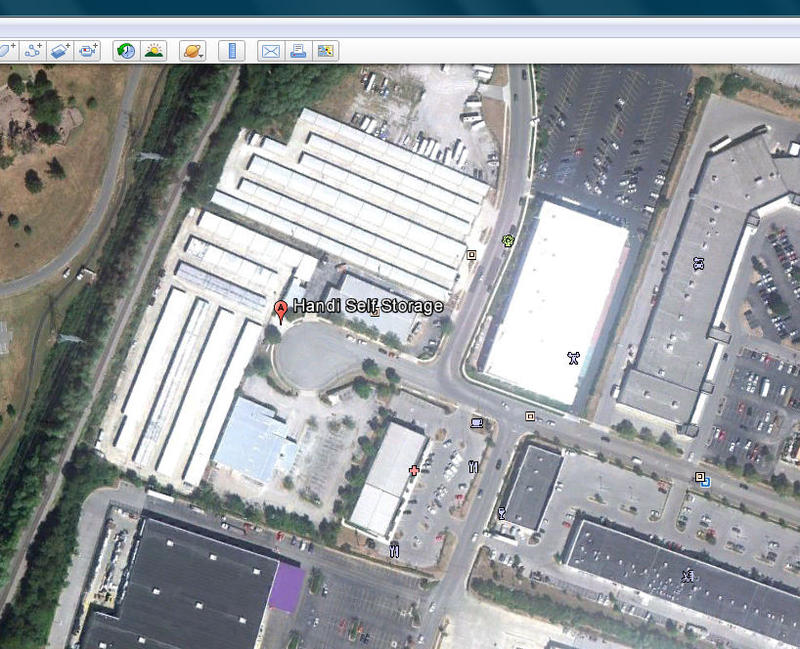

I have a 455 unit self storage facility now in Lexington. I was also the trainer for Public Storage for about 7 years followed by 5 years with Extra Space Storage both in South Florida. Drop me a PM or Email about what you want to know and I'll help as much as I can. Oh and our property takes up 2.9 acres and is show below in the picture.
Oh and I forgot to add it is a positive cash flow business as long as you keep them rented. Now without knowing the actual size you have it is hard to say how many and how large. I would do more of the 10x10 than the 10x20 in most places but again it depends on who the renters would be. 10x10 are large enough to store a 3 bedroom home if packed right and a 10x20 is a minimum to store the average car. As for climate control again it depends on how cold it gets and what is store. It snows here and we have no climate controlled unit but did have about 50% in Florida.
