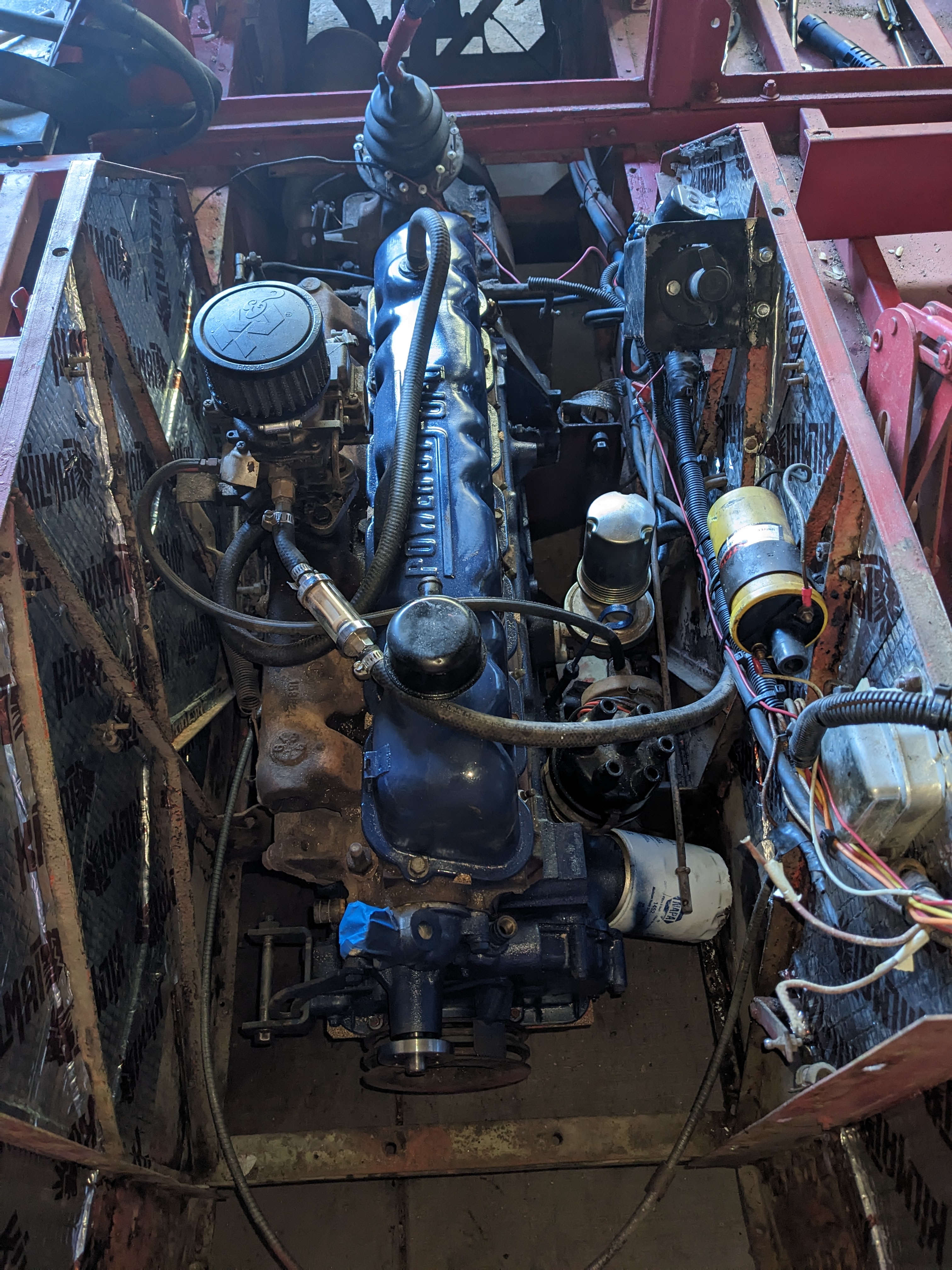

Things done:
oil pan dents mostly pulled out
found a new ring gear for the flywheel and did the freeze / heat to get the new one on
reassembled the motor and painted it, Ford Blue (of course I used "old Ford Blue")
While the motor was out, I opted to use "KilMat" for the inside of the bay.

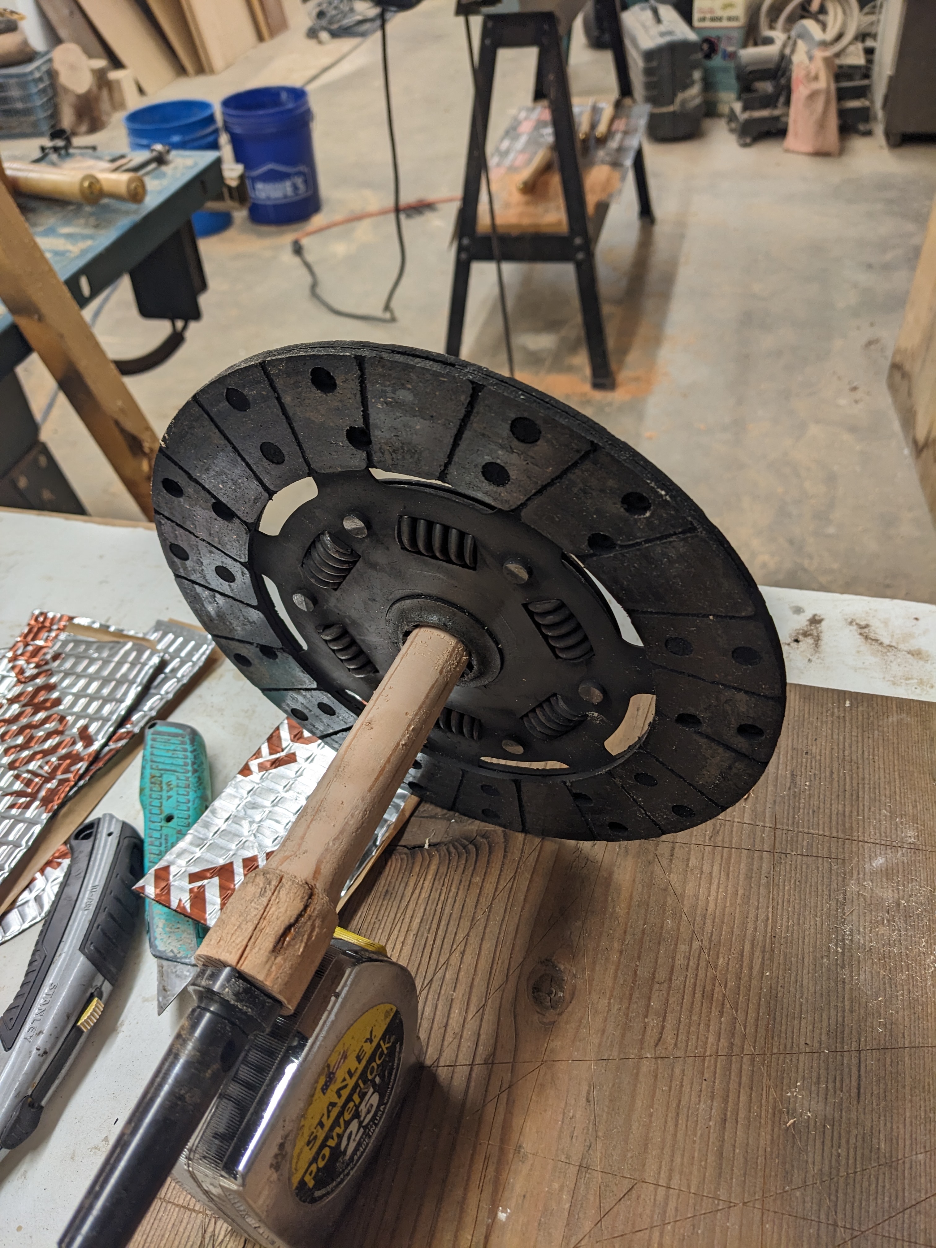

Today I had no interest in driving to town for the locator tool used to center the clutch plate and pressure plate so I decided to make one on the lathe. Looks like it will work just fine. Nice and snug fit on both the busing and the clutch plate.

With the motor all buttoned up, I set out today to at least get the motor back into the cat where it belongs. What a long day it was! Ran into several snags being such a tight fit, especially doing this solo. An extra set of hands and eyes is greatly recommended. Spent a lot of time looking for the right nut or bolt. In fact one set that holds the clutch slave (?) cylinder to the mount took a lot of time to find. So much time I gave up and moved on.
While putting the pillow block in for the driveline, I noticed a little pink thing poking out a drain hole in the battery box mounted under the bed. It moved! Mouse time...
I won't describe how I chased him around along the frame rail and such but I think he is now vacated the premises. One good thing came form chasing the mouse around was that I found the "lost" nuts and bolts for the clutch!

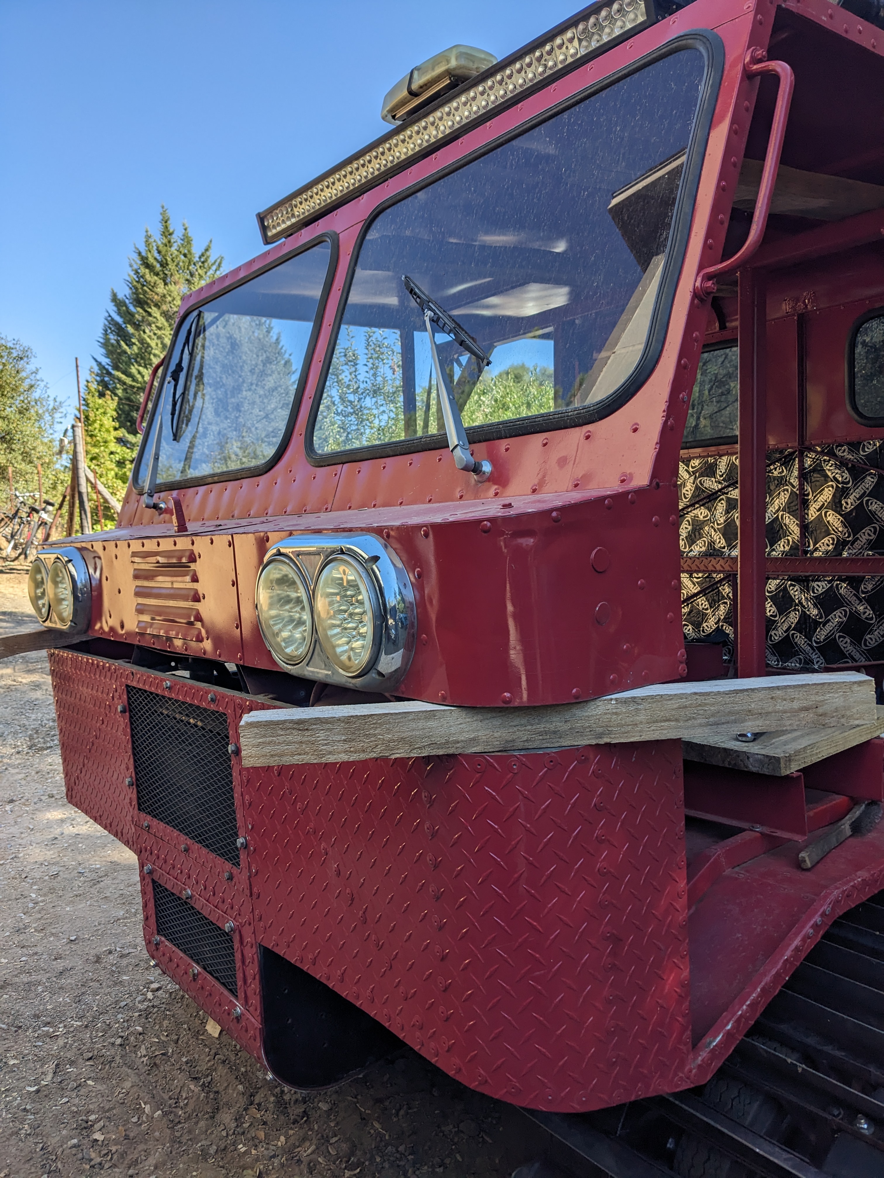

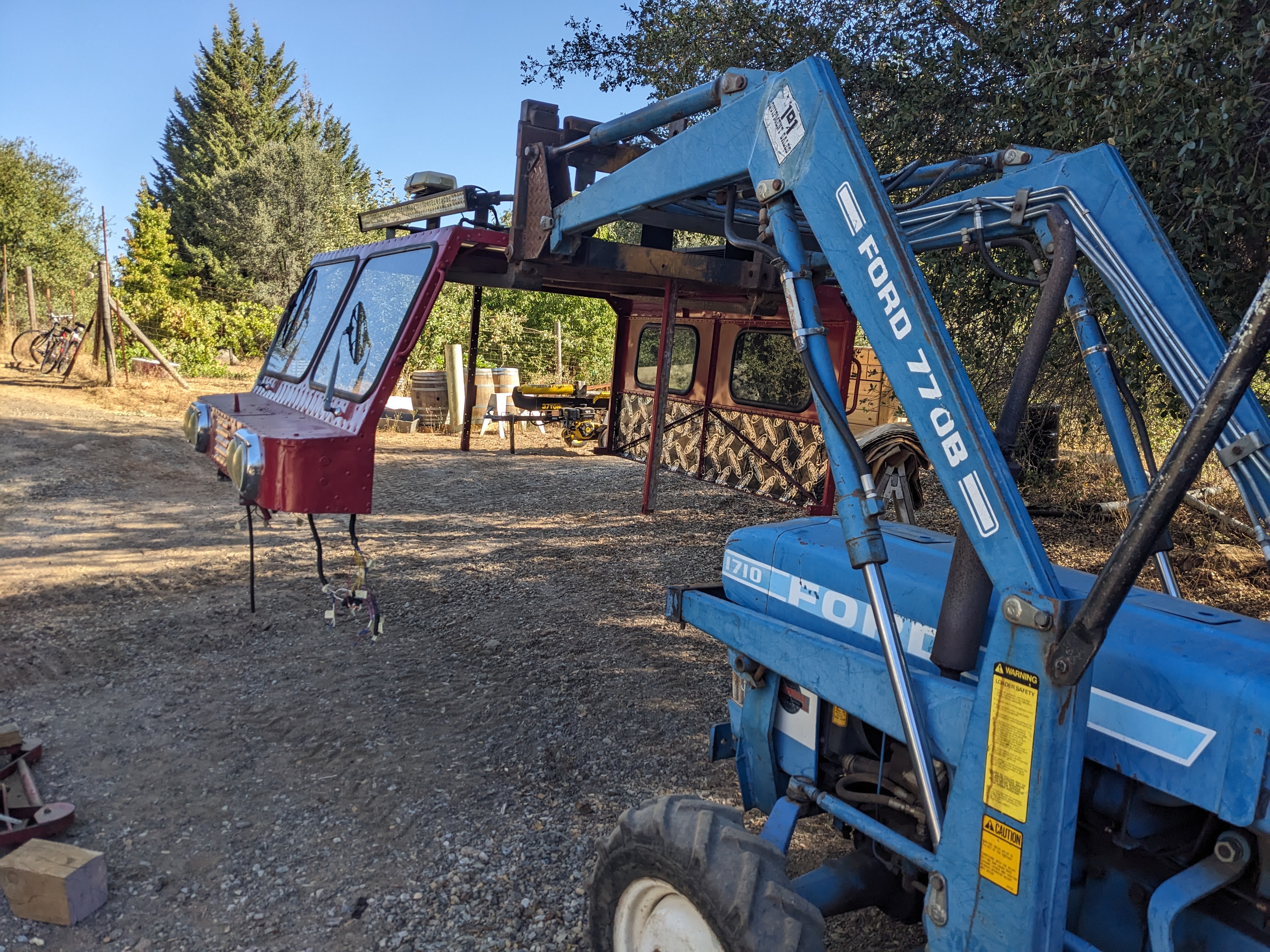

Big day for me. I set out to put the cab back in its rightful place. I think it went smooth. Not saying there weren't some hiccups along the way, but I got the top on. Now I need to schedule some time to get the wires reconnected. I did find one spring left over.... I did a quick look at the manual as I do not remember where it went. Best I can tell is it belongs on the clutch. Just did not have the energy / motivation to get on the creeper to investigate. The only other issue has to do with the parking brake, Not sure if this is the original cable or not but it pulled through the bracket down at the drum. Have to think about this one for a bit.
ra
Using the tractor to load the cab.
Used lumber to hold the cab proud of the base so I could put some sealant before setting the cab all the way down. Also helped allow for aligning the bolts.
Butyl tape. I opted to use this as the prior stuff (weather stripping) had dried out and leaked.
Happy happy...

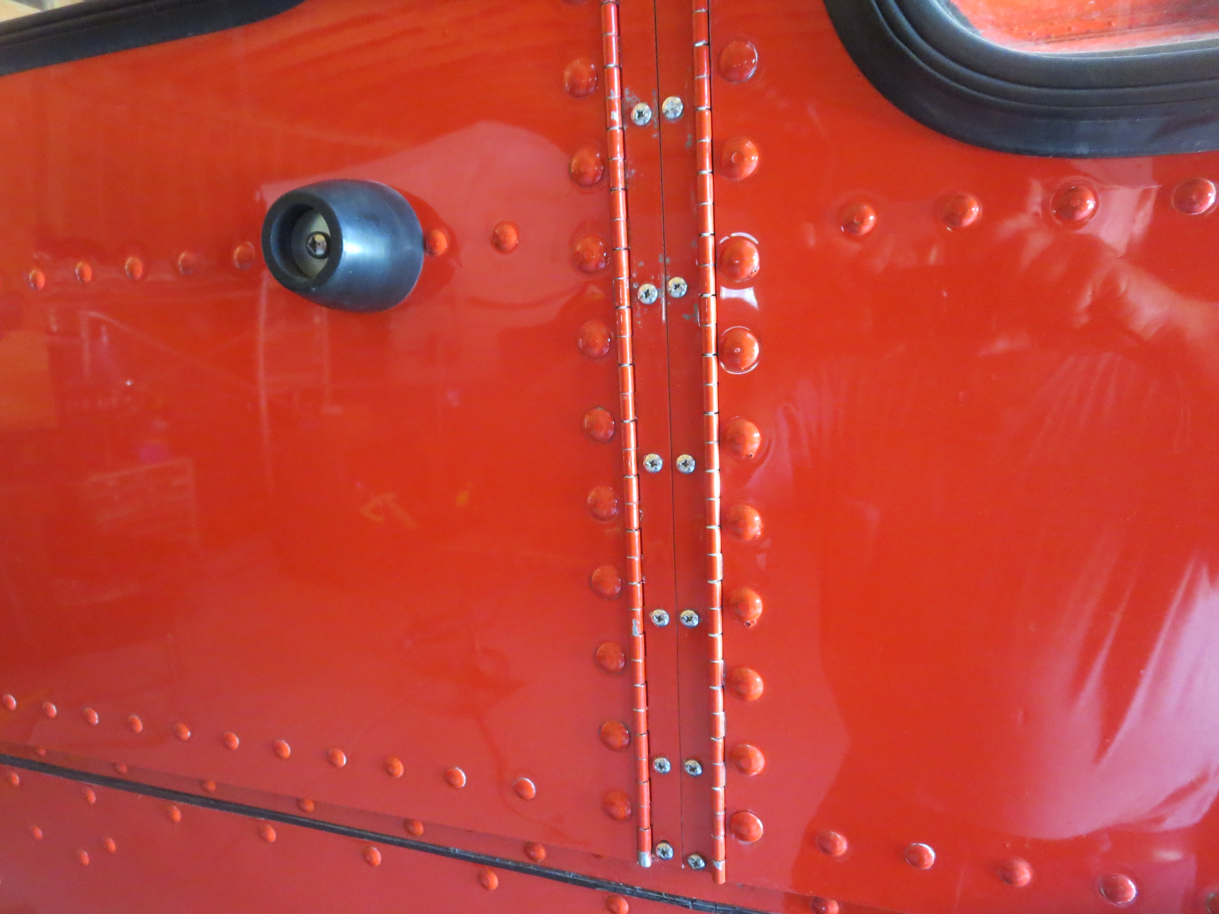

Stainless steel screws and keps nuts for re-hanging the doors. Machine was built using lots of this kind of hardware. Plus stainless adds bling!

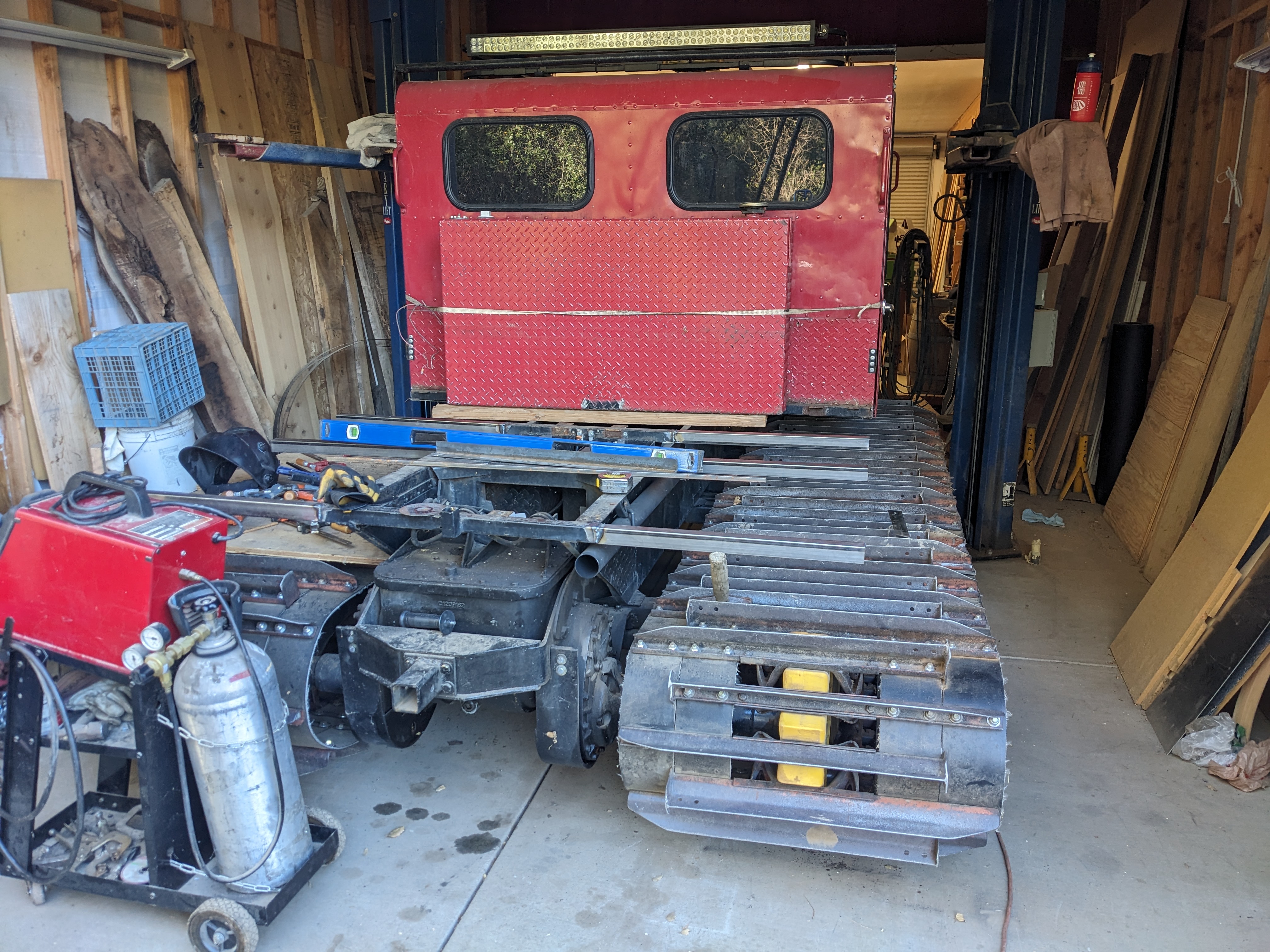

I just removed the bed on the cat. Had to use the plasma cutter to remove all the stainless steel bolts as the nylock's would not let go!
I used a couple stainless hardware on the doors per your suggestion. I think I'll also go with those keps nuts as well. Seems once the nylocks are exposed to the elements, they really do not want to let go!

After quite a bit of searching, I think I have found a solution to the 2.5" channel for the side rails on the bed. I found a somewhat local shop that will fabricate the channel for me. It will run about $100. If I could find the channel pre-manufactured, I figure it would cost about half of that but then I'd have to factor in shipping... Probably average out to a break even.
Yesterday, I spent 3.5 hours pulling the tracks off and turning them around as I have been told they are on backwards! What a pain in the back! I opted to do a three grouser overlap joint when I rebuilt them. I have the track jacks but with this type of belt joint, they just do not work! The jacks are designed to span two grousers only. We struggled with the drivers side first and learned some things along the way. I'll try to describe what we ended up doing to maybe help someone else out.
We did one side at at time as I determined I could unbolt the track joint and drive the cat off the track. You just need to ride the brake steer on the side without the track. Worked just fine. We rolled the track up and used the tractor to move it and spin it so it was now in the correct direction. On the first track, we used straps to pull the belts together. Problem was with the straps, they put tension on the grousers and caused them to roll downward. Thus needing more pulling to get the holes to align up. I hope that makes sense.
On the passenger side, we removed the track in the same fashion as it works well.
To reassemble the track, the big difference was I put the first grouser onto one side of the belt only, on the set of holes closest to the other end of the belt. That allowed us to use the jacks to pull the grousers together. Once lined up, we put the third farthest grouser onto both belts. Once that was done, I removed the first grouser as it was only through one side of the belt. after that, we set out to put the two grousers back on through both belts. Much quicker and a bit easier. Now I just need to remember this in case it happens in the field!

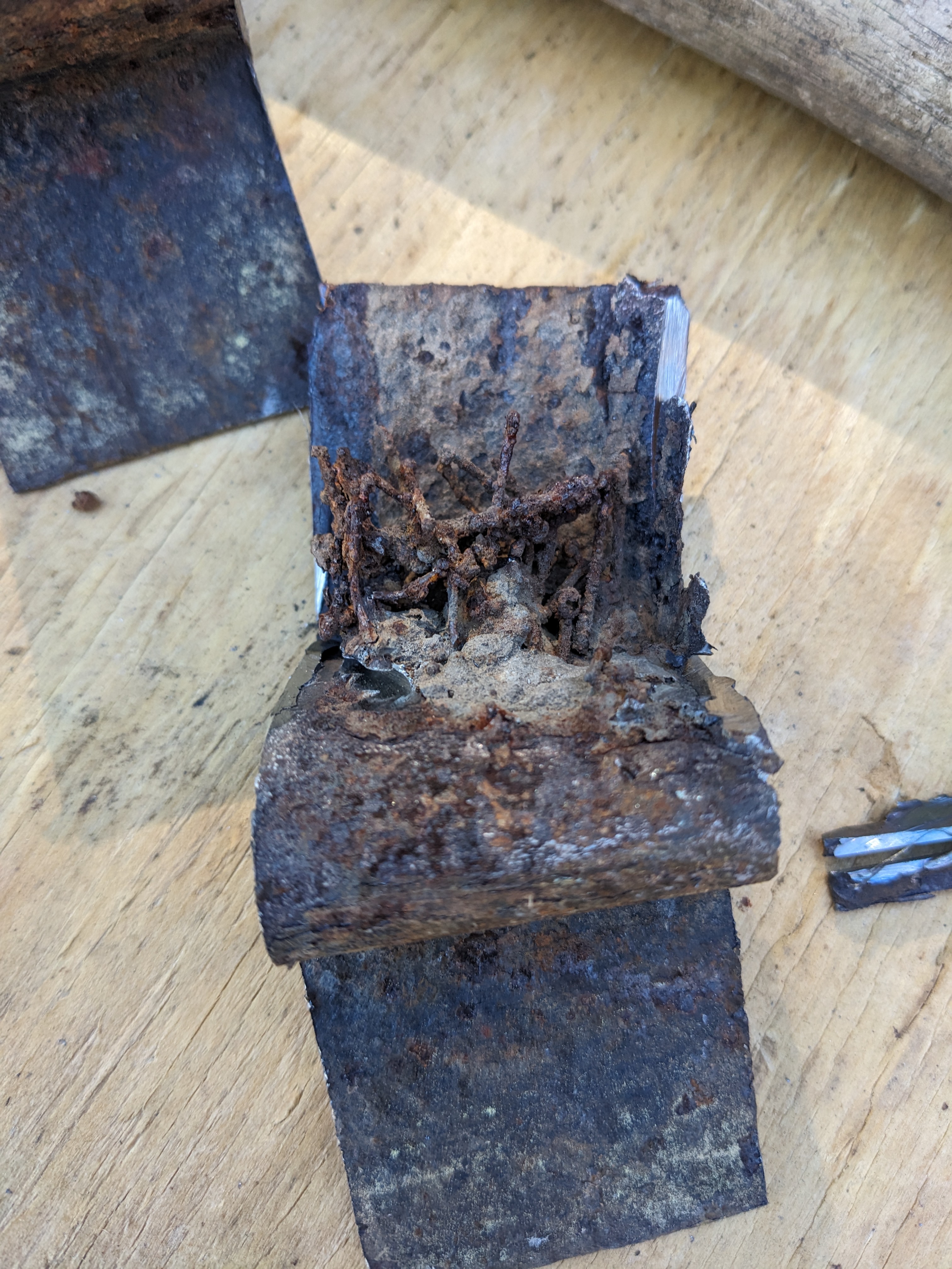

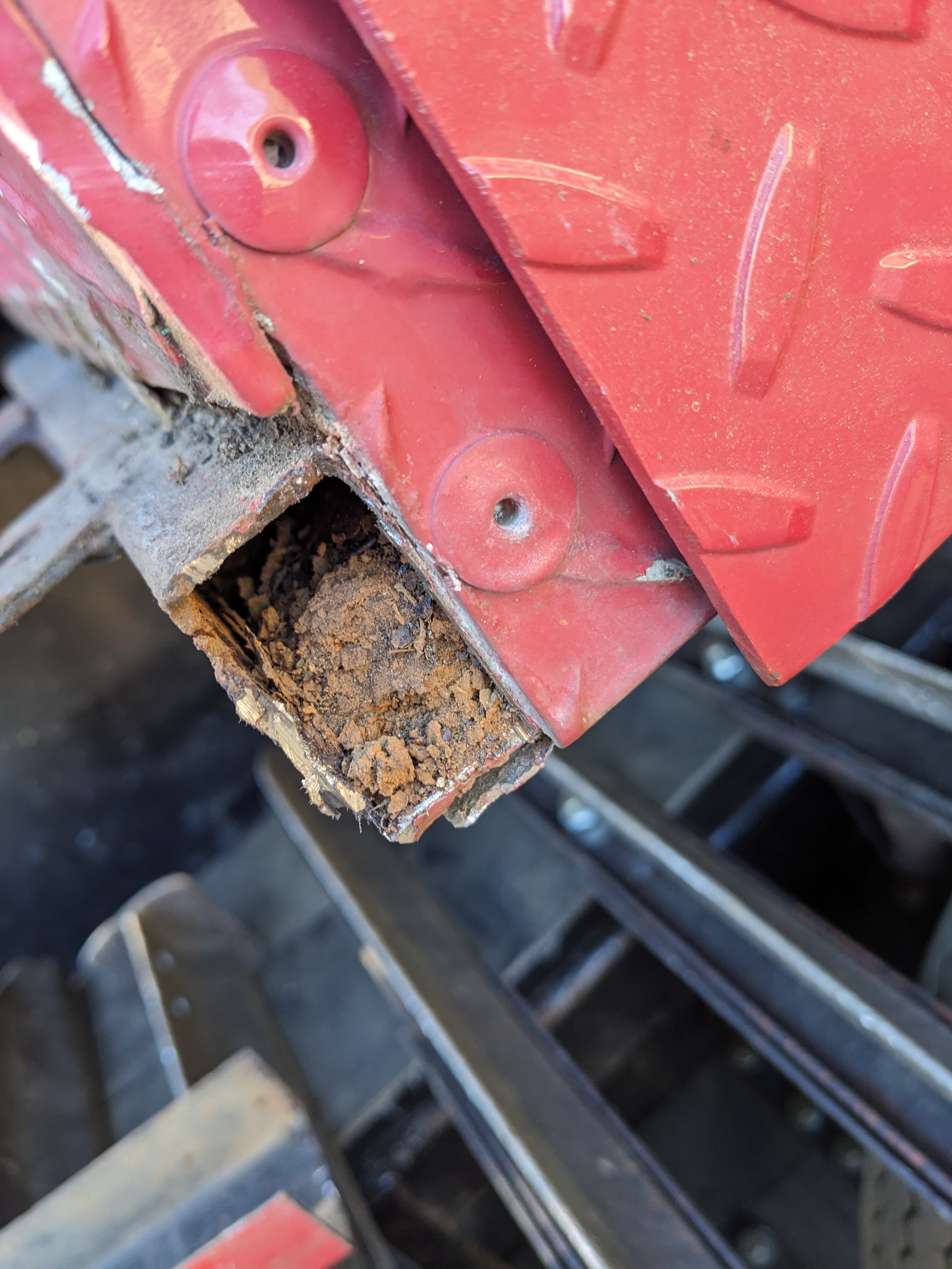

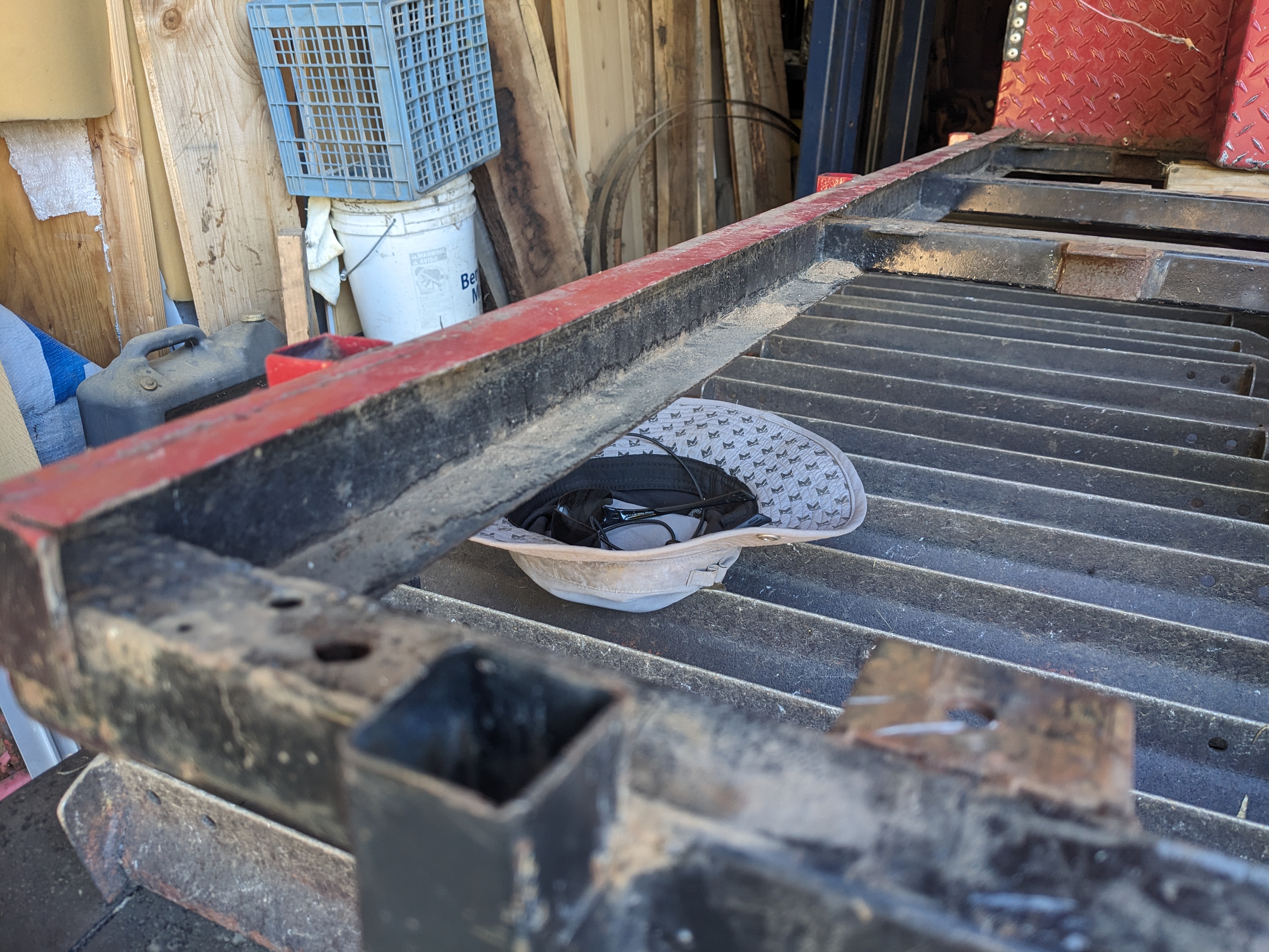

Thought I'd share what the metal looked like on the inside once I cut the channel off. L its of corrosion / rust and god know what else.
My first thought was to just replace the channel as the bed will be a bit longer. Once I cut the channel off, I saw how bad the metal looked. Now I will cut off the cross bracing as well. Will this ever end? Waiting to hear back from the shop on the channel. The Forman said he could do it but the price originally suggested was doubled.
