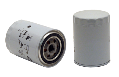

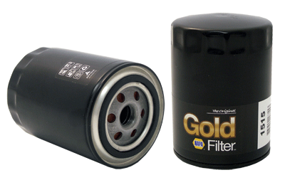

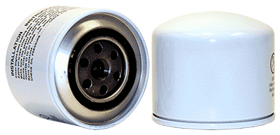

Have you tried the Napa Gold 1189 or 7515? Do you know how different the 1515 is from those? I'm just trying to match the one listed in the LMC 1500 manual.
For comparison:
I've used only the 1515.
