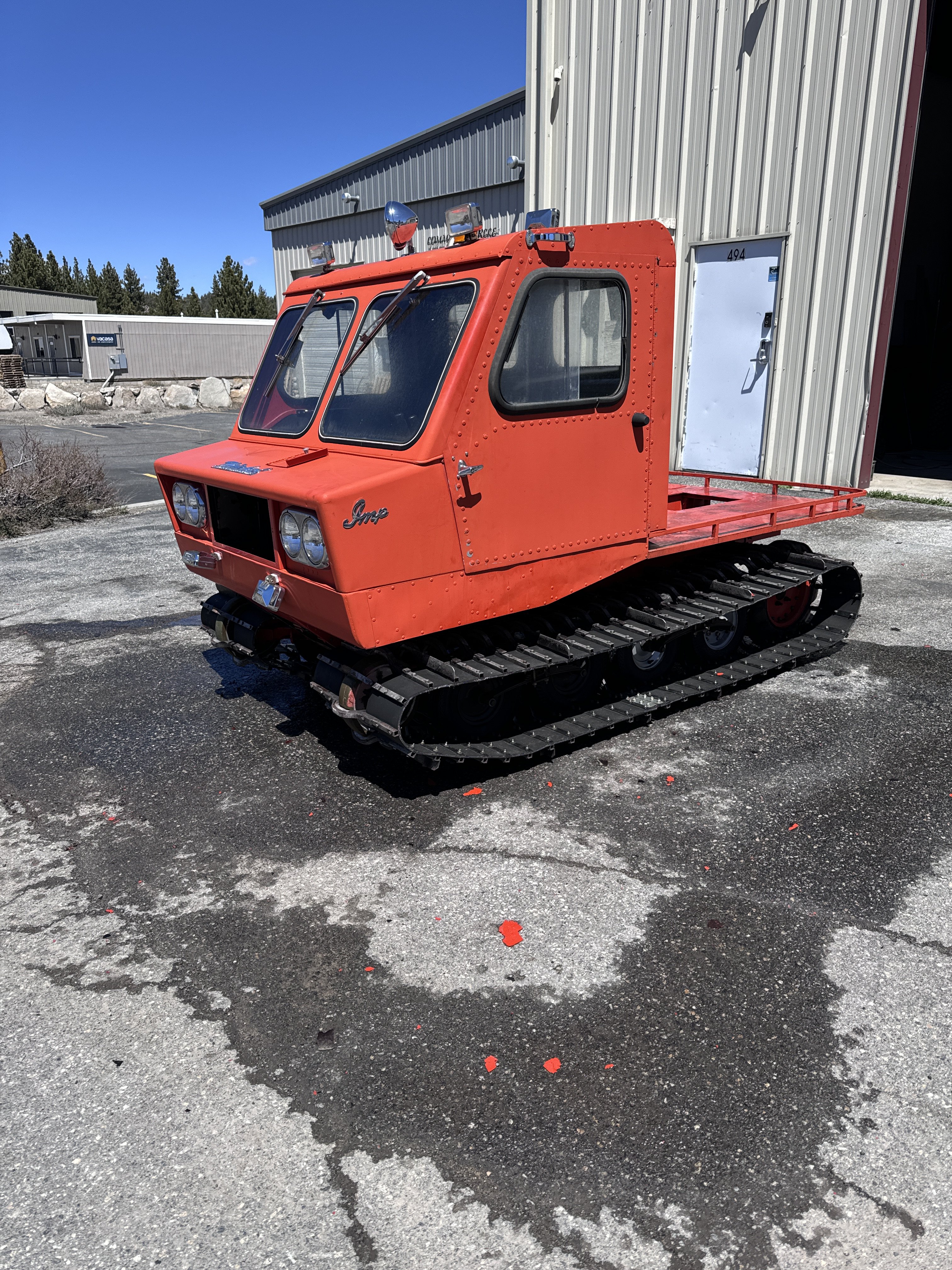

Hi, I just started to restore a 1966 Imp 1404. I pull the diff. Gears look to have wear marks. Does anyone rebuild these ? Can you gears be sourced anywhere ?
I am sure I will have engine questions as well. I have come across a few of the well known websites selling some parts.
I found a new-ish rear diff. So that prob is solved. Dan at Snow Cat Service will have a new carb for the engine. I think I am set. New poly filled boggie wheels coming to be from Fallline in Reno. I think I have the main parts issues solved.
Good find! Though I don't need one, sure wish I knew where to look just in case. Its the only thing on these machines that's a show stopper. When I pulled my diff. apart to fix an error the last guy did, my gears looked really good.
Looking good. Is that a round pipe in the frame cross piece.
I need to go look at mine its different
