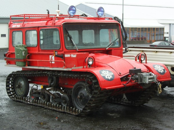

When I installed the winch I welded a 2" profile pipe on the front bumper with supports and also on the rear end of the SnowTrac that makes it possible for me to use the winch on both ends I also connected a 50 square mm. cable from the battery to both ends then I installed two alternators on the VW engine one 65A and the other 55A I have two battery's 65 Ah each the are split up by a breaker so that I have the ignition and starter motor on Bat#1 and everything else is on Bat#2

Would you mind showing some pictures of your dual alternator setup? My brother and I have been discussing a dual setup but chucked the idea after a while. We decided on a Bosch 75 amp alternator with 3 yellow top Optimas. Before we wanted to have one battery for starting only and the other two for everything else. Now we would just have all three hooked up and charged by the single Bosch alternator. If you could show me how you have your set up then I would run two Bosch 75 amp alternators. I am also interested in how you accomplished the dual winch hook ups. I was kinda thinking something on the line of what the military used. I believe it sounds like you may have done something like that as well. What size winch did you end up using? I have been looking at Warns rock crawler series which is rated at 9,000 lbs (4000 Kgs)but weighs in at just 54 Lbs.(24Kgs) Way over kill but sure beats those useless 2000 lbs atv winches. Thanks for any help!

Winches on Snow Cats are somewhat unnecessary. See "Winches on Snow Cats" in this same category. But If you have to have one what seems to work best is to have at least 2 batteries. A winch pulls from a minimum of 100 to 850 Amps. The alternator or generator on most vehicles just can't deliver this much. Having delt with this on a dozen machines I've found that Dual Batteries is the way to go. 2 alternators still won't be enough to run even a small winch continuously. With the old small diameter 12Volt generator that came as standard equipment on ST4's it is possible to burn out the generator. they were only rated at 320 to 360 watts, which equates to about 30 Amps. Also: Do not tap the Winch directly off the starter stud. this is a sure fire way to burn up your Alternator/Generator. Run a seperate heavy cable from a battery dedicated to the Winch. The #6 To be continued:
(got interupted by one of my bosses)Oh yeah... back to #6 or #8 wire frome the generator/alternator keeps from overloading the unit due to voltage drop. There usually is no fuse or circuit breaker to protect the generator/alternator from being overloaded. When installing Dual Batteries it is important to get matching batteries. If the specific gravity of the acid is just slightly different one battery will try to charge the other and they will eventually discharge each other. This can be prevented by having a fairly long lead between the batteries or some type of isolator such as a relay or Diode. The best bet is a Dual Battery switch, also discussed at length elsewhere in this Forum. For Dual Generators/Alternators run seperate charge wires from each Generator/Alternator to the batterie(s) and don't oversize the wire.
