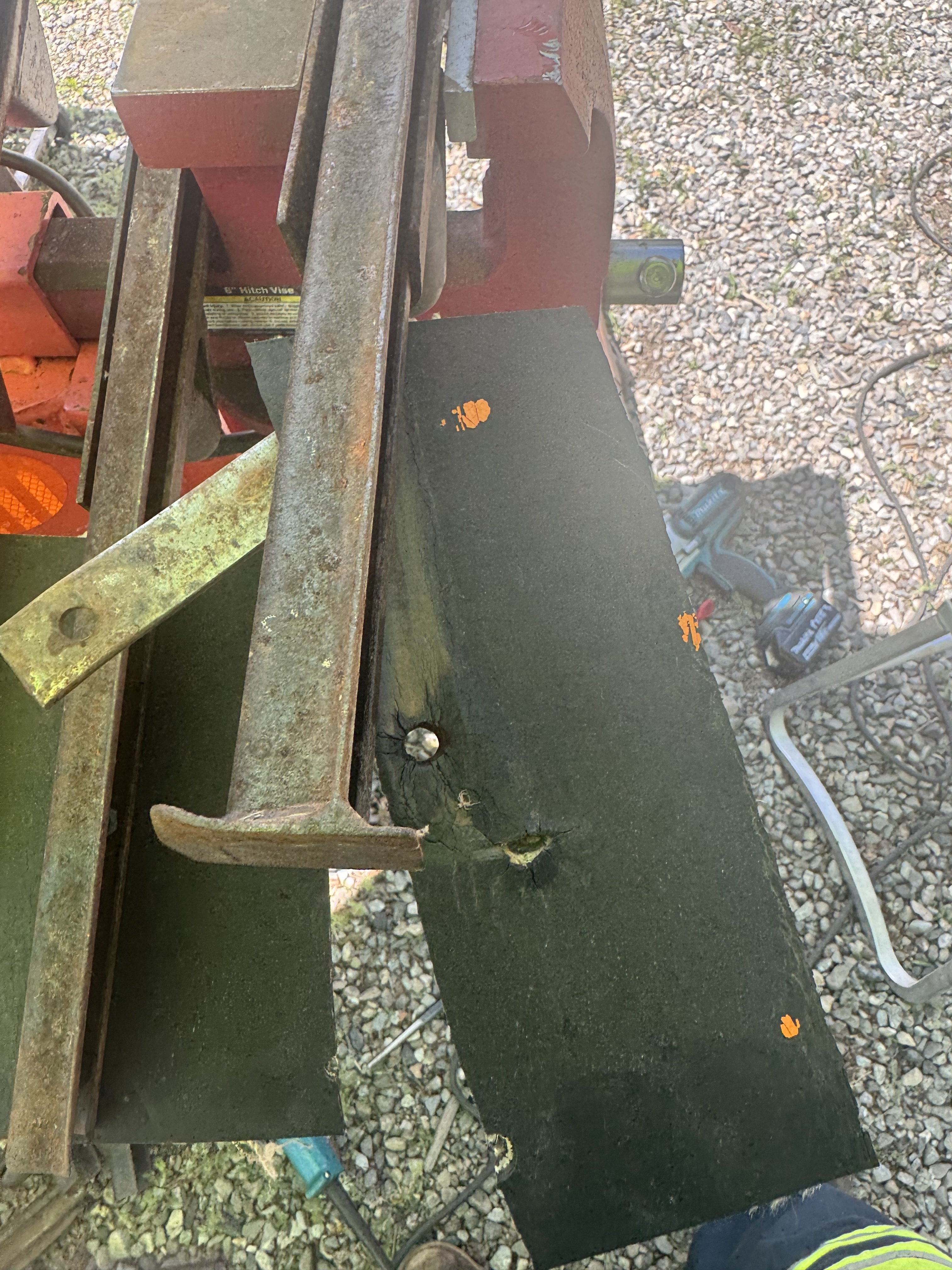

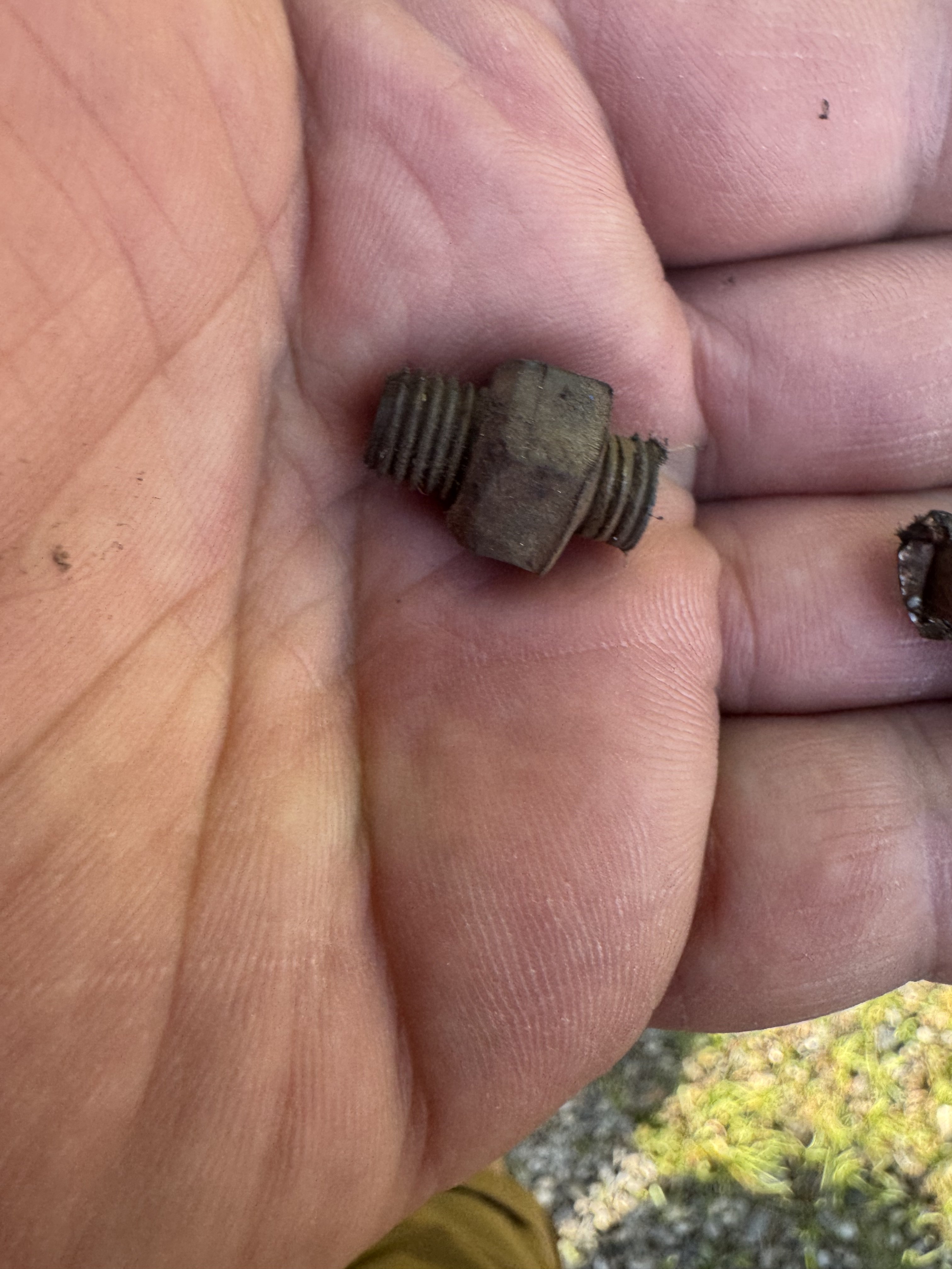

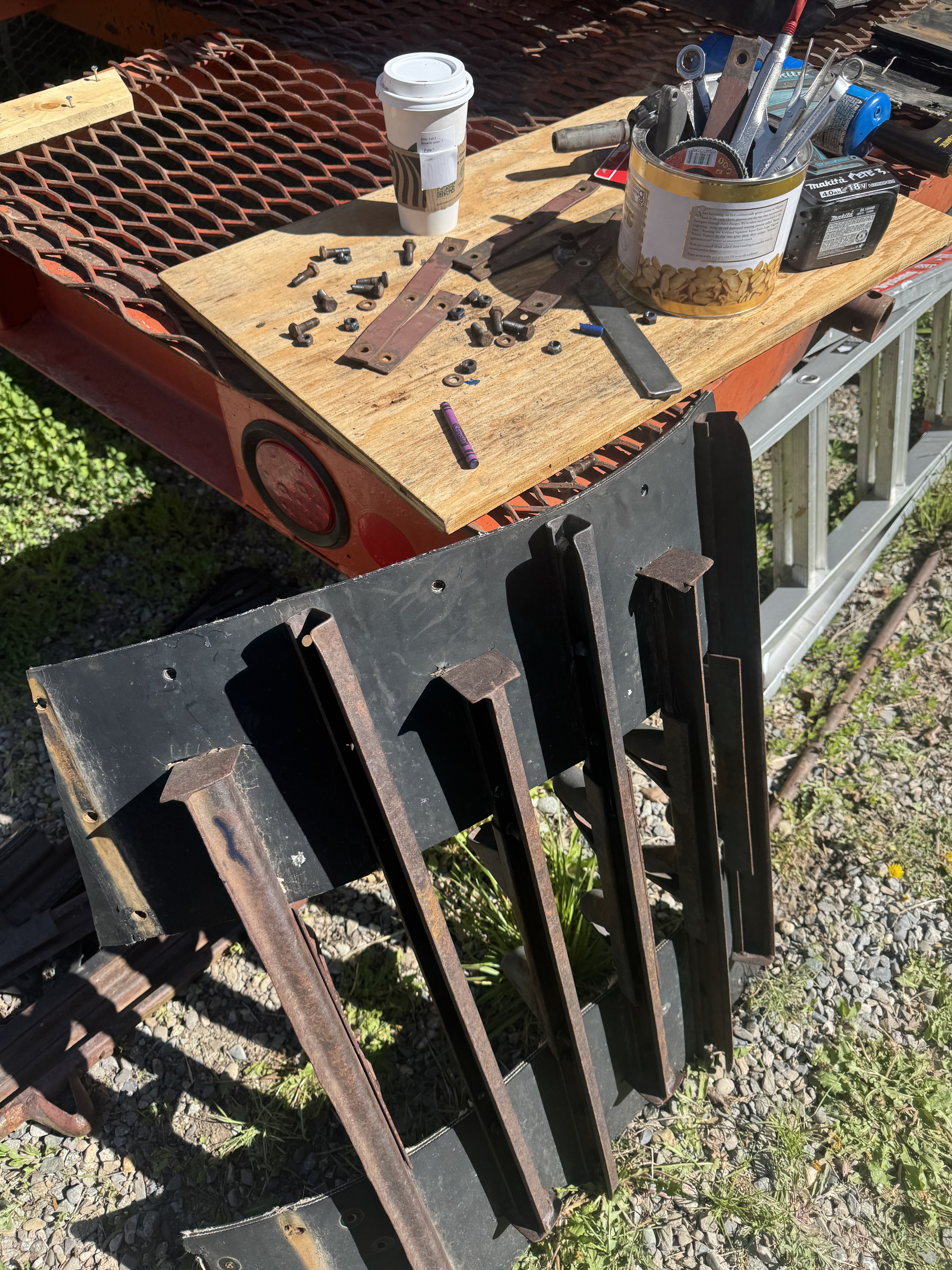

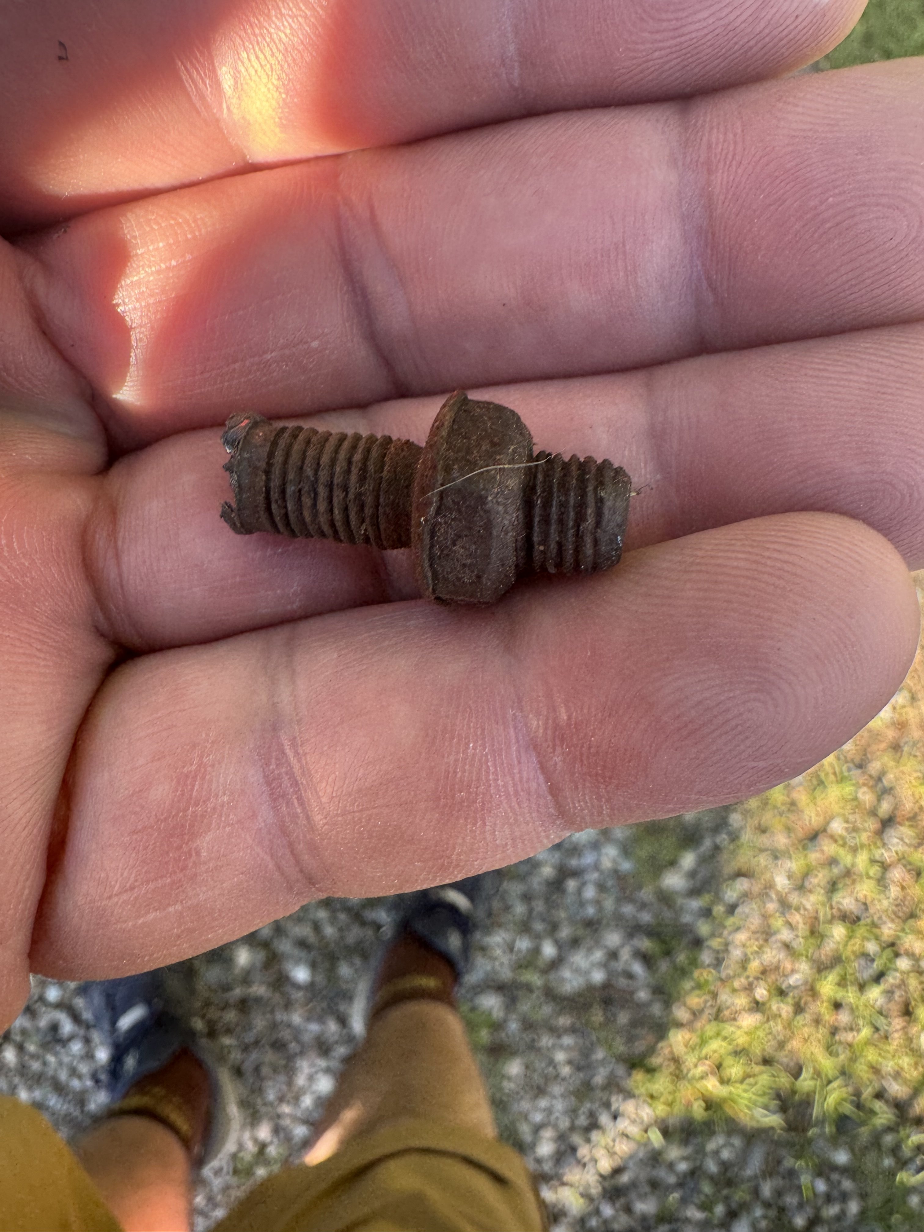

Two years ago, I picked up a very well used set of tracks from Mary Guthrie at Snowtrans. I basically bought them for the value of the grousers. The belts have basically left the chat. Several tears, splices, welded grousers, broken tire guides, loose bolts, etc. Now to salvage the grousers and good tire guides: I’ve found the best method to remove the stubborn bolts that tie grouser to belt is to mildly heat the nut/bolt inside the grouser, then dab a color crayon onto the threads. Next I use a brand new pair of 9” Milwaukee vice grips (read:fresh jaws) to attach to the nut inside the grouser and hopefully rattle out the bolt with my large Makita cordless impact. I made a custom wrench with a shortened 1/2” socket welded to a steel bar, this didn’t work on hardly any of the bolts so far. I found that some of the nuts had loosened over decades allowing the whole nut/bolt to spin and wear down the nut. There was no way to get a proper wrench on them. As you can see in the photos, the nuts are a mechanical lock nut that are a one time use. Because of their design, they are lower profile than a standard nylock. Some have become so worn and rounded that it’s impossible to grip at all with locking pliers. Moving onwards, if the locking pliers didn’t work, I then revert to my 5” makita grinder with thin disk to cut the head of the bolt off on top of the backing plates.
I’ve tried Kroil, and free-all, but the bolts still laugh at me..the wax seems to penetrate and lubricate to be able to back most off without a lot of ugga -dugga’s.

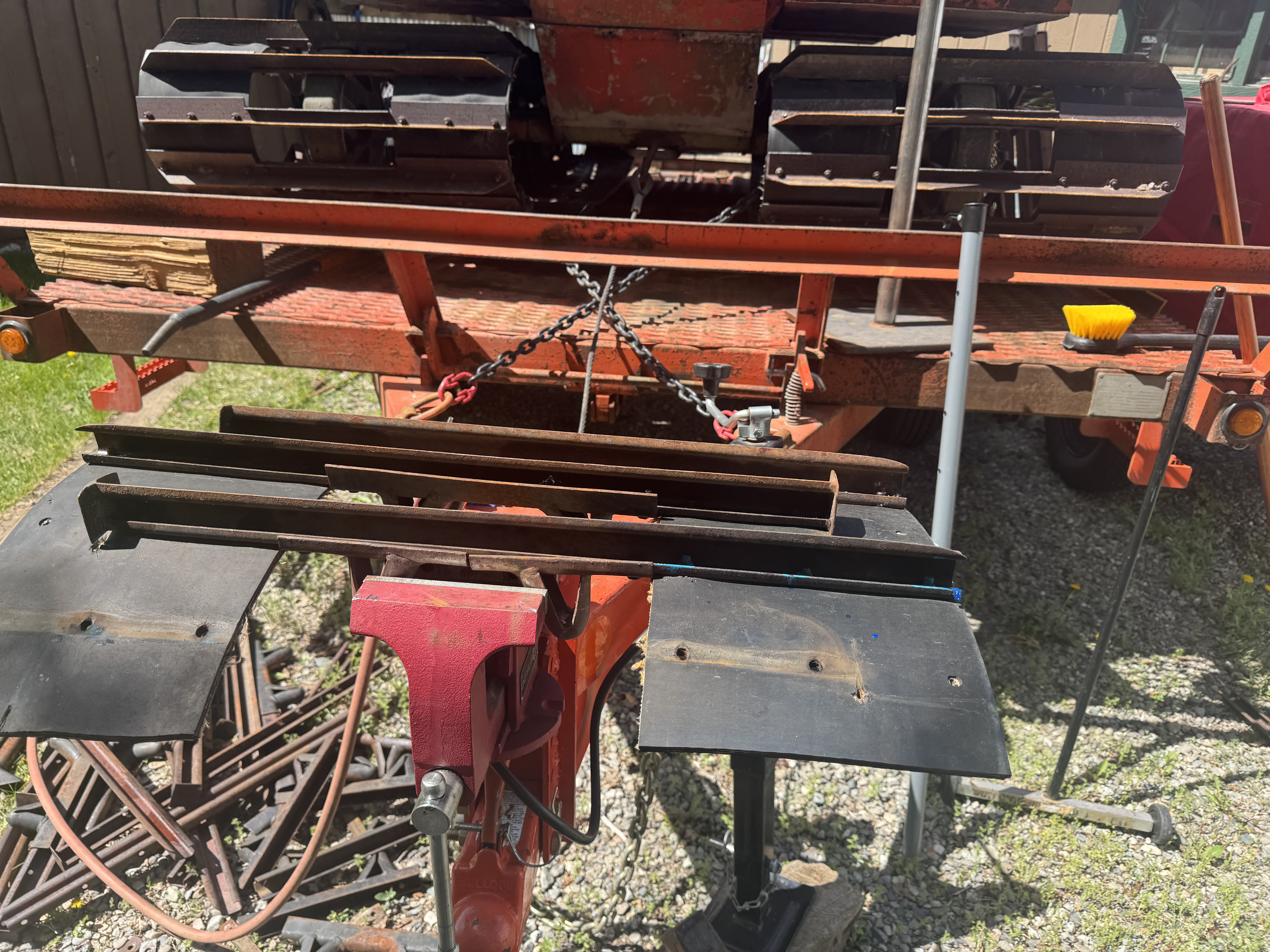

Just to paint a picture of how miserable and tedious this is, I’ve completed tear down of 1/2 of one track in about 7 hours. I have a good process down now that seems to make the process go quicker, or at least it seem to. It’s definitely easier to cut the old tracks into 2’ sections of 5-6 grousers, and work on them at a decent height while holding in a vise.

I made the special short socket tool and it worked for maybe a third of the 500+ nuts and bolts. Some came off, some simply broke off. Tried heat, tried PB Blaster, tried a skinny wheel...all with limited success.
Ended up using my plasma cutter to 'wash off' the bolt heads...carefully so as not to screw up the grousers. I spent at least 40 hours disassembling and reassembling the tracks. Those things weigh about 250 pounds all rolled up.

Finished the last 1/2 of the track today. Still gotta cut some bolts off the grousers that left the chat. I can’t tell you how monotonous this has been but the good news is I’m half way done now! Used my makita oscillating tool with a hook knife on it to cut the track at every grouser if the bolts wouldn’t come apart. I’ve got 3- 5 gallon buckets full of belting chunks now. I’ve got about 50 bolts to cut with a thin disk to get everything cleaned up. Getting closer! The heat wrench and crayon wax trick is amazing! 11 outta 10, highly recommend!!
