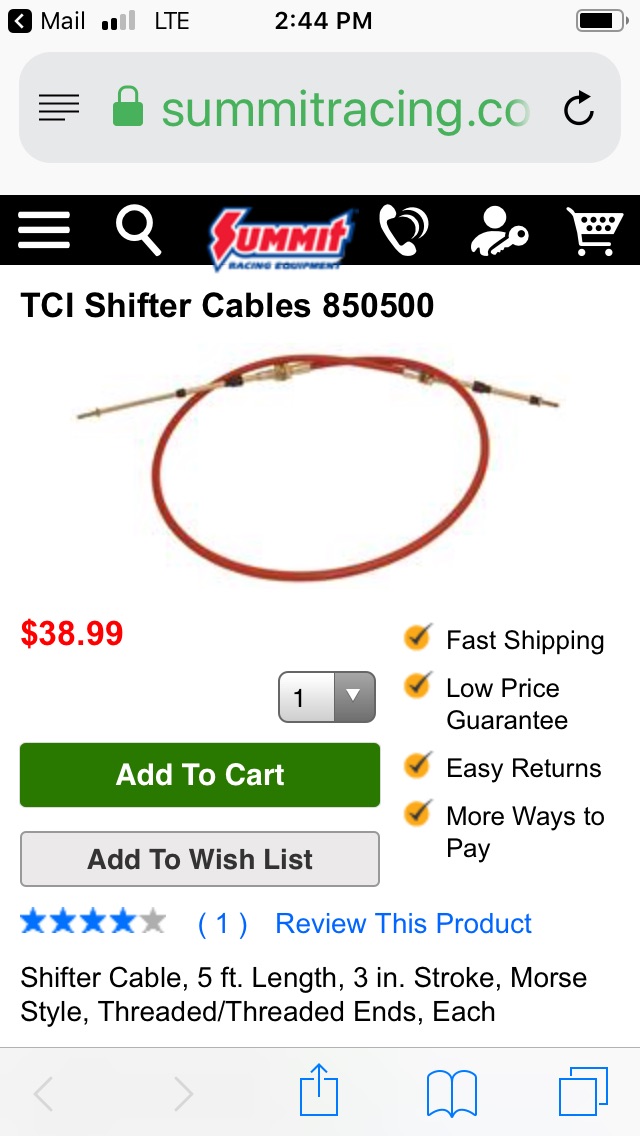

Thanks to a local boat company's bored parts guy, he determined it was a TCI shift cable. I guess all kinds of various equipment use shift cables for throttles. Got it from Summit Racing. Part # TCI 850500. Exactly the same! Works great. I never realized how long the old cable has been bad till I used the new one. I think as it got stiffer, the previous owner(s) just added another return spring.
