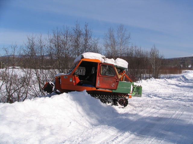

Here's a pic of todays "adventure" :yum: Pushing the banks back to get ready for more.
