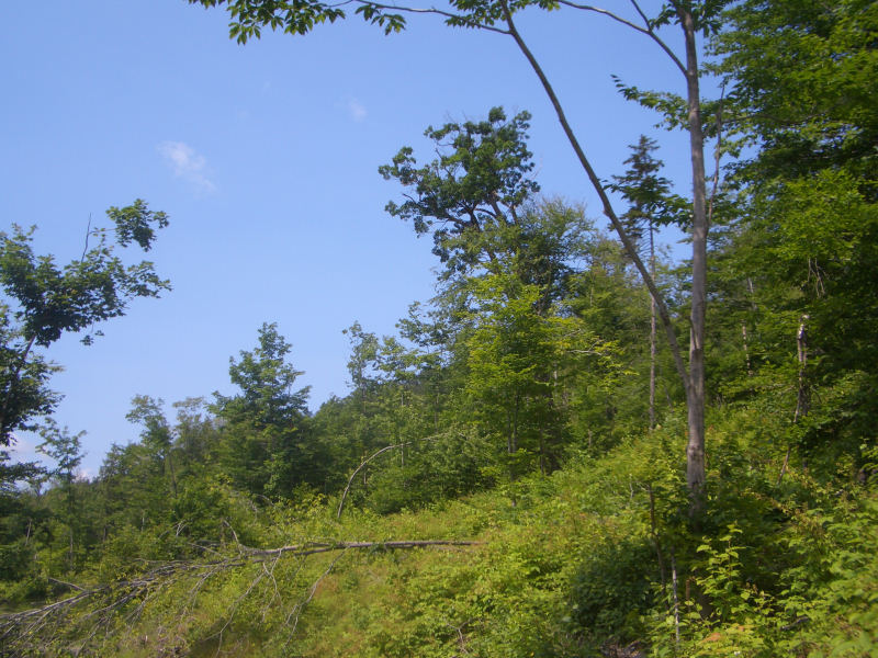

Here are some pics...the first one upmtn1.jpg is looking straight up where the road would start but it would be a side cut to the left and up 600 feet. The exposed dirt is a pre-existing build site a bit lower down the mountain but you can see the type of earth...very clayish. A reasonable number of stumps because it was cut about 5 years ago. Not too many medium trees to drop but some...not much work in dropping them so it's mainly stump time.
Then get to the top... upmtn2 is looking along the length of the mountain with a moderate grade up the mountain to the right. upmtn3 is looking along the length of the mountain in a steeper part to the right. So then digging into that mountain 50 feet and 400 feet long. That's reasonably steep up there so digging into that and pulling it out 50 ft...granted it doesn't have to be hauled anywhere...just pulled out and over the edge to the down side of the mountain. That would deliver a 100' x 400' build site.
Now, that was after cutting down the job size.... originally it was 200' x 400' build site...digging way into the mountain 100' and then pulling out and over the edge 100' to yield 200' wide site. It is pretty steep so it's alot of earth. That was a $45K job. Broke my back when I got that quote!!! I was thinking...sionara 'build-site with a view!'

See attached pics.

OK, so your $25K was worse case.
If you could pull the price for the stone and culvert out (you pay for yourself, based on your need/desire), and they give you a $15K price for the excavating, that sounds reasonable.
I've seen many contractors underbid the exact same project you're talking about as hill digging is misleading if you don't figure yardage very, very closely. If you contract to do it, get a fixed bid, in writing with specifics on dimensions, location as well as what to do if/when you hit an obstacle (e.g. who's going to pay to blow up the big rocks)
