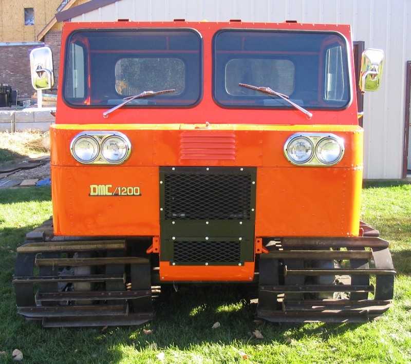

It's finally finished and waiting for snow. I can't wait to run it in the deep powder. :thumb:
The machine is a 1981 DeLorean 1200 with about 2200 hours of use.

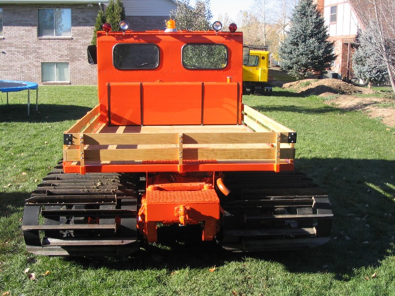

I replaced several skins on the cab to remove all dents. The rear deck was totally rebuilt with new frame work and wood. Freshly upholstered seats, new carpet, foam headliner and door inserts. The doors were both reskinned with a heavier aluminum and new sliders installed. Nothing was left unattended in the restoration. Like new:o

The seats are the original seats recovered with a cloth center insert.
It has the 36" tracks that make it 8'-4" wide. I wouldn't mind having the 48" tracks, but it wouldn't be trailerable or fit in my garage at the cabin.
It doesn't really need wider tracks because it performs great "as-is" The two man aluminum cab makes it much lighter than the five man or full cab 1200's.

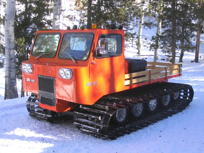

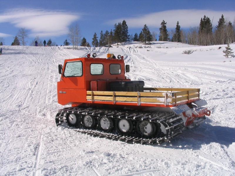

We had a few weeks of 4 to 5 feet of soft powder to operate in through late February and early March. It was fun to run it head to head against a few other cats to compare performance. In climbing, it was unbeatable, even against my friend's Tucker, which really surprised us both. ( it wasn't even close) The snow was so deep and soft that you would sink up to your arm pits if you stepped off the tracks. I also had powder getting sucked into the engine causing the alternator belt to squeal at times. Way to much fun. :letitsnow:

I added fenders in February to keep the snow from piling up on the deck. :thumb:

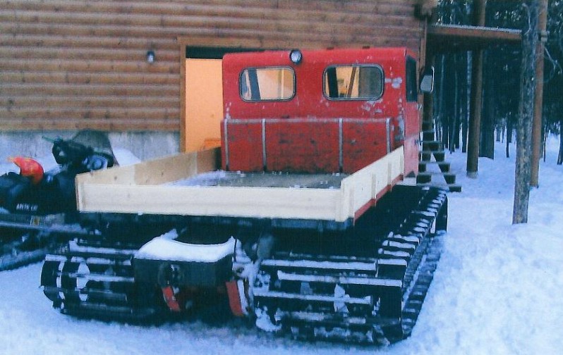

I found a photo graph of it before I bought it. I'll have to scan it so I can post it. The paint was an epoxy. It has held up very well though this last winter.

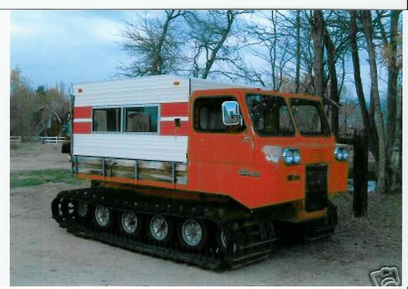

This is what it looked like when I purchased it. The camper shell didn't make the trip home with me. The rear corners were both banged up a lot. The front corner was poorly bondo'd. I ended up reskinning the front corners and the bondo area too. I replaced the cracked windshield with new tinted glass.
I bought it in February and ran it until late April to see what it needed. Here's a shot of the rear to show the condition of the cab and deck.
This will give you an idea of what I had to start with. It was in pretty good shape overall. I had a lot of little repairs from neglect. However, the big ticket items were all in good shape.
