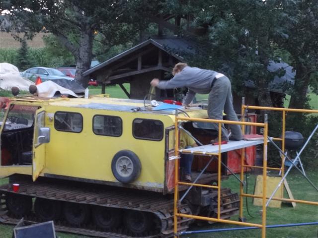

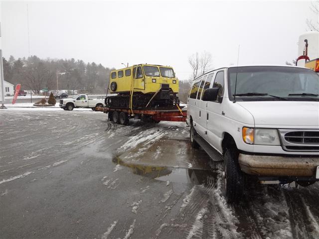

to me in my world,
The images are of a Standard old normal track.
If someone says Wide Track or WT all the machines that i looked at in my search's had another belt in and out side.
to accomplish this extra belt, the rear diff has its axle width set a bit wider.
So Like the general consensus that is growing above.
I will weigh in on the don't cut it side, hold the course machines are out there that fit your needs.
$.02

Great information and pics. Sweet cat!!I will never cut a track down as grousers are a finite resource. I would think about reconfiguring a cat and buying a pair of 8 footers (like when my rich first wife sends me 10k). I wonder how realistic/expensive it is to change axles to go from WT to ST? I'll bet there's more to it than meets the eye. There's some sweet 1201 10'ers in foster care out there....
