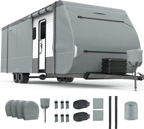

I was using some canvas mainly for the preservation of the tracks then build a lean-to. Provides protection and other functions as well.

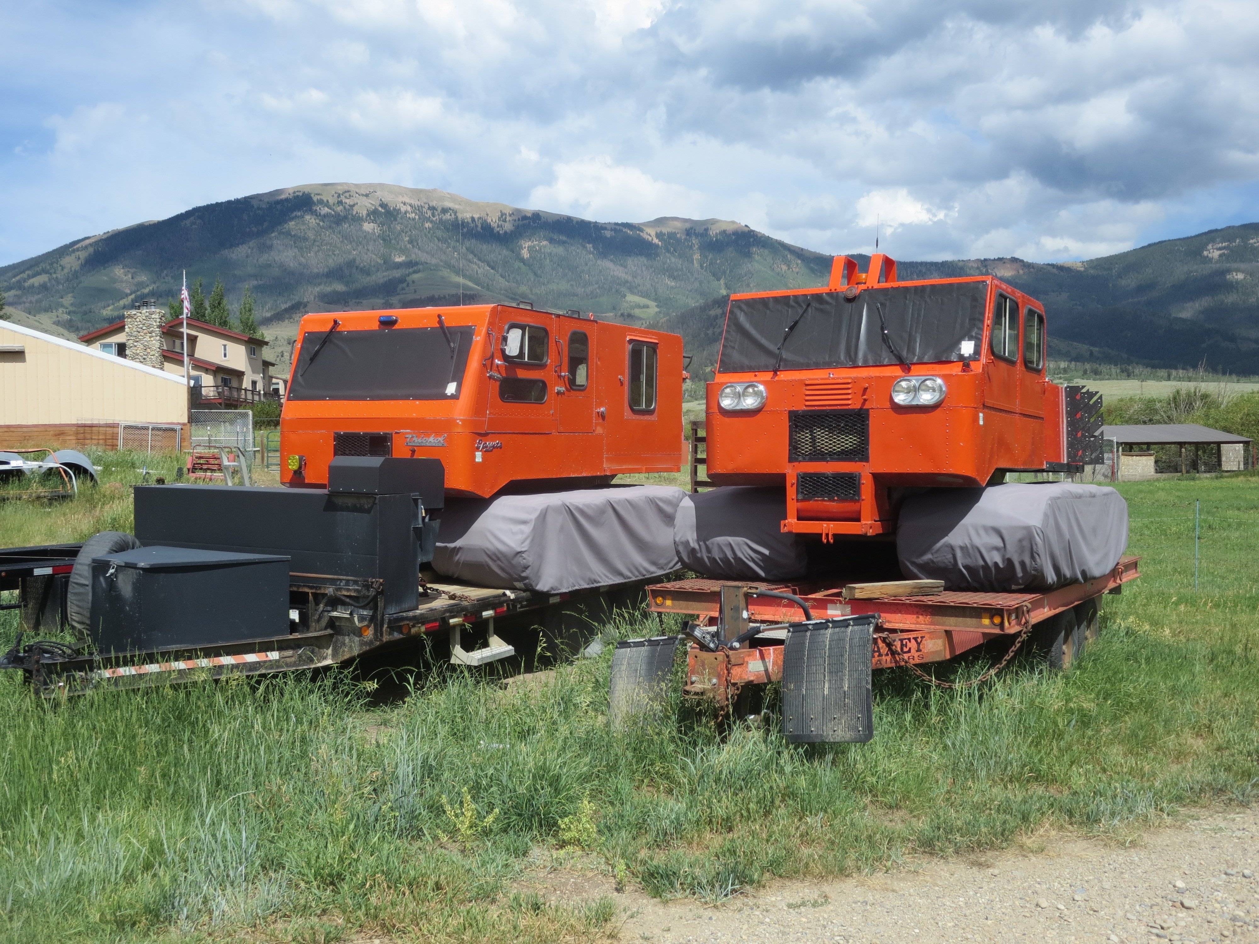

When I was parking outside I drove up on 4 6x6's to keep the grousers up and from sinking in and cut a silver plastic tarp longways to cover the tracks from sun damage. If you're leaving it on the trailer I suggest blocks of wood under the tires and RV tire covers. Ski area groomers around here de-track and store the tracks on end indoors. That's a nice lean-to. A couple timbers will help stop your tracks from freezing to the ground. These guys had track covers custom made about $500 if I remember.

At the very least I should make some track covers to keep the sun off. No issues last year with the tracks freezing to the ground but that would be easy enough to just drive up on some timbers.
So no, not parked on the trailer. I did jack and block up the trailer to take the weight off the tires somewhat to avoid flat spots. Tires are basically brand new. Should probably cover them too.
