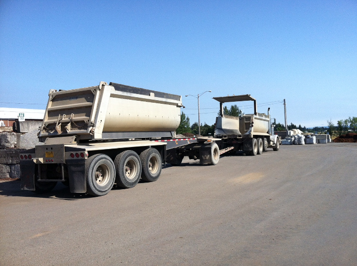

Here is a piccy of my rock rig.
You can see the Black poly starting about half way down the side of the truck tub.
3 pieces in there with a W pan that retains the pieces of poly and allows the tracks for the transfer to bolt in.
The rear tub was a real animal to get the plastic into.
We would cut it to length and width then roll it up with 2 come along's and then tie it in a roll, and then drag it up over the side.

Coaxing the 1/4" polymer into those big azz tubs was always a challenge for warm/hot days.

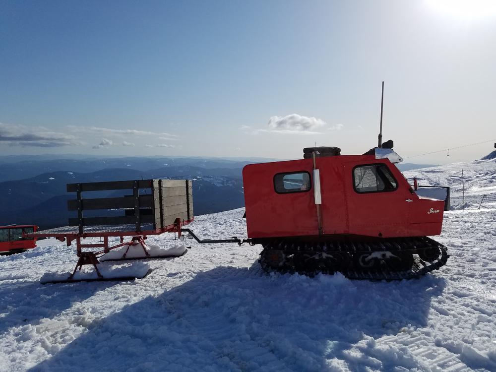

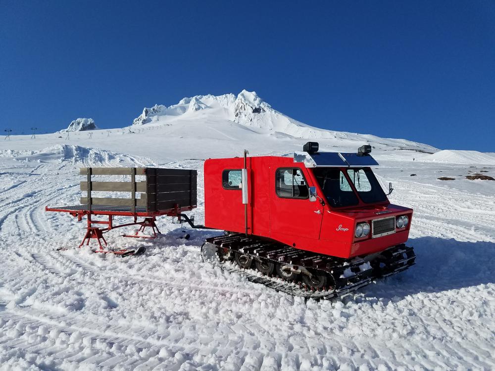

Finished up the wood sides, and took the cat/trailer to the Mt.Hood Snowflake adventure. The wood sides are VG Hemlock, stained grey, and now are awaiting spar varnish. Only remaining project is to wire up all the LED running lights. (Also built a new rock/spray shield for the ramp trailer to protect the cat. The trip to McCall caused a few blems)
Brought the trailer because I thought the grades up the hill would be milder. The past cats meow pics didn't do the slope justice. It was steeeep!
Still was able to pull it all the way up without any trouble, and the temp gauge read the same as always.
It works! Thanks to all that viewed, and special thanks to all whom made suggestions. The brake idea is perfect! If you look close, you can see the belts tucked under the skis for the Imp-ending downhill run!!
