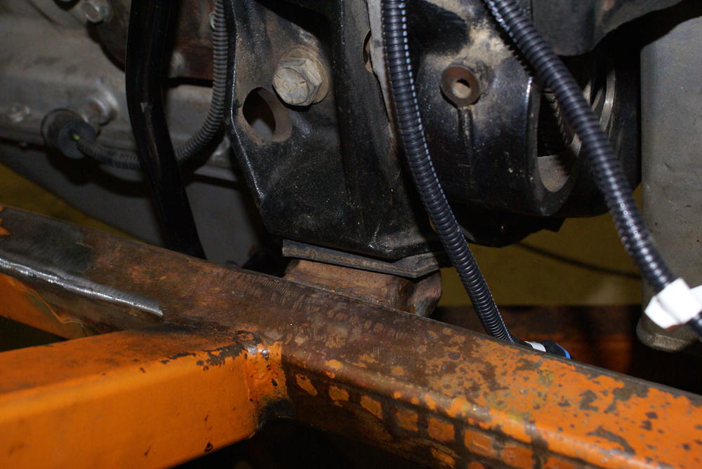

The AT545 has locations on both sides for brackets to bolt on. With our Thundercat project we cut off the mounts Tucker welded to the frame for the original five-speed mounting setup, and relocated them to use with the brackets for the Allison. Tucker used a different setup when they installed the Allison in my 1986 1544. Pictures are useful:
Here's my snowcat buddy Scott cutting off the stock Tucker frame mounts used for the bell housing ears.

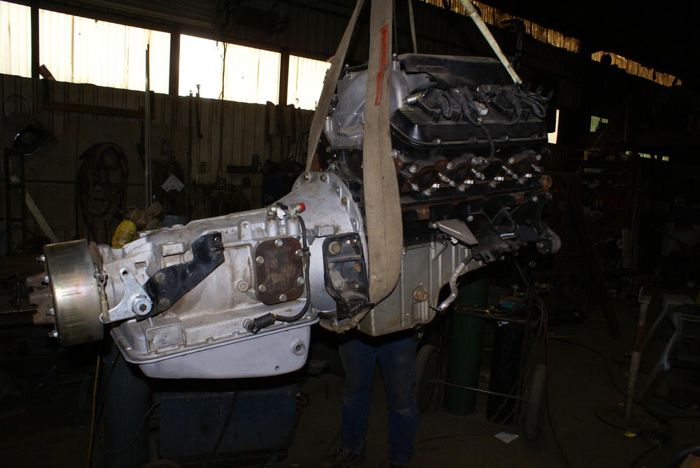

Here's a photo of the engine and transmission. You can see the bolt-on brackets just behind the wide lifting strap. Note also the parking brake drum and mechanism.
And here's a pic of the installed transmission mount.

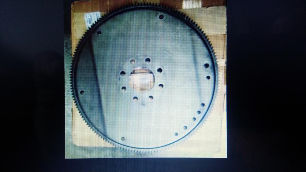

heres a few pics of some of the common components needed to mate engine to trans....etc...
