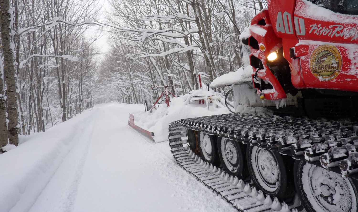

If you manage to get up this summer, do get in touch. We camp in the NF lots each summer. Two years ago I groomed sled trails here and might again this winter. I tried to attache a photo of that but today its crashing my PC! :(

I'll try posting a photo again :whistle: It works! It works!
