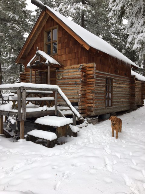

Hi BT: In 1017 I built a log cabin.. cut the trees, peeled them, scribed, fitted logs, and it turned out great. In the finish work inside around logs and irregular surfaces I used cardboard to shape the part then transferred it to the planned wood, cut, and it always worked out great. Nice idea. My cat has belly pans, aluminum, and held with screws or bolts in holes already placed in the under frame.

My humble log abode is a bit more....humble, compared to your mansion. All done by brute muscle power, no machinery other than my truck and chain saw. Off grid solar, batteries, inverter, spring water piped down the ridge about 2500 feet to a buried tank, composting crapper, stuff like that. The only luxury is my Serius XM radio pumped through ancient Bose 501's (lifelong paid-up subscription when satellite radio was just getting started...surely they hate me but a deal's a deal, $400 20 years ago).

Your build is really cool !! Anyone that does this realizes the craft involved and what it takes to make something in and out of the woods (meaning with woods materials). So, good for you! One thing I like is when I am in the cabin, I can be comfortable in knowing how tight it is and enjoy the coziness and warmth of a wood building both from the perspective of temperature but also from the perspective of the esthetics. It is quite the experience to step on the porch and enter something you built with your own hands that will last for centuries if done right and no forest fire...
I have a backhoe so I used that to work with the logs both in transport and positioning during scribing. I wanted this to be an art project so I did it the hard way with full scribing. Chambers has a book and video sequence on how to do this and I followed his advice and methods. I picked and felled the trees, peeled them, and so on. I have used a draw knife before many times but instead, I found a guy in Estonia that made a 9 inch disc with 3 adjustable cutters on it that goes on a 9 inch angle grinder and this is how I peeled them. The most I did was 7 in one day. Saved me a lot of muscle work even though it was not easy in the heat of the day.
I barely got the ridge pole up with the backhoe that has an extendahoe on it and had to fix the log to the back side of the bucket and then raise that to get it high enough but it worked.. slipped right in and the fit was excellent... whew.
