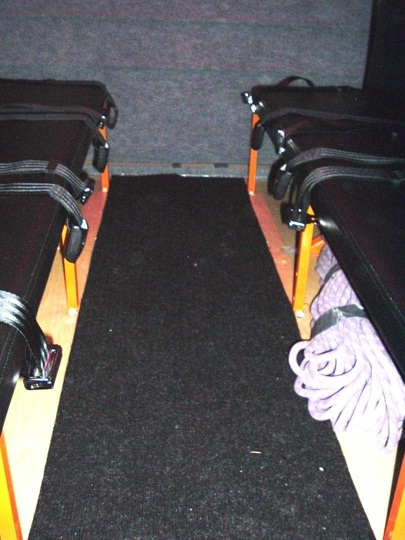

Did you ever get any pics of the finished seats (rear) and how you ended up completing the roof over the drivers area?
And, how is the interior noise level with the extra insulation?

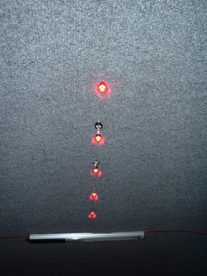

I did get the interior finished. The roof was the real PITA as I used the same rigid foam board as the rest of the interior panels. I had to make it up in sections and taped it all together while installed, then took it out, layed it out flat, then cut a new single piece to cover and install. I had to run a series of 'slits' in the back of the foam board to get it to form into the curves, but it all came out smooth and even when done. The rear seats came out great and the sound and thermal insulation is far superior to what it was. I only run the front heater to clear the windshield and the rear only runs for a few minutes after it's been sitting with all the doors open in the cold. Anything more than that and it gets too warm inside.
I need to take some pic's of the rear interior now that's it's finished and I'll post them when I do. The dimples down the center of the roof insulation in the rear are actually a series of 8 recessed red and/or white LED interior lights that I can select for running with passengers or loading at night. The 'bar' across the center is a 12v flouresent that the USFS had installed as the only source of interior lighting, which I decided to put back in....

Rear interior pic's....
