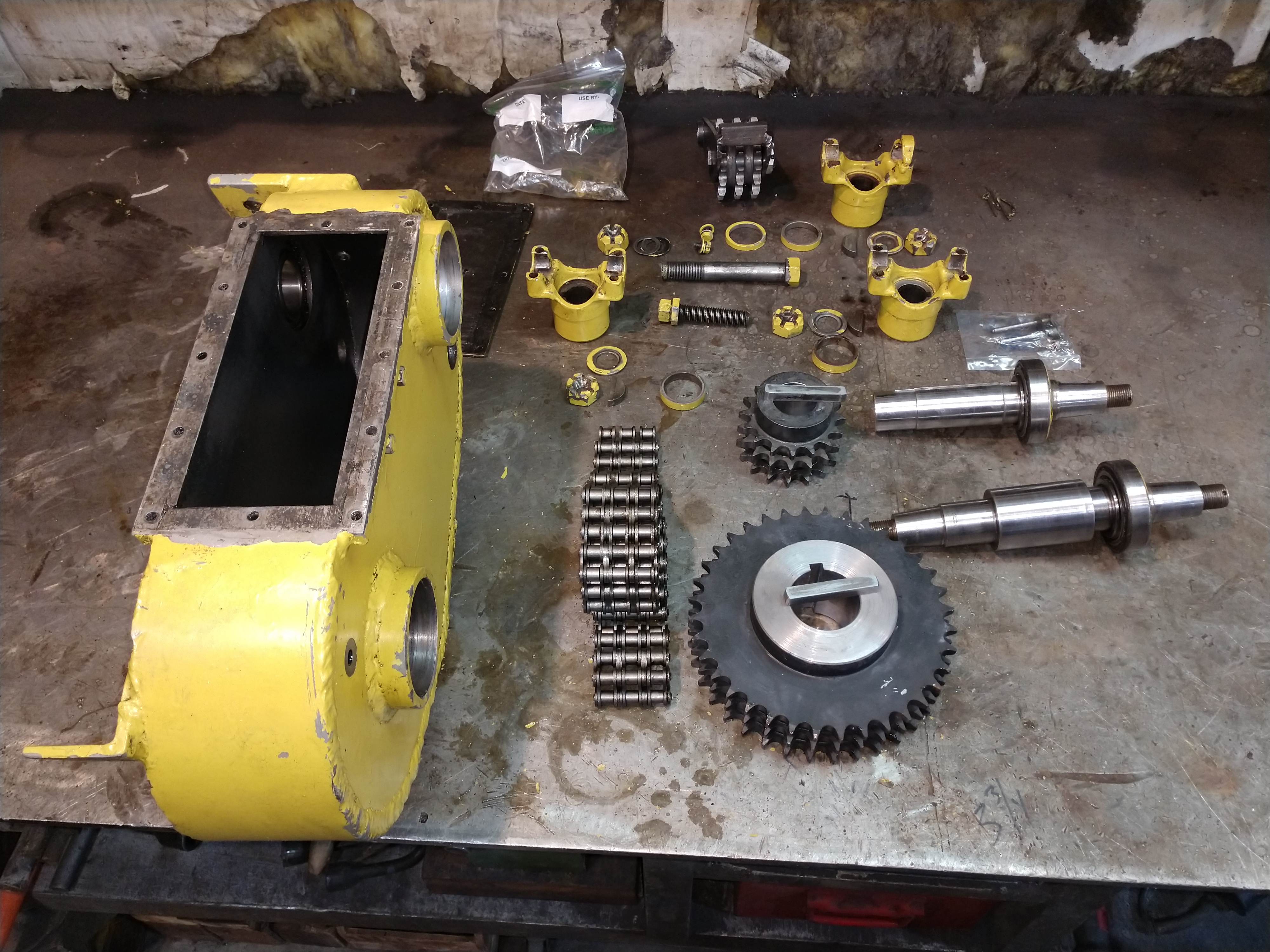

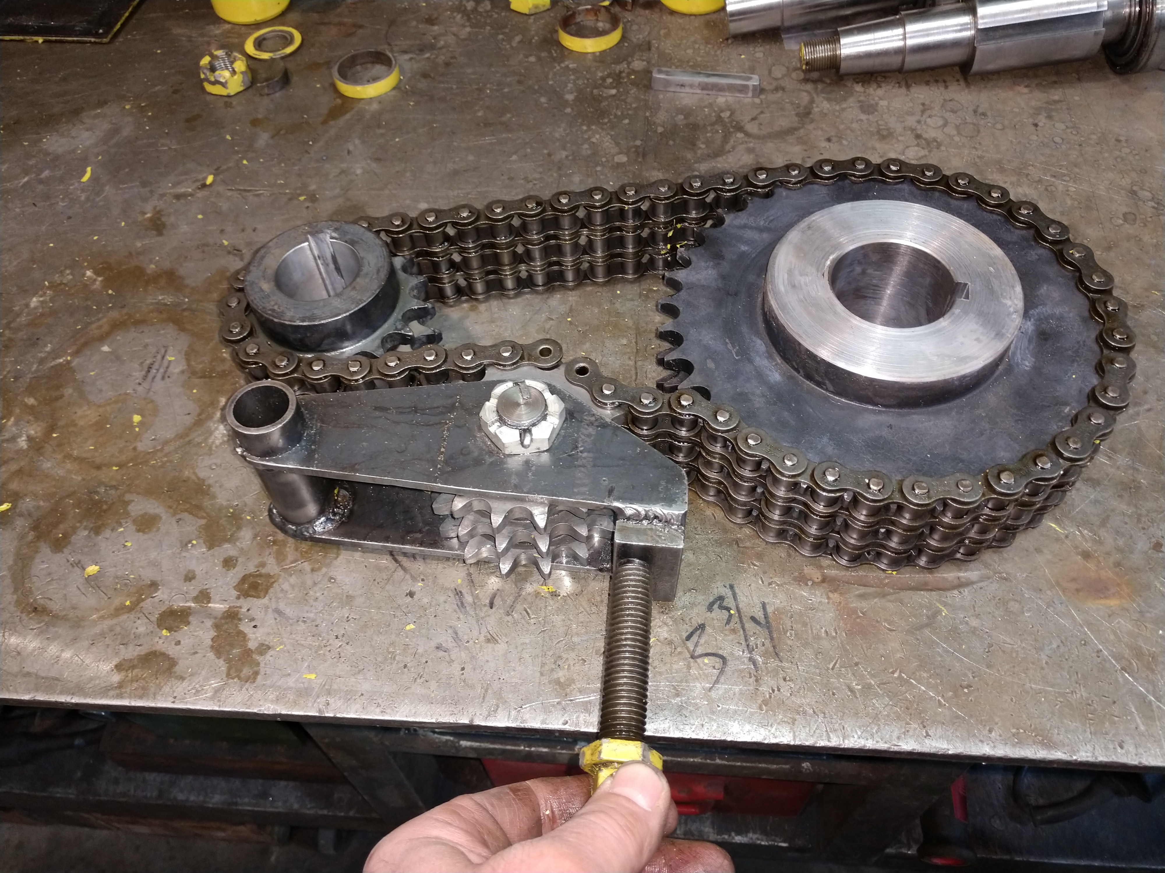

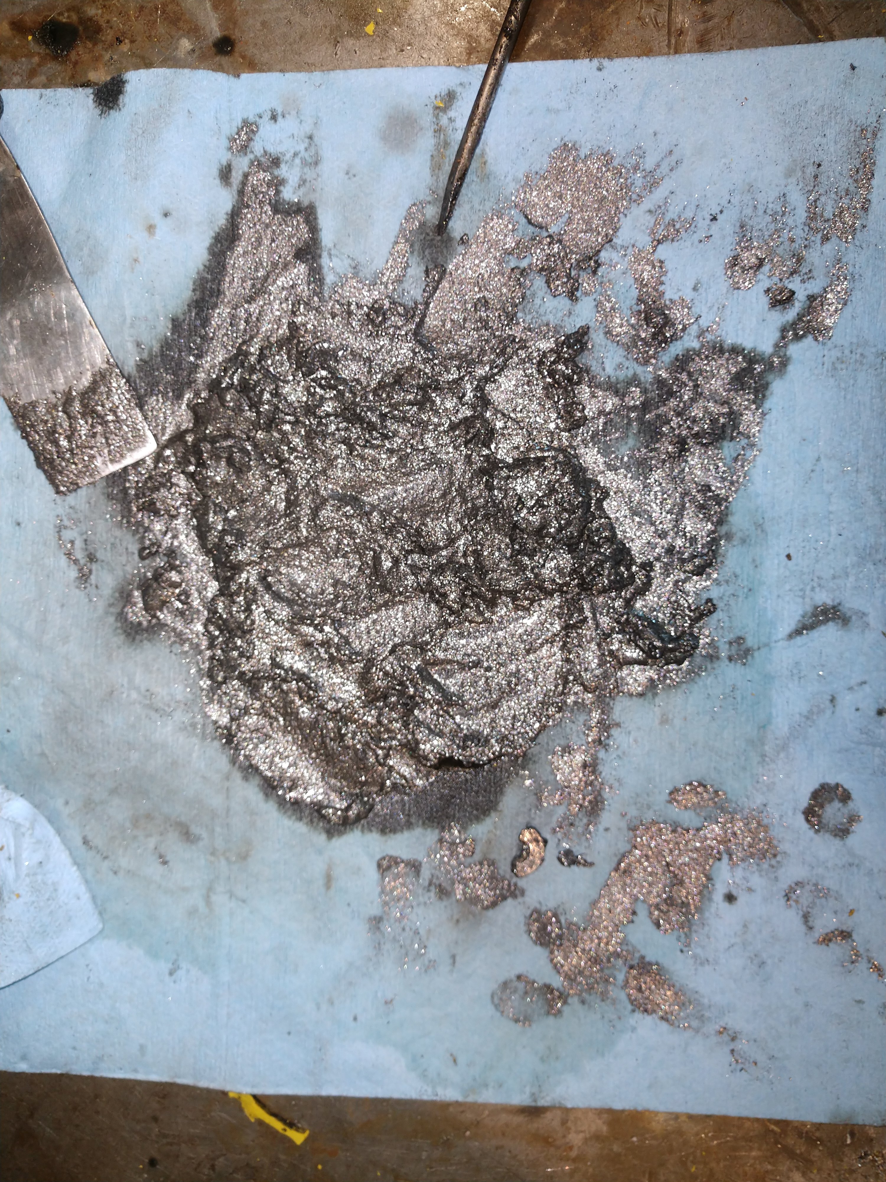

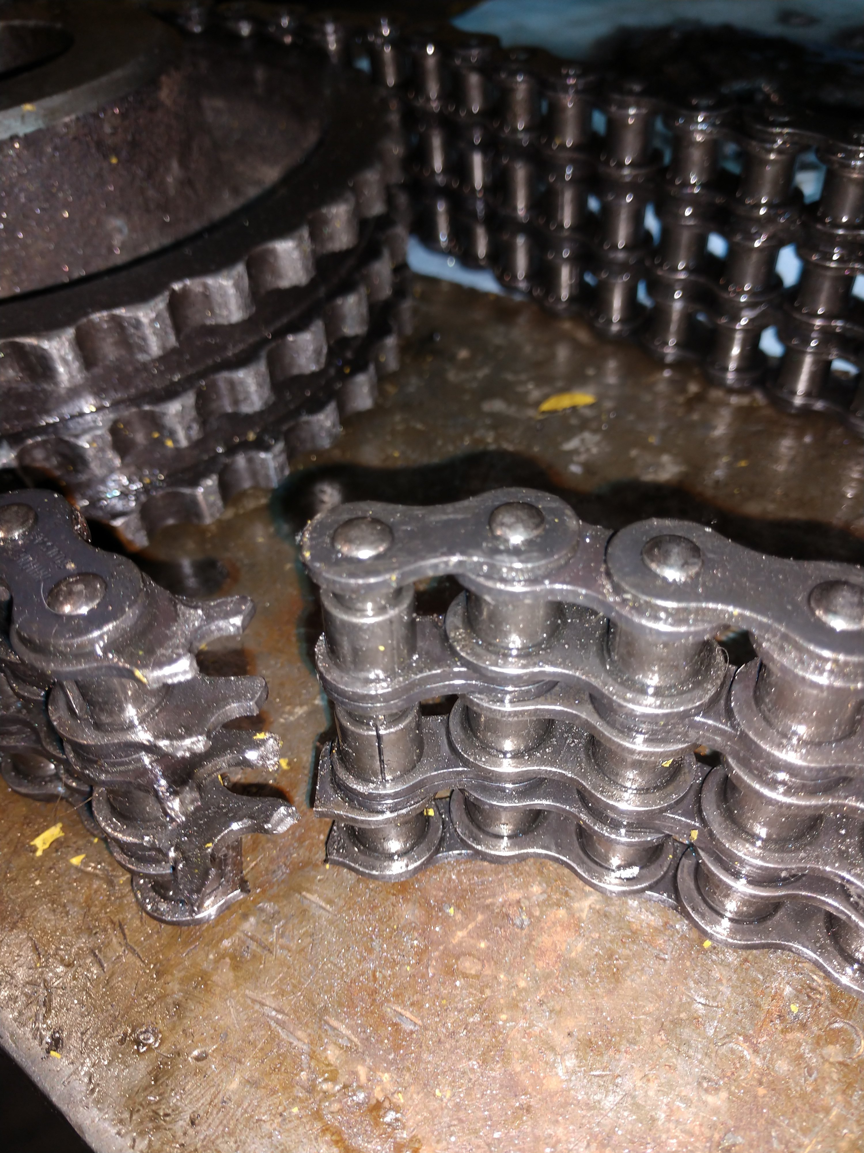

Frandee transfer case update. Fully disassembled now. Drive sprocket is in fair condition but will be replaced. It is steel and will be replaced with a steel one with hardened teeth. Driven sprocket is toast, teeth are gone and rounded out. This was made of gray cast, probably why it failed, it will be replaced with a steel sprocket. Chain had at least 5 broken links, and was just skipping over the driven sprocket, that was the popping sound we heard. Chain had split rollers, it will be replaced with a chain that has solid rollers and a higher strength. Case was full of gunk which is the cast teeth that were ground off over time mixed with gear lube, there were also a few chunks of teeth and chain. Found all the replacement parts needed. All parts are ordered, sprockets come with a small bore that will have to be bored out to fit the shafts and keyways installed, machinist is on line and ready to go when the parts get here later this week. Should have the Frandee back on her tracks late next week. Very excited here in Idaho, I thought it was going to be much worse than this.

How do you tension the chain ?

There is an idler wheel that pushes up against the chain, it is adjusted external to the case with a bolt that pushes it into the chain inside. I may have had the chain to loose, I need to research and find out how much play should be in this chain. I may have had 3/8 to 1/2 inch of play, not sure, but some.
The Frandee 37 is all repaired and back on her tracks after the failed transfer case at Salt Creek Summit. Taking it out in a couple days to put it through the paces, seat the drive chain, and retension as necessary. A special thanks goes out to Rock'n BK for helping me get out of the mountains and loaded onto the trailer after the failure (y)(y)(y).

That's great, did you have to custom make any replacement parts?
