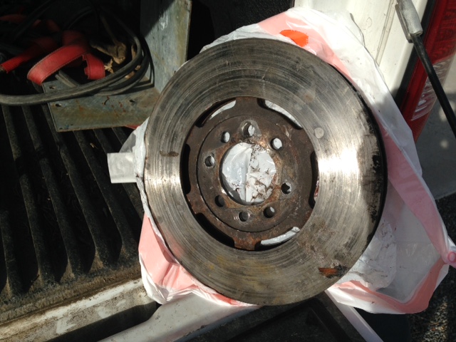

Greetings,
Sheared all the bolts for the driveline disc connection from the transfercase to the differential. Any ideas on where I can find a replacement driveline disc? Looks like the through holes got a little banged up when the shaft came loose. Don't know if I can flatten it out and reuse it?
Reconnected the shaft without the disc so I could run the cat, but would like to put it back together for safety. None of the local auto parts stores were helpful, closest place is 3 hours away.

That is where we might be headed, hard to believe it has not been simple process. fingers crossed, a little tricky driving without the brake.
Joe
Thanks Jim,
That is where we are headed next, just worried about getting it flush and the amount of torque on that part. Have some guys at the Caltrans yard who are pretty handy looking at it.
Joe
