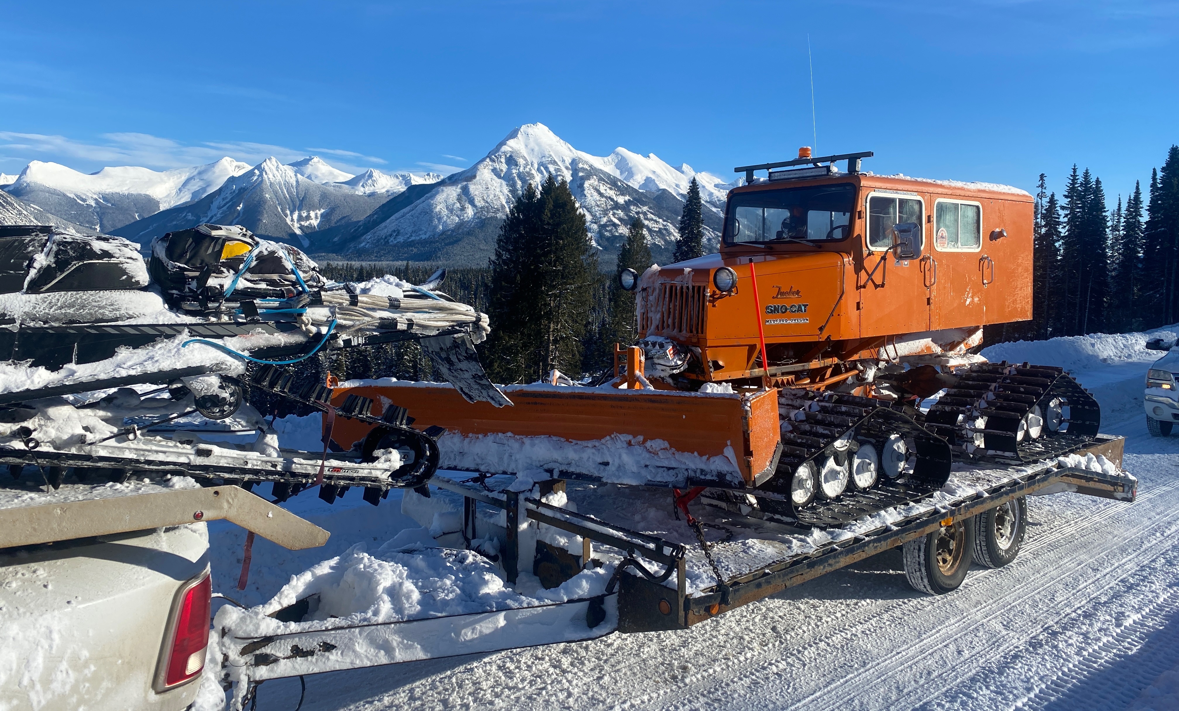

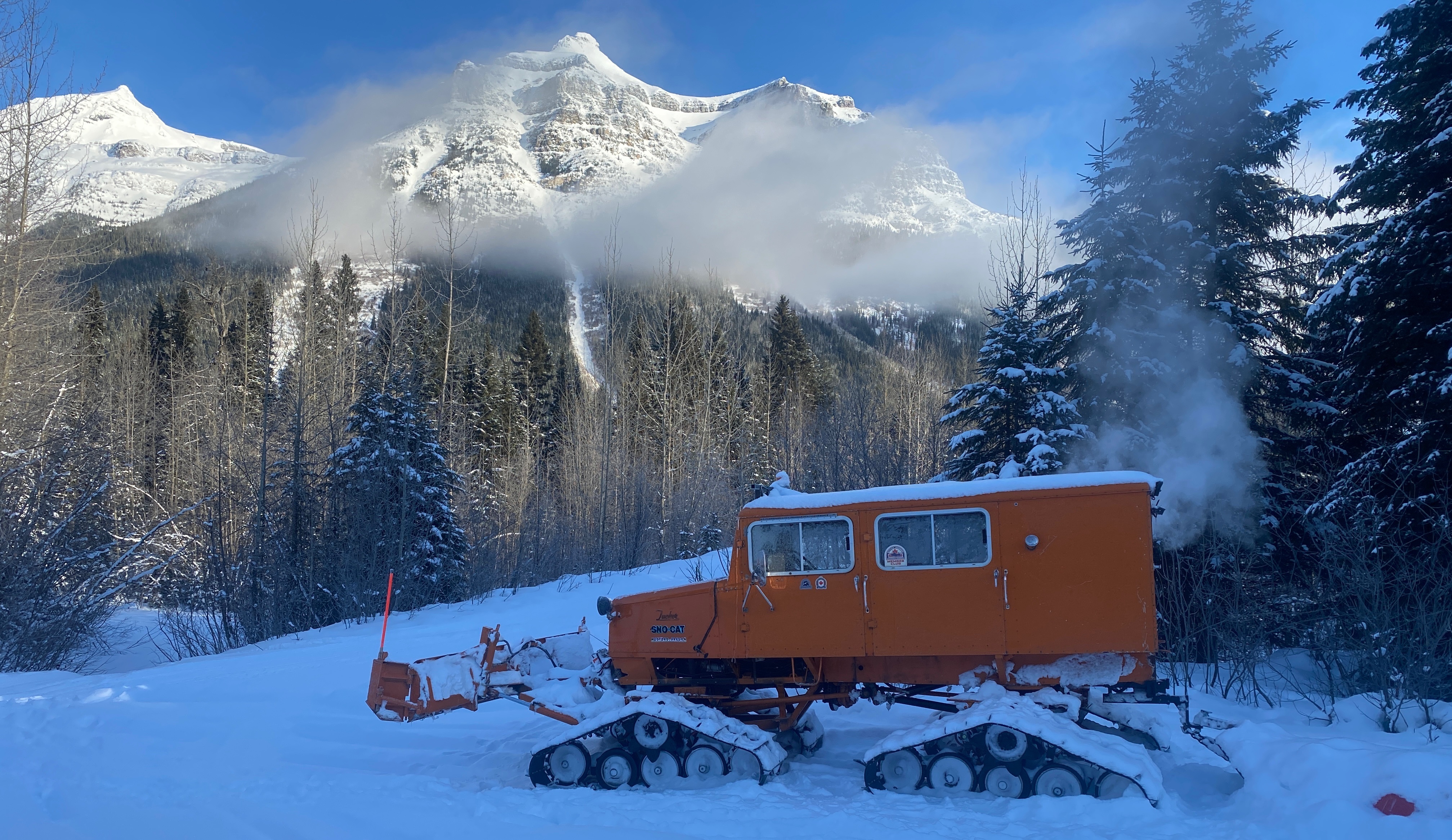

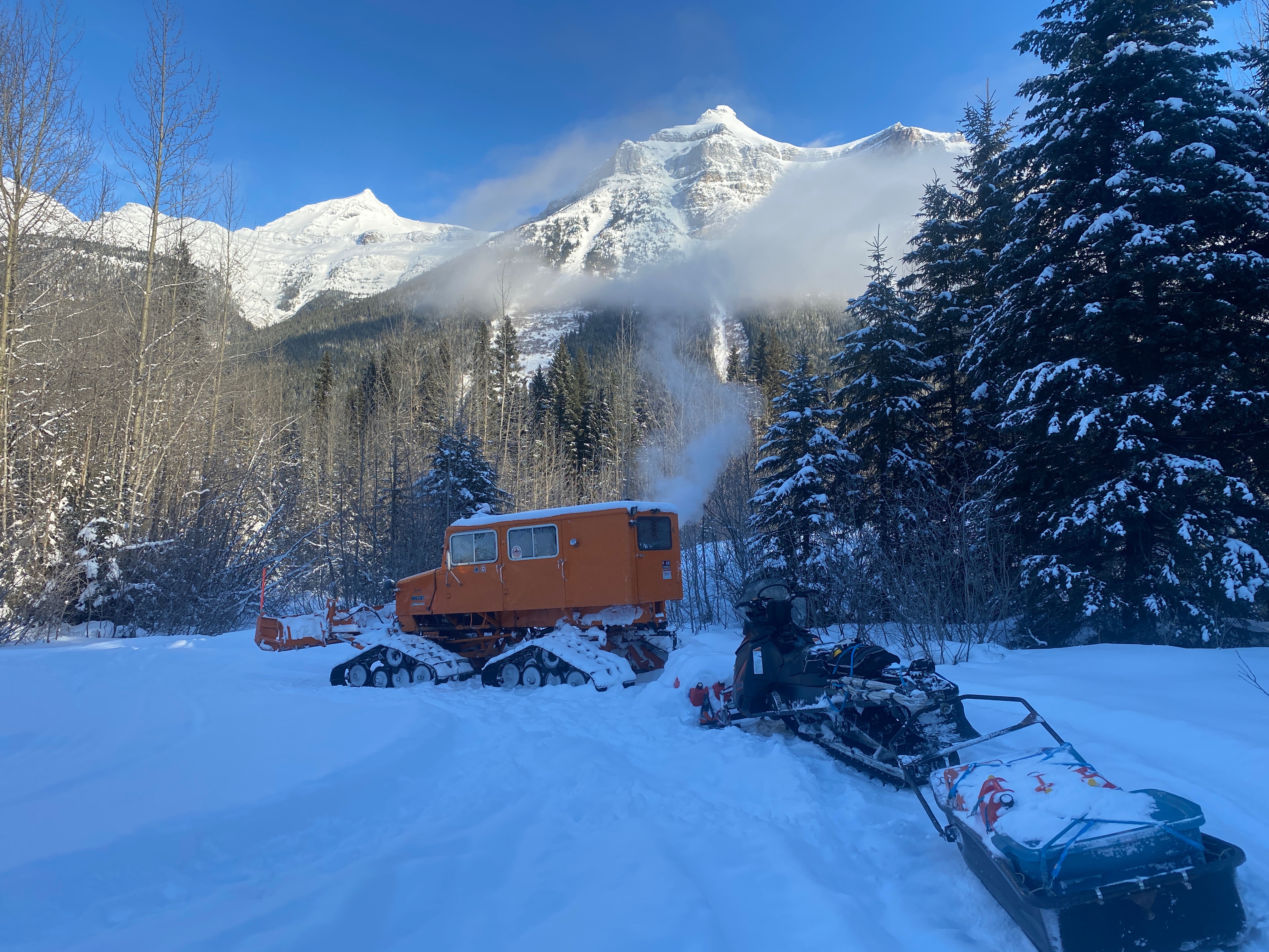

Took my Tucker out to the mountains on Wednesday and back to the truck on Sunday. I take the Tucker in 22 kms and leave it there and go the rest of the way by snowmobile as the trail past that point is not frozen in good enough yet.
After sitting for 5 days at -10c the Tucker started okay and headed back to the truck and trailer. I had to boost my truck with the Tucker though.
I noticed the air/fuel was hunting a bit in the Tucker so I think it was the snow dust melting and getting the air filter wet. I don’t think a paper filter like I have is the best idea.
I’m open to suggestions on what other people have for air filter ideas.

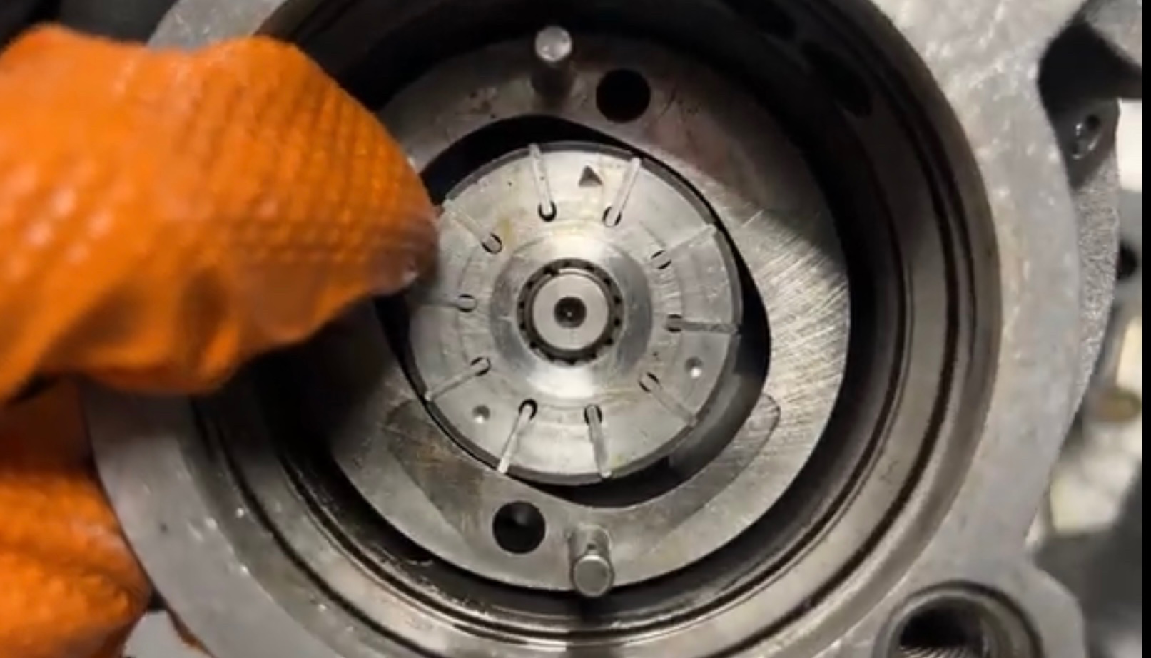

The inside of the Dodge is a vane pump same as the Vickers.

The picture I had of the inside and vanes of the Dodge pump kind of suggest it "might" provide half the output of the Vickers.......

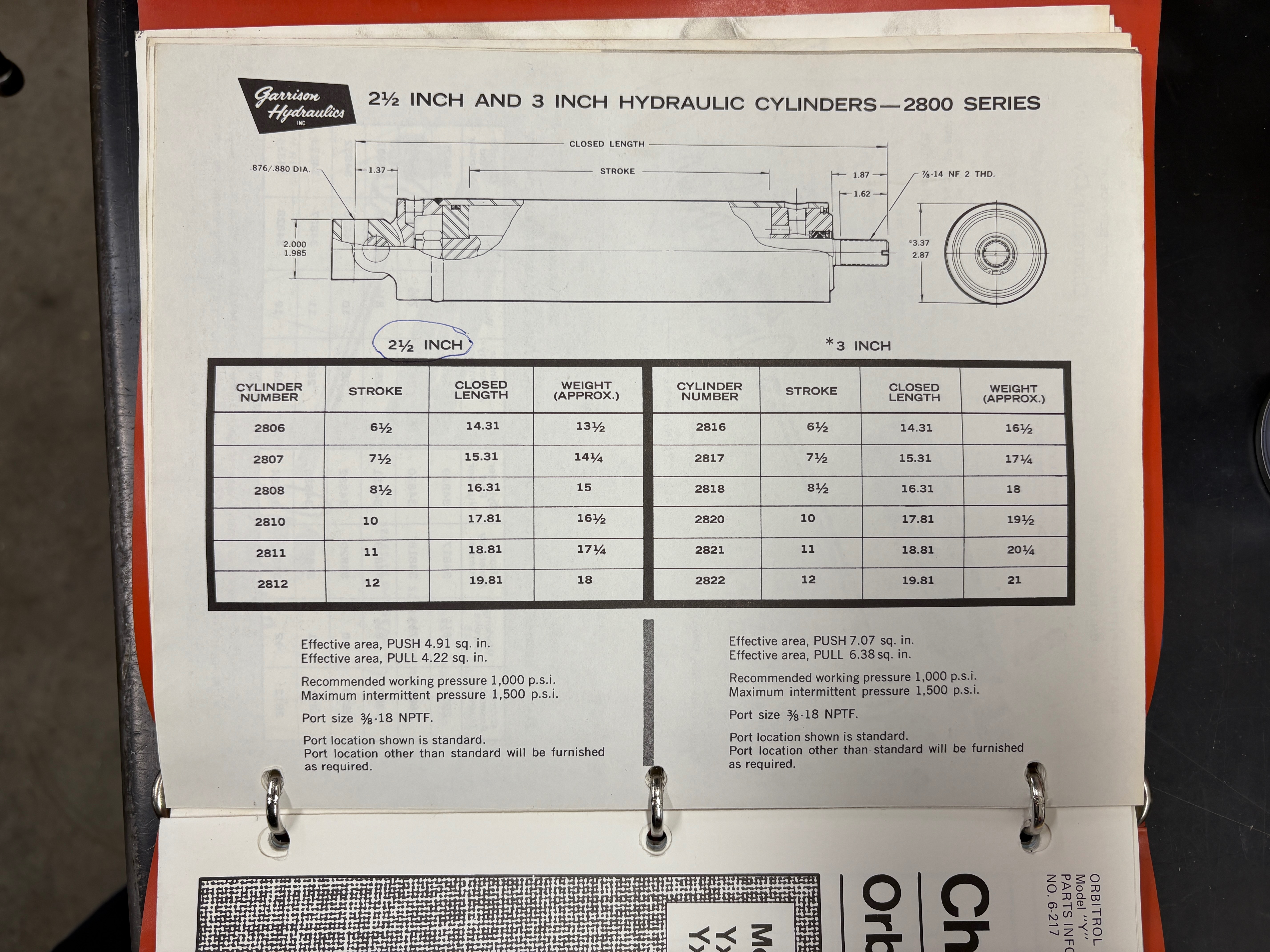

I dug out the books and relics that came with my Tucker to see what information there might be on the steering and the pump.
It says the steering ram runs at 1,000 to 1,500 psi.
Then found
