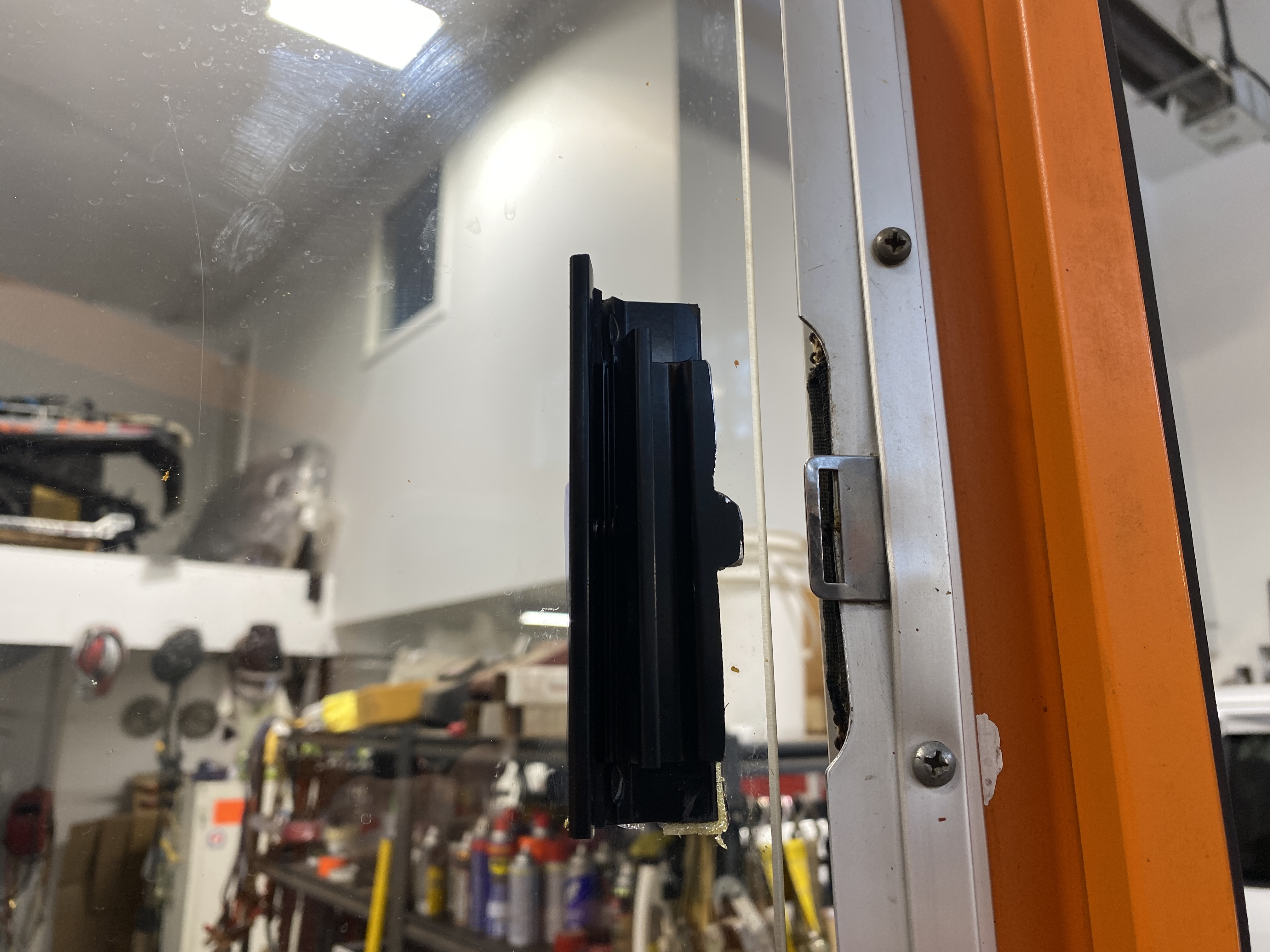

YamaDooPolCa, where did you find window latches at? I've been snooping around and no luck, not that my window dowels are that un-sightly!!!
I ordered these from Tucker. I then modified the latch point to hook the exiting part in the window frame instead of using the newer latch.
I added some Gorilla Glue to the self adhesive hopefully for extra strength.
Happy so far.

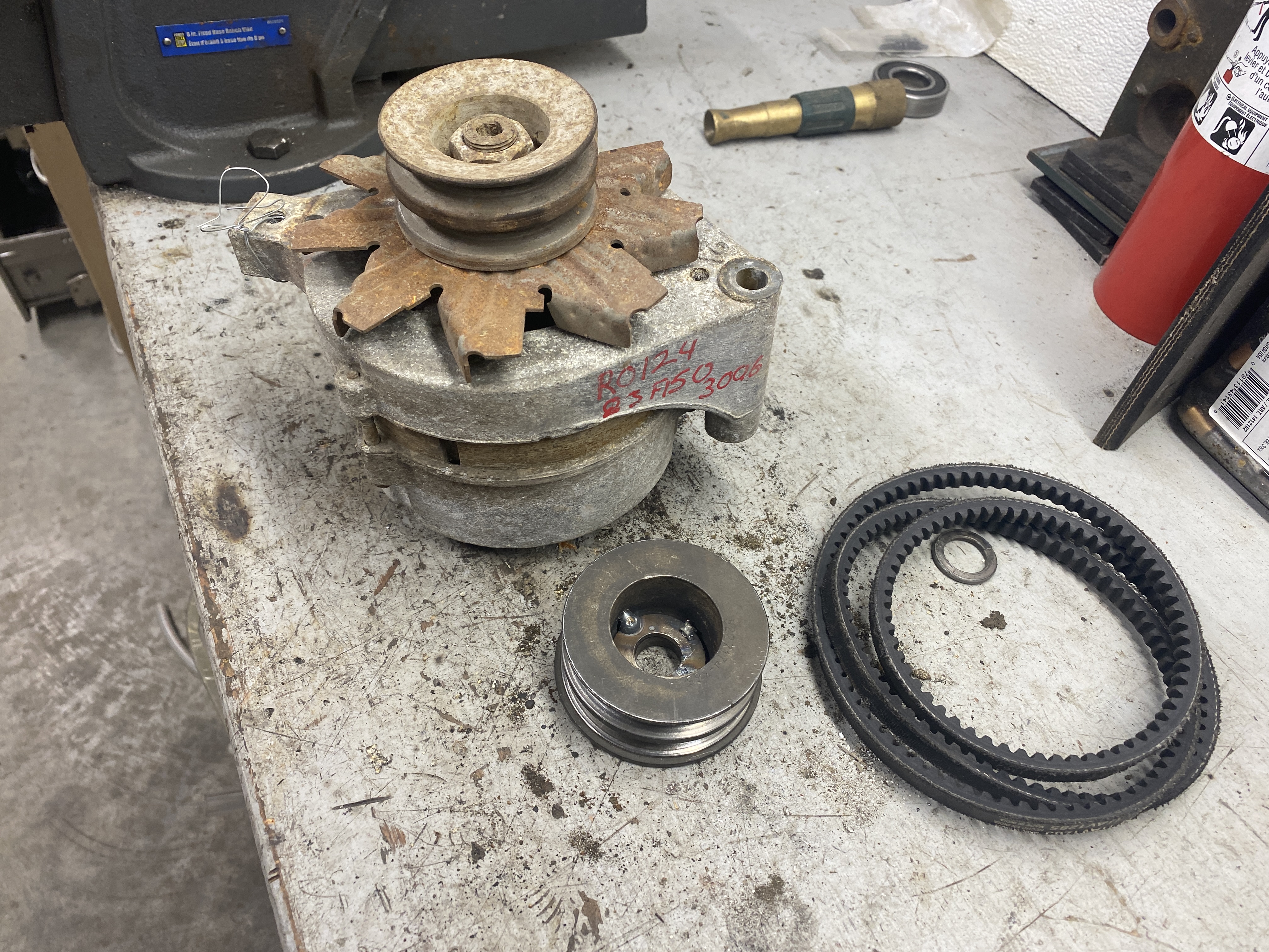

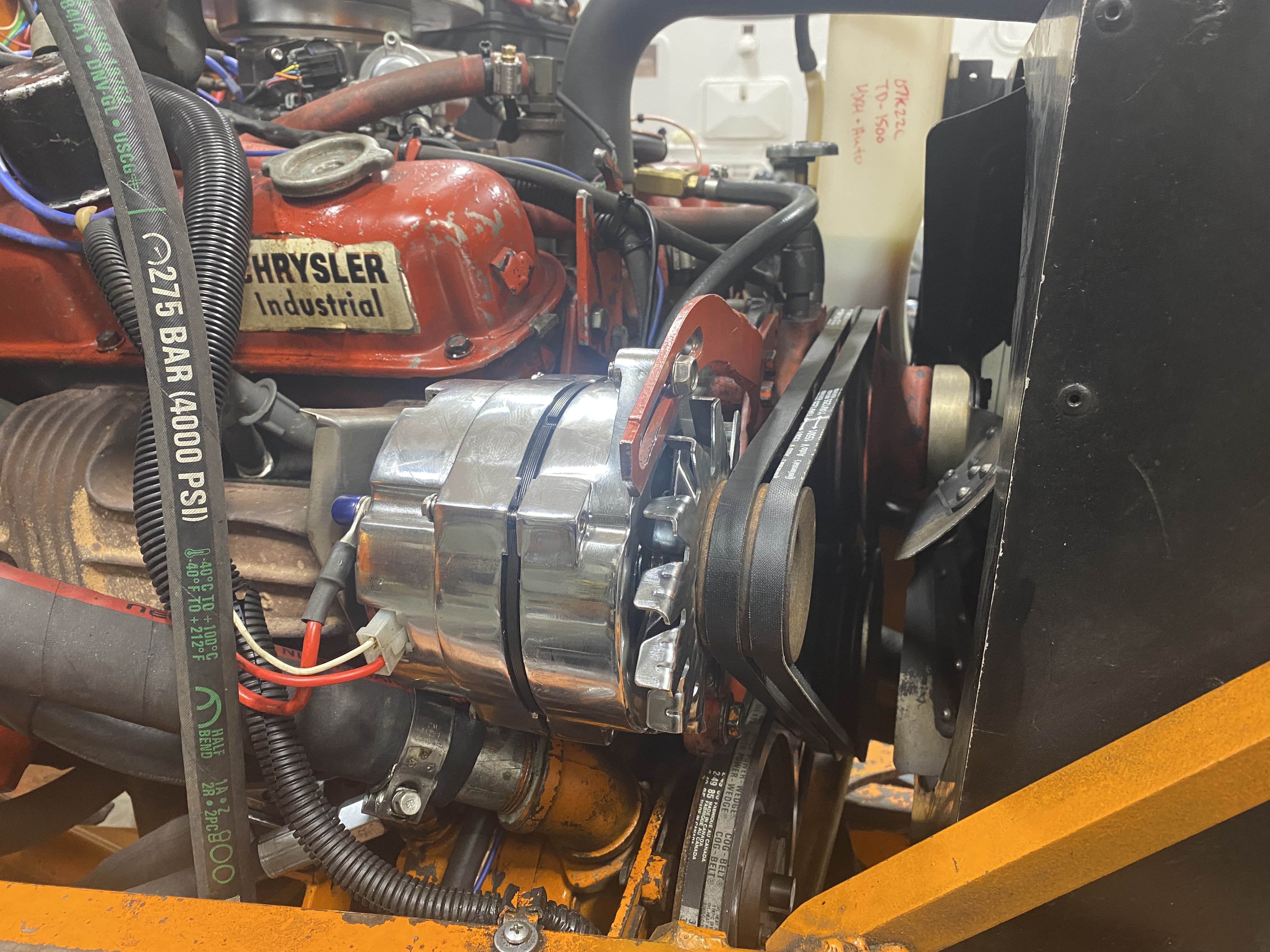

The original twin pulley Dodge alternator is a press fit so I have to find a bolt on pulley for the 3 wire GM alternator.
The pulley I found was solid steel with very little bore thickness. So between high mass and thin bore I had trouble clamping the pulley down on to the alternator shaft, and it spun.
Back to my boneyard and found a single pulley for the weekend trip. The wreckers are closed.
The single belt pulley is not enough for a 100 amp alternator and when I took the replacement belt off in my shop, it was obviously starting to fail as well.
Luckily one of the local wreckers had some old V belt pulley alternators still, and had a 1982 F150 dual pulley alternator. Those pulleys fit the GM 3 wire alternators.
So lucky to find this alternator for parts.

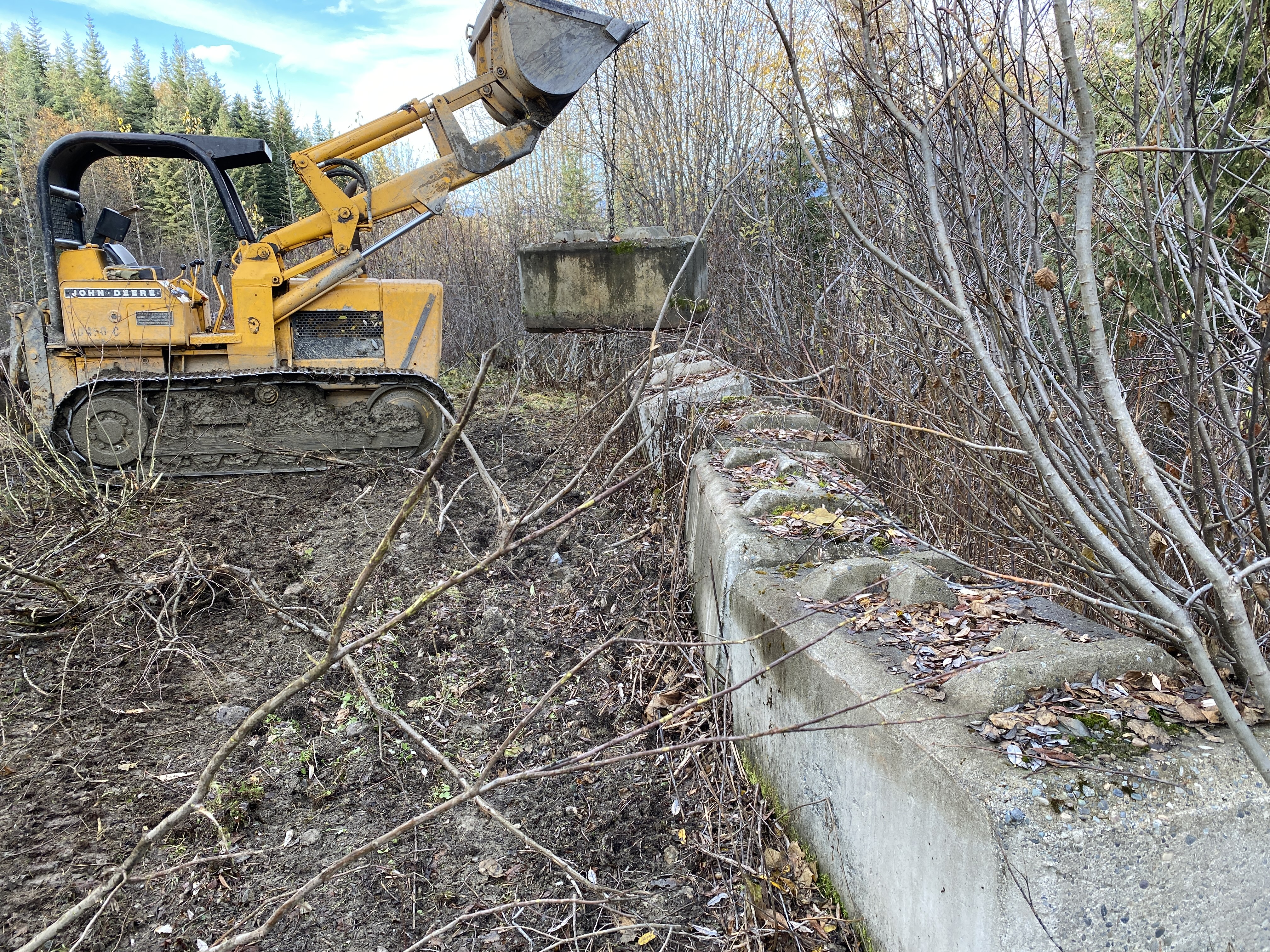

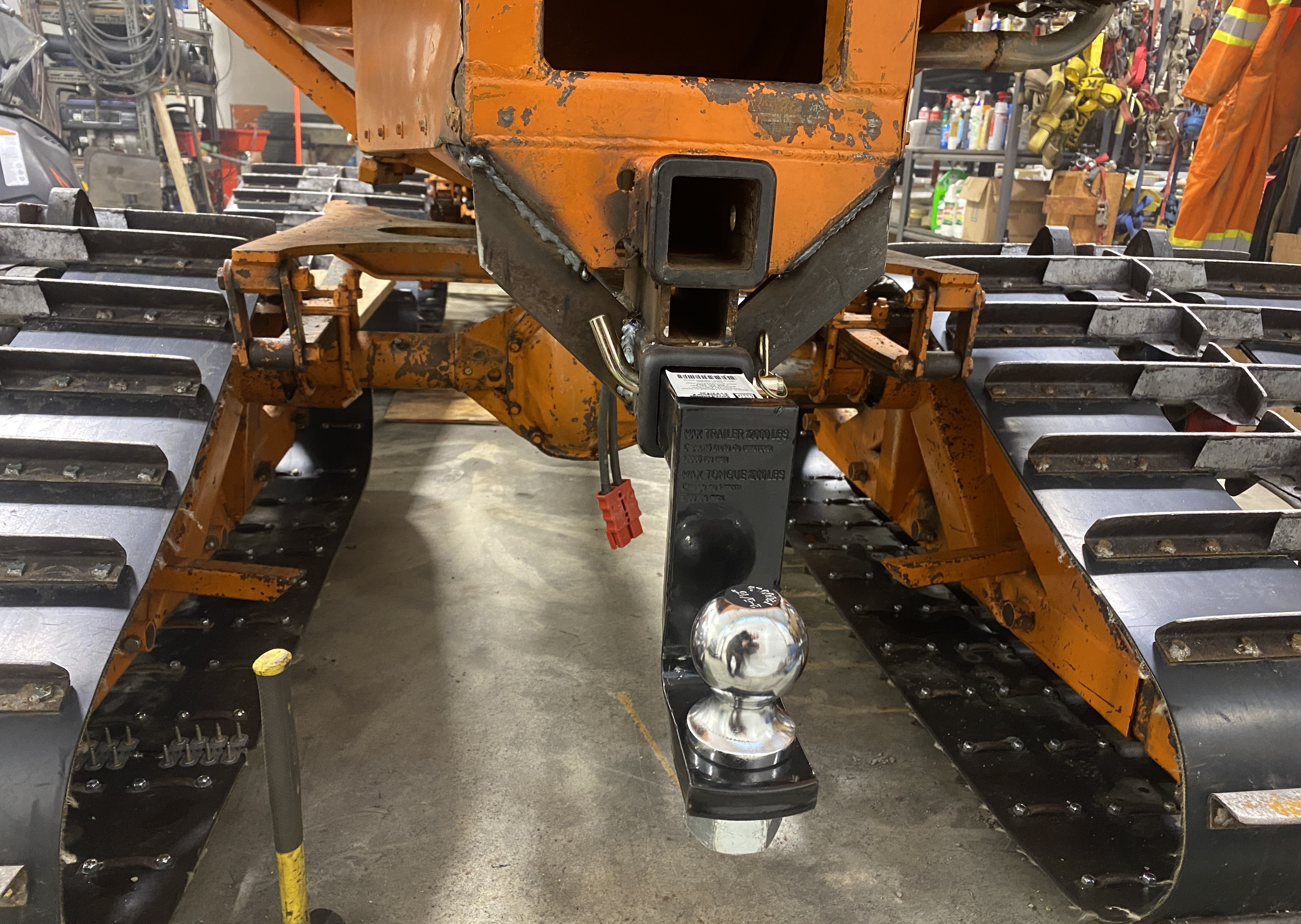

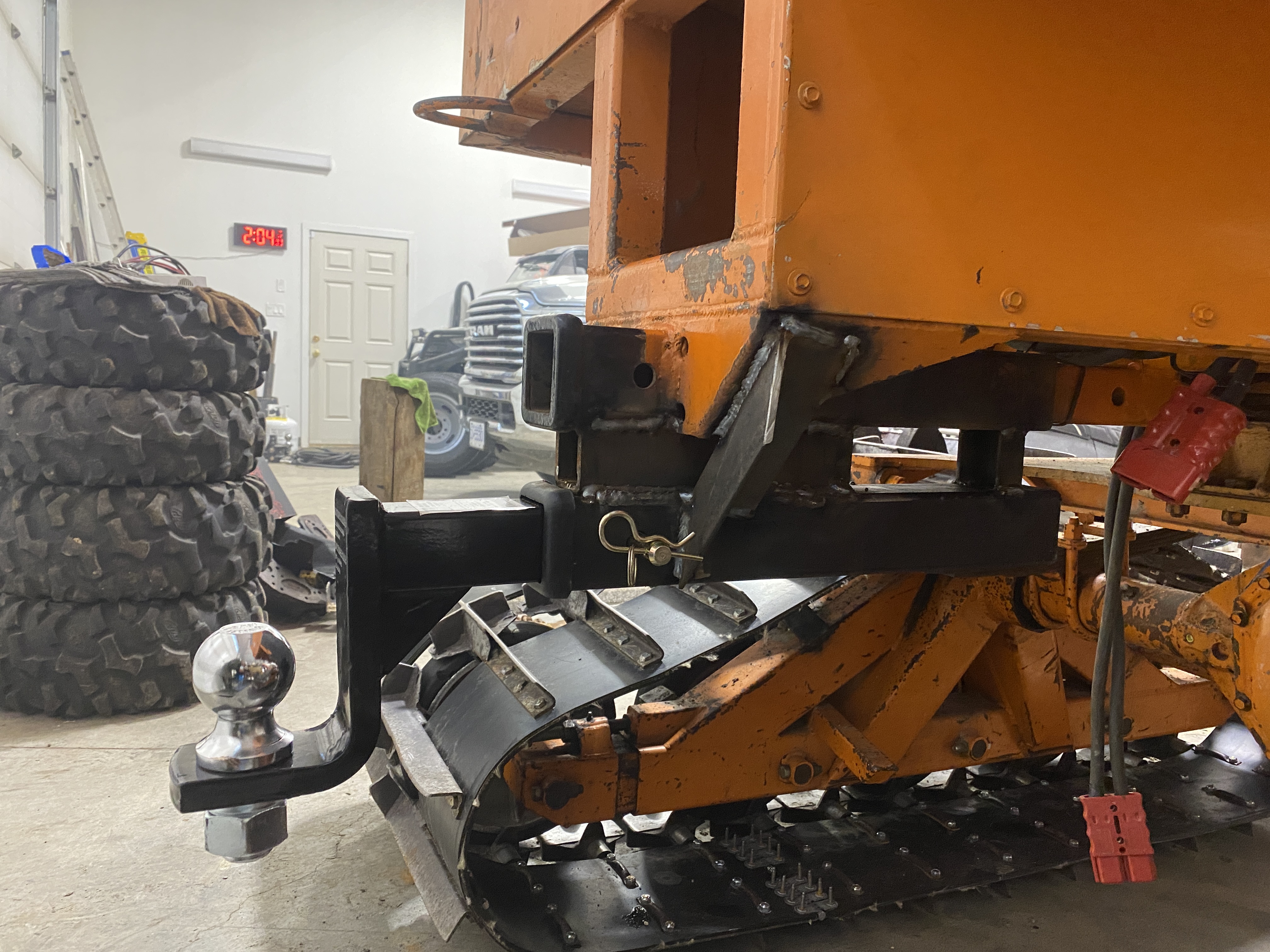

This winter I’m going haul some 4,200 lb concrete blocks on a sled so I decided to upgrade the lower receiver to a proper tube. The upper receiver holds the 12,000 lb winch.
I friend gave me some exhaust wrap by Ledaut Co. It is held in place with CV style locking bands. Hopefully this keeps the heat in the tube.
I hope someone can help with a task I’m doing this winter.
I have to move 6 concrete blocks about 12 miles each weighing 4,200 for bridge abutments.
No equipment around except me and my Tucker, and whatever I can drag in to help.
Our club has a 13’ trailer good for 12,000lbs on skis. Deck height is 3’ off the ground.
Right now I’m thinking gin pole the trailer.
Rough sketch.
Anyone have a calculation on how tough the poles have to be?
I can try to rough out a calculation, but it is going to be pretty big. the buckling force on the pole at 16ft is big. Do you need to set them in place using the gin pole? if not I'd look at a ramp, pipes and the winch.
Okay. It might be tough to wiggle the blocks up skids on to the wooden deck with the snow conditions, and even tougher to skid the blocks off the deck.
I don’t have to place the concrete blocks.
The bending force of sliding up these heavy blocks will require a substantial ramp for me to wiggle into position and set up.
There is no plowed road access. I drive the Tucker 55km to get to the blocks, and then load and haul each block one at a time another 20 km to unload site.
