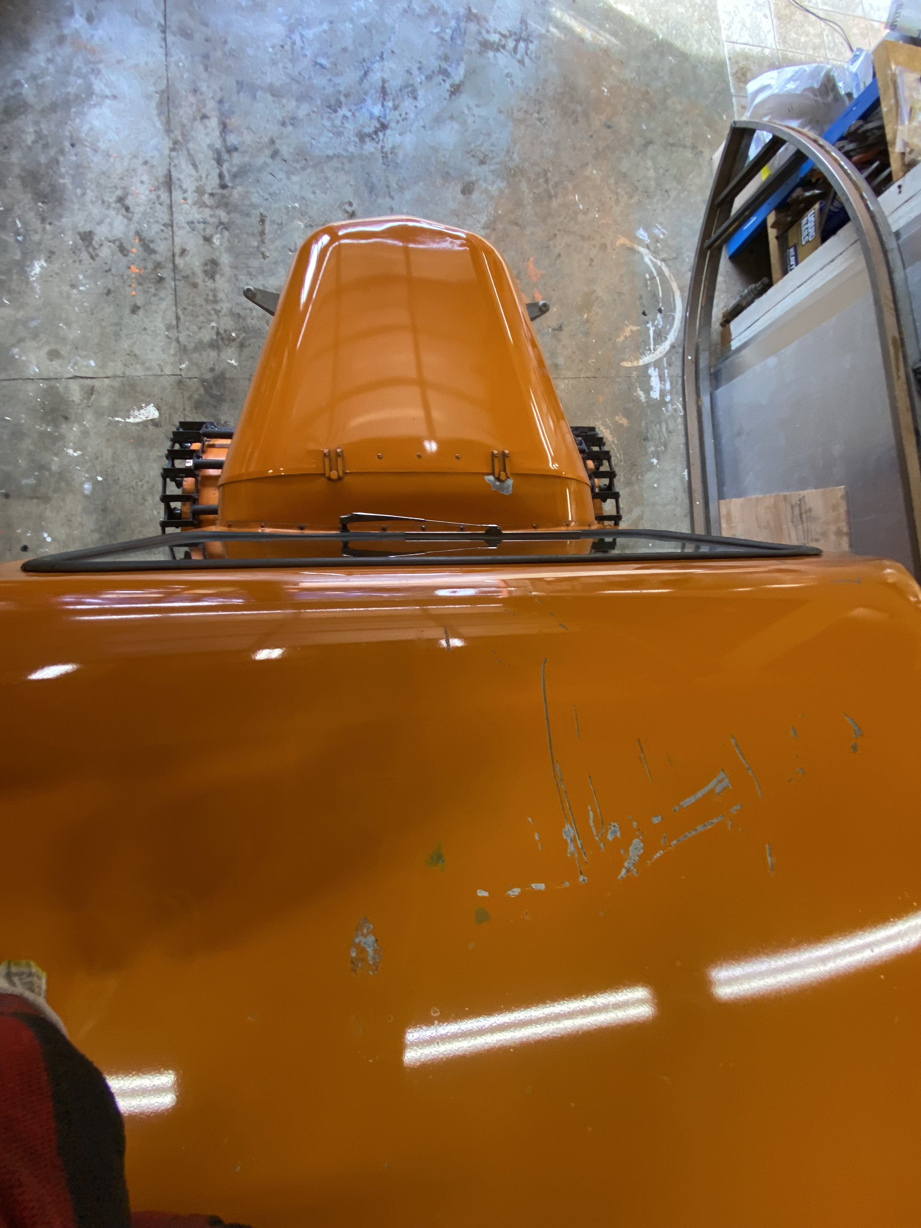

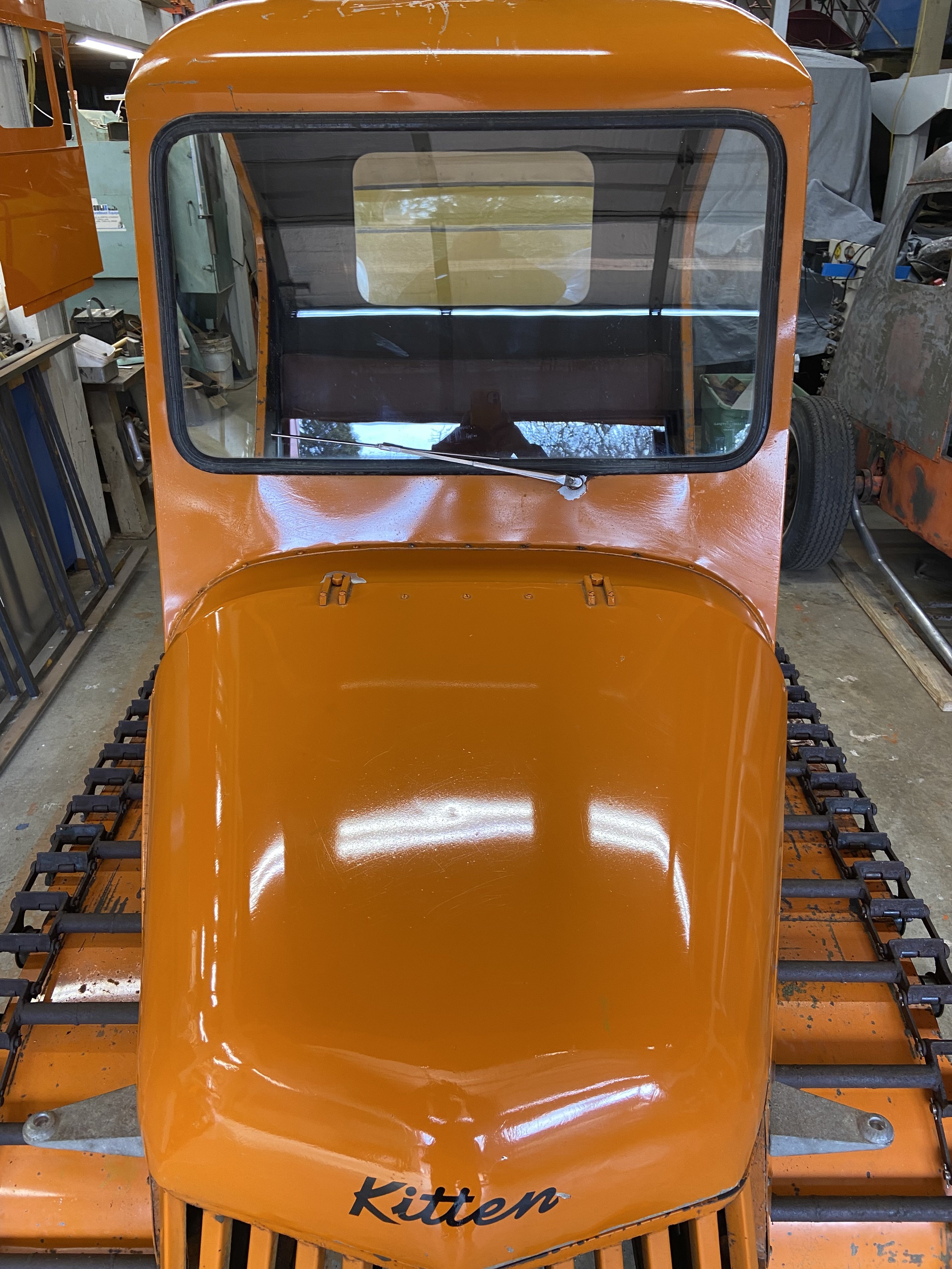

195? Tucker Sno Kitten, model 221, "Little Basturd"
got the recored radiator back today, nicely done, ready to put back in, getting closer
little detail, the gear shift knob, originally came form the Model A Ford in 1928 and was used in the Anglia Fords through the 60's, Little Busturd's was gone when I got the kitten, so, went up stairs and grabbed one from my model A parts shelf

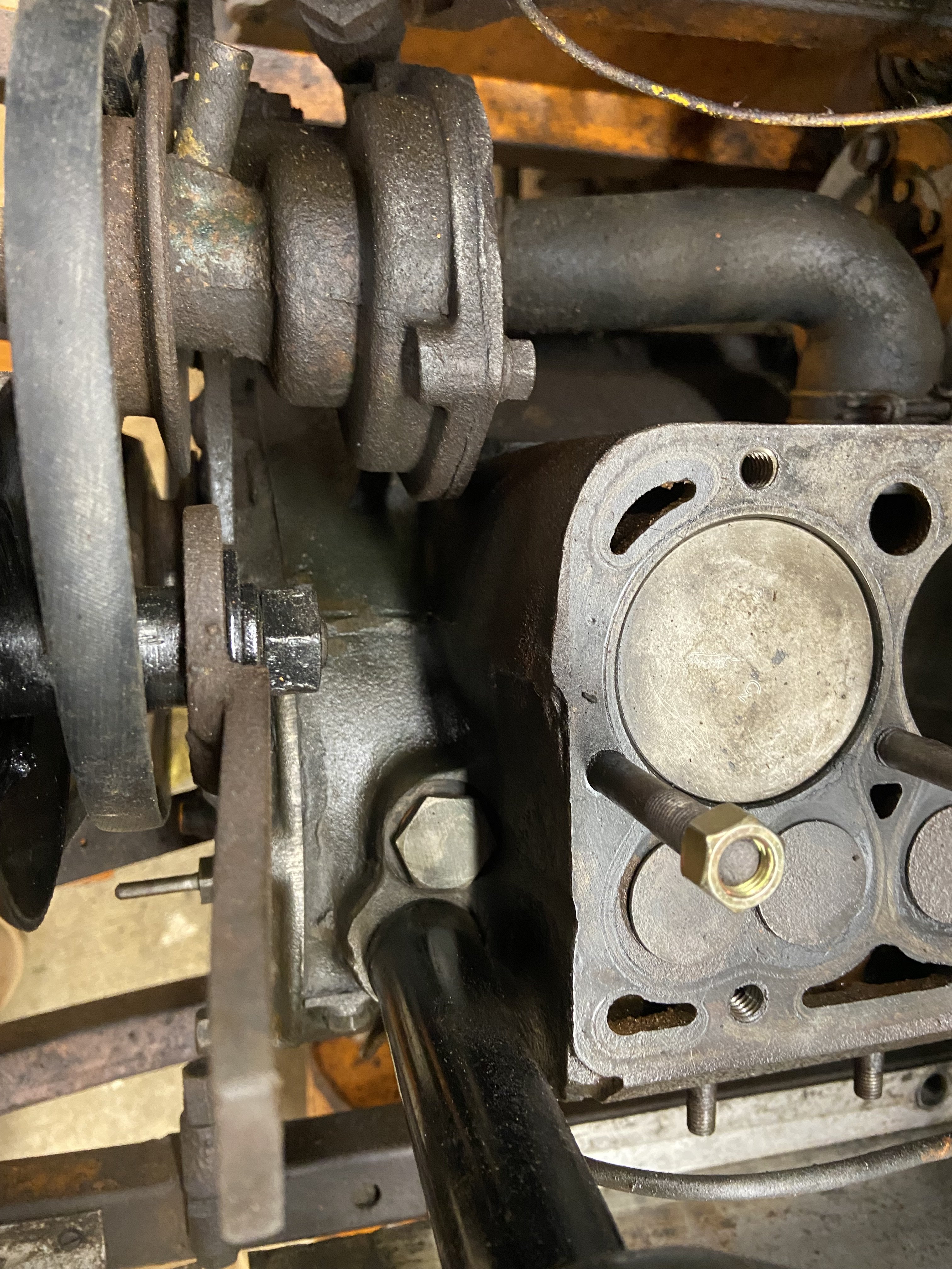

new exhaust, straight pipe, no muffler was never used on a kitten, bent up and installed, even was able to use the original manifold to pipe clamps, they are an exact copy of Model A exhaust pipe clamps, the rear of the exhaust pipe fit right up into the original rear mount. good day in little basturd land
