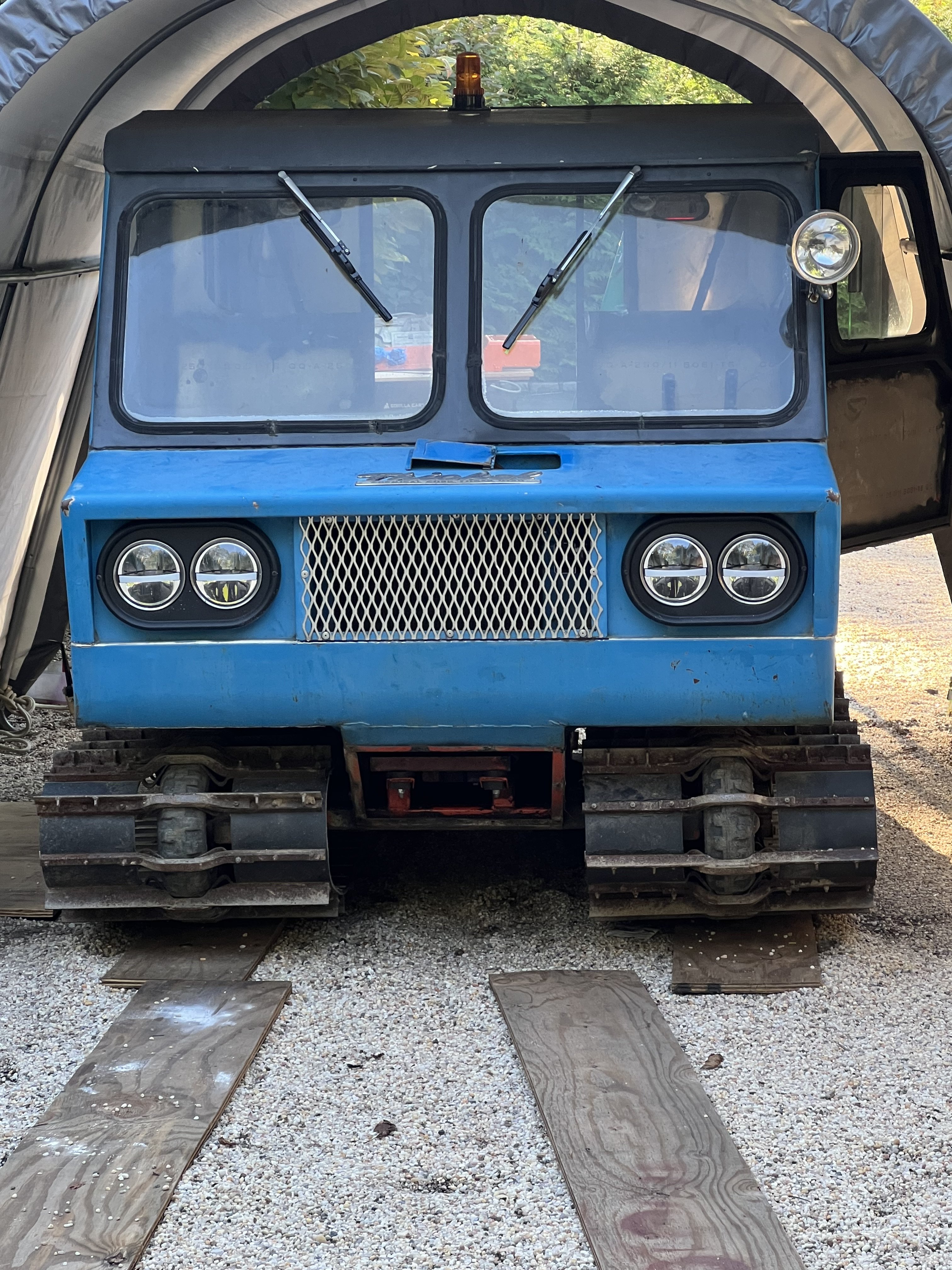

WTB - Looking for an enthusiast/mechanic ideally located within 100 miles of central Vermont (Ludlow, VT 05149) for top to bottom inspection and service of 1967 Thiokol Imp to get it ready for this winter season- change all idler wheels, repack hubs, open differential and inspect, replace brake bands if required, change all fluids and grease all joints, replace radiator hoses, new spark plugs, tune V-4 engine, confirm operation and condition of brake masters and slaves, water pump, alternator, and fuel pump etc.

Thank you. You are exactly right. New acquisition and the Imp will be in a very isolated area and if (when) it breaks down durning the winter recovery not be possible till springtime. I am looking for someone local as my shop is 500 miles away and I looking to avoid the 1,000 mile roundtrip tow.
