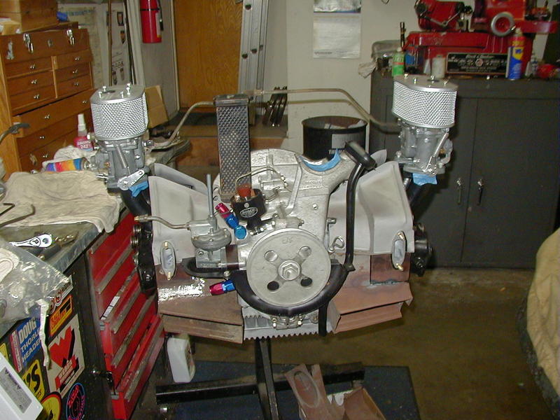

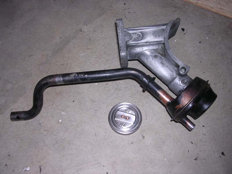

You can spot a 36 HP a mile away by the pedistal. On a 36 HP it is part of the block. It does not bolt on. The pedistal supports the FAN/Generator and is where you put oil in the engine.

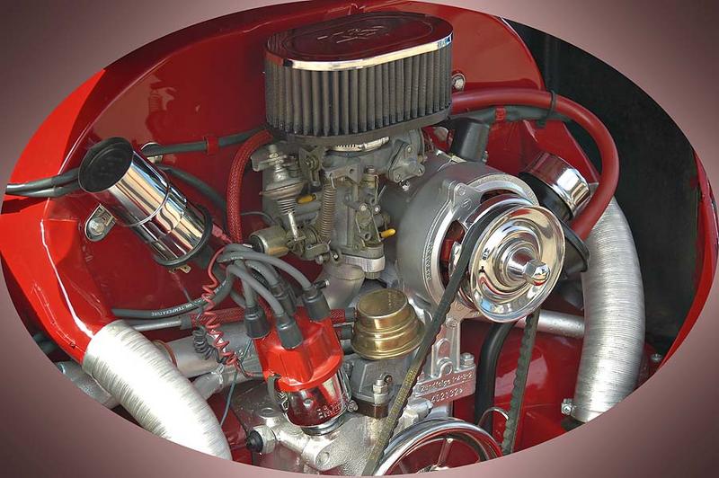

The Pedistal below is for everything after the 36 HP.

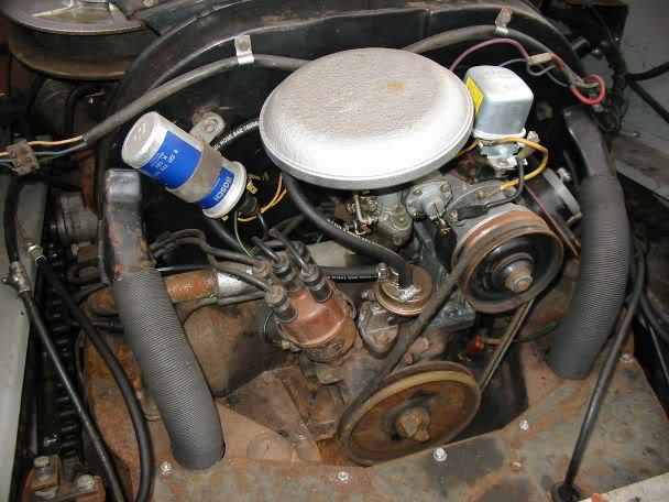

In 1961 they came out with the 40 HP, or 1192 CC. It was produced thru 1965. One to two million a year. Toward the end of production is became "Clean-Air". All Pre-Clean-Air engines had STALE AIR HEAT and their fan housings have no hoses coming out of them.

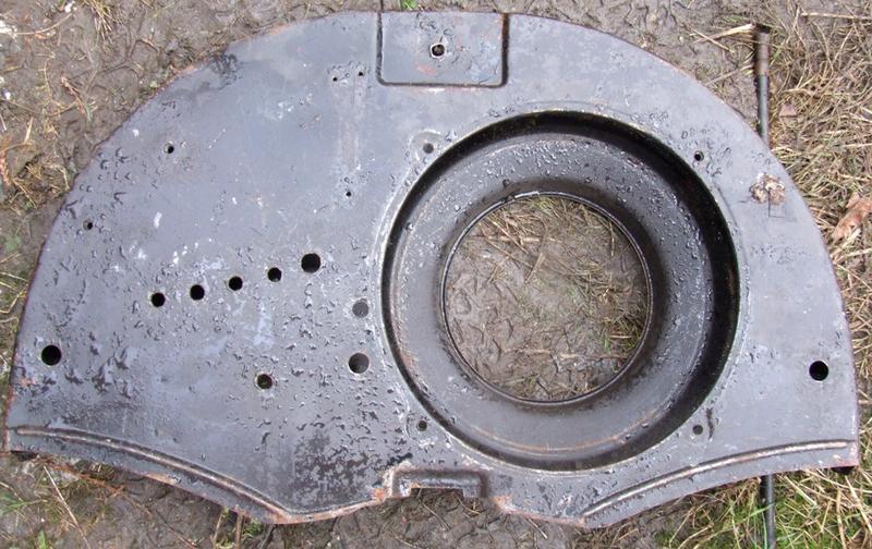

All the Stale air engines have fan housings that look like this:
Stale Air engines took air directly off the engine thru some small sort of excuse for a heat exchanger mounted on the rear of the engine. Oil fumes and burnt bugs and grass also blew right into the heat system.

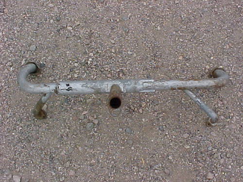

Only the last year of 40 HP is clean air. Clean Air engines have the foil or black foil and paper tube eminating from the front of the fan housing. This air bypassed the engine and went to a real heat exchanger made of aluminum moulded to the front exhaust tubes. It is essential to plug these off if you don't have the tubes in place. Failure to do so reduces air flow to the engine enough to cause overheating.

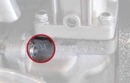

In 1966 they came out with the "1300" and it produced 53 HP. It was also the first year of 12 Volt. 1300's were especially good engines and the cylinders off 1500, and 1600's can be retrofitted to them. From this point on one has to go by the letter designator on the block right below the pedistal. The Serial Number is prefixed by a single or two letters.
From 1968/1969 on they produced the 1600 which ranges from 55 HP to 65 HP. The letter designator for a 1300 is H and they are all covered in the "Idiot Book". What's not covered in John Muir's book is VW Industrial engines. They are 116 of 126 engines have have this preceeding the serial number as well as on the intake manifold.

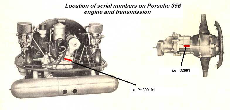

Finally, Last but certainly not least is the Porsche engines. They have a Star, or a Star and a P preceeding the serial number and abundant other features that make them really stick out.
