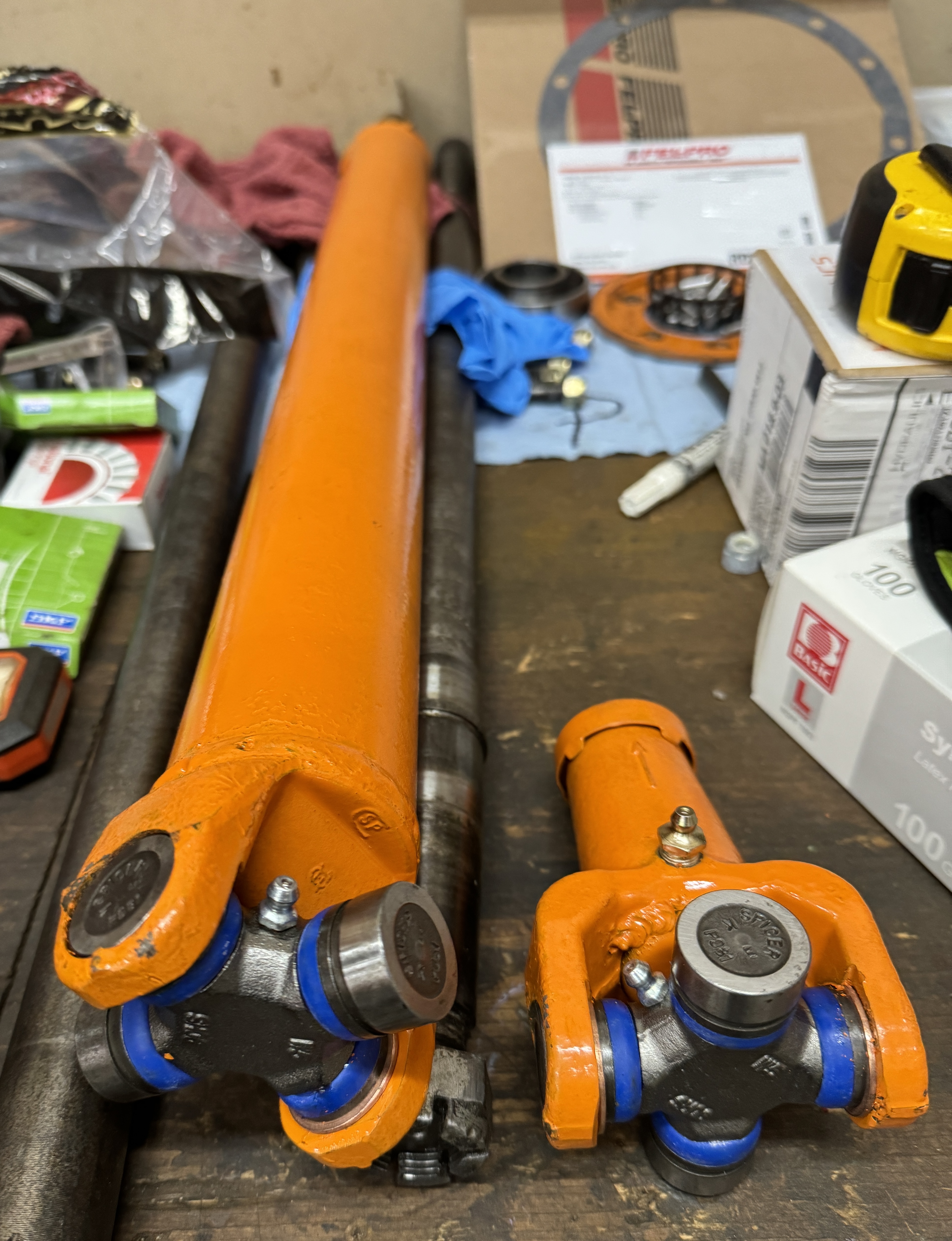

Just curios before I pull them out........Does anyone know the Dana-Spicer P/N for the u-joints on the front and rear drive lines for the Tucker 1342 model?
With yours being 16 years newer than mine, not sure how accurate my info would be . . .
Your '65 is 'probably' the same as my '69. It runs with S55 (1310) driveline parts. My U-Joints were Spicer part number 5-153X
S55 in my 73 1443 just did rear last night.
Summit racing. https://www.summitracing.com/parts/sdh-5-1200x
Don’t forget to time your shafts on install.
