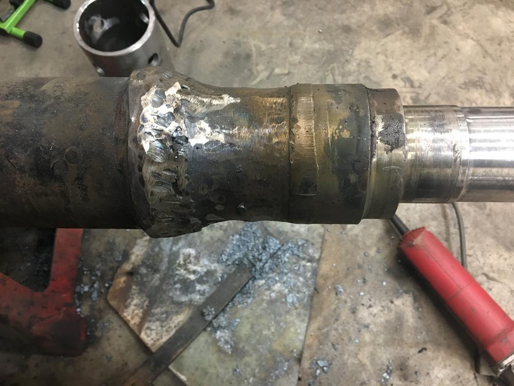

Here is a picture showing wear and the cracks in mine. I ground out the cracks and TIG welded them back up. The journals are welded to a ring that has been welded around the axle tube. I suppose I could have cut the journals off and made new ones and just split them lengthwise with the seams at the 3 and 9 o'clock positions using the existing rings on the axle.
Sounds like this upgrade kit would have worked great for you. Here is what the parts guy said: Hello Brian, I am not familiar with those early differentials, doesn't look like much support but just two collars. The 80's and up to mid 90's had a steel journal welded to the differential which pivoted inside the carrier, we call this a steel on steel journal assembly. Around 1996 Tucker started to use a journal liner that slid into the carrier and was the wear point over the weld on differential journal. You would have to talk with Paul, he is the service manager at Getsno about upgrading your journals. I will attach a picture of the new blue journal liner and a journal upgrade kit we offer which uses thick poly urethane bushings."

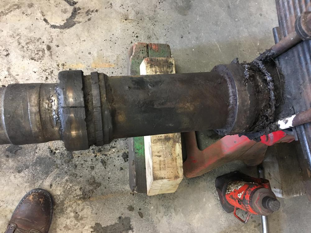

I just did this conversion on my 89 Tucker 2000. The parts for one axle are around $1400.
I can post some pictures if your interested
These are basically showing cutting off the old, test fitting the new and welding in. I don't have a picture of the poly bushing but it looks just like the one posted

Thanks for the pics. Much better idea at what I am getting into. Looks like a great solution for a cat that gets worked. I might have to do a little yankee engineering to take up the slack a bit.
