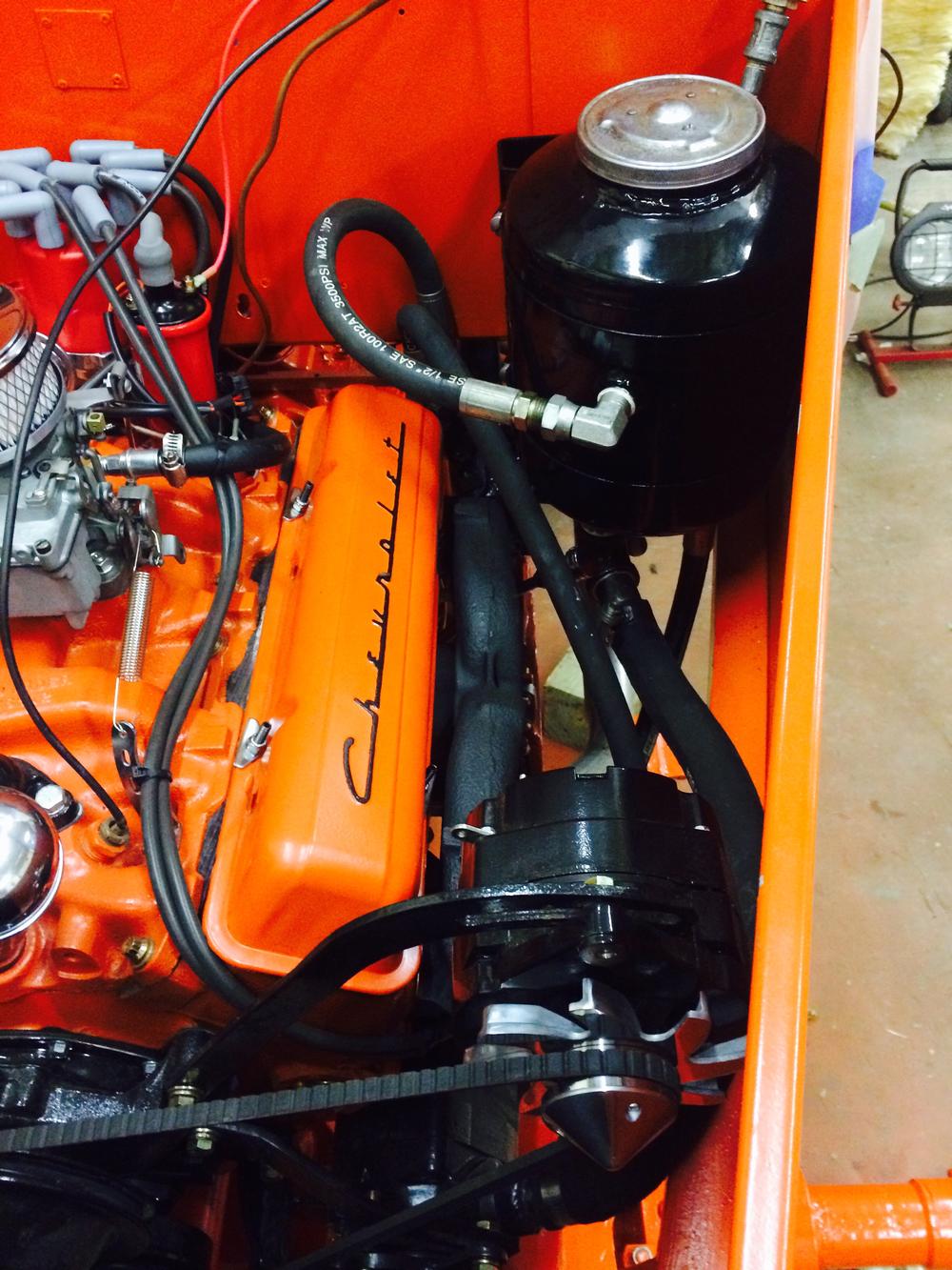

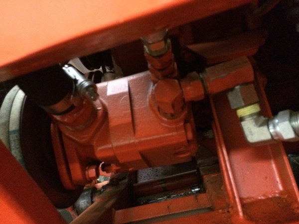

Here are some pics. Will plug the two returns on bottom of tank then thread a nipple onto the front one in picture and hang filter off of that.
Should be neat and clean.

You should have a large diameter (roughly 1 1/4" or 1 1/2") fluid supply line from the reservoir to the pump. You should have a high pressure line from the pump to the steering control valve, and a return line from the steering control valve to the reservoir. There should also be a line returning excess pump output to the reservoir.

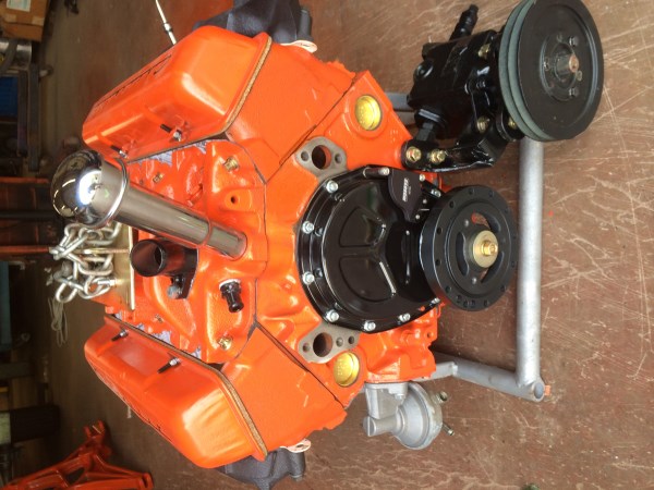

In the second photo you show the hydraulic pump with a two groove "driven" pulley on the front, but no pulleys attached to the front of the harmonic balancer, which would be the "drive" pulley. Tucker sized those pulleys to maintain a mathematical relationship of engine RPM vs pump RPM, and I'd think you would want to maintain that relationship. From memory: the driven pulley is 8" in diameter and the drive pulley is 6". That "underdrives" the pump, meaning the pump RPM is less than the engine RPM. Mathematically, 2,500 pump RPM would equal an engine RPM of 3,333.

The pulleys were not on for the picture but are the original tucker design and the pulley on the pump specs to what is on the build sheet and is original.

Priority is to steering then to tank. Then two out puts from pump to to bottom of tank. Suction is 1" something.
