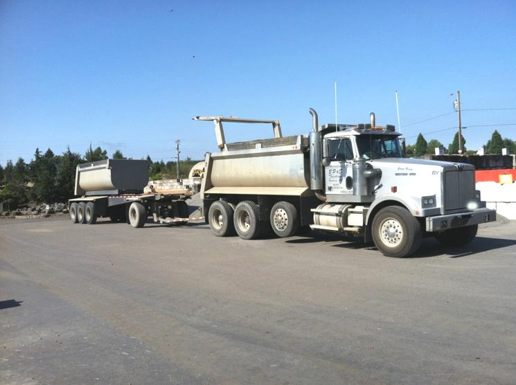

I had air lockers in the 48000 lb Eatons tandems in a Rock hauler (8 AXLE TRANSFER)
MOVING THE RIG IS A GOOD THING.....
Lock the interaxle diffy and lock each axle diffy....It would usually go.... If not.....you were where you should not be.....
Had one job in the snow that I needed to toss on the 3 railers in the back.....AND LOCK EVERYTHING......It went.....Steering was sketchy at times......
With the 18 ton rear tub locked in up front.....plenty of weight on the drivers...
In the snow there will be enough slippage to keep stuff happy and if you don't get BAT CHIT CRAZY....NO WORRIES..
