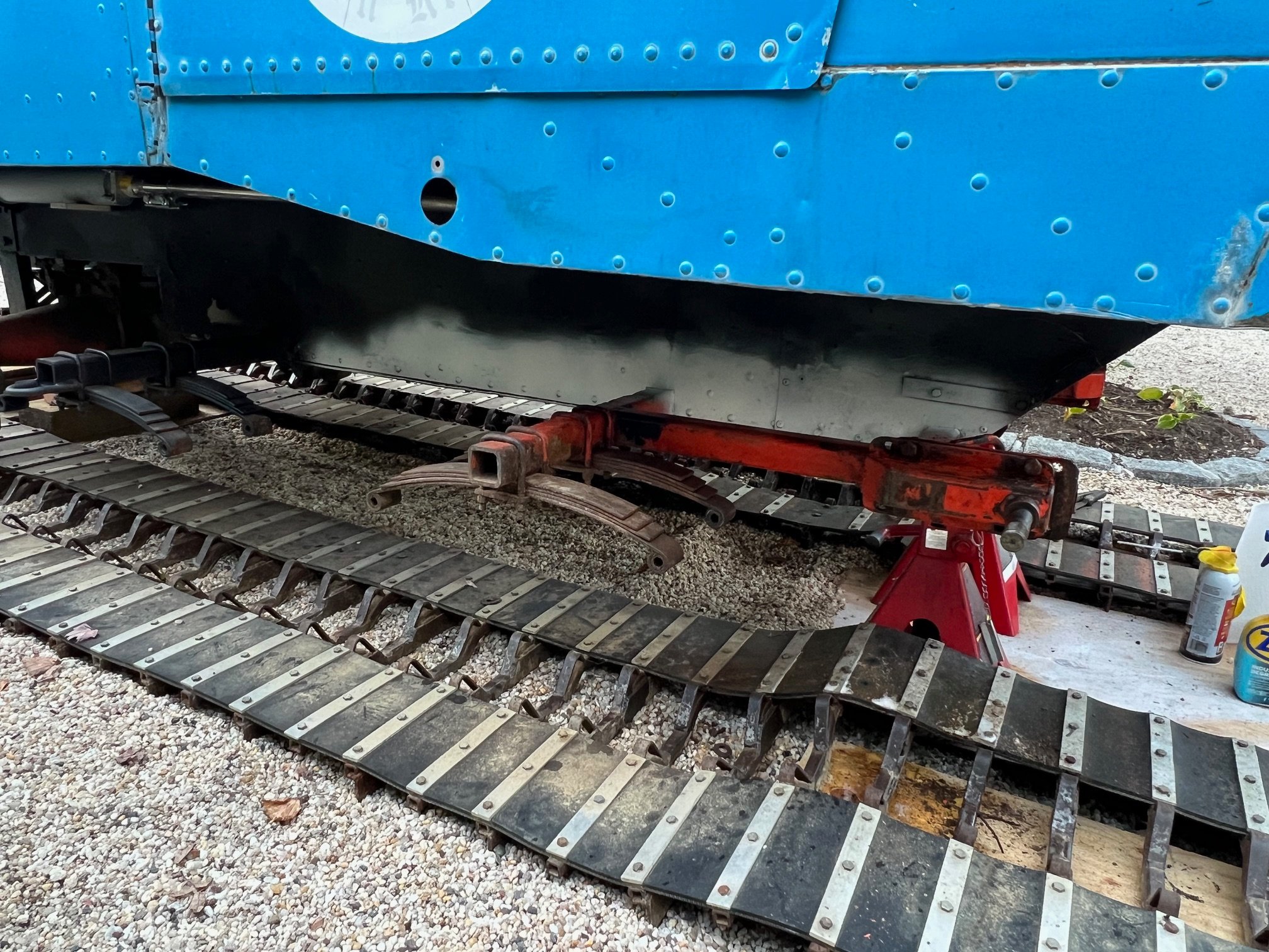

I inspected the frame - all is straight except for the front left strut which bends up 1/4” over its length. Picture attached. Need advise on how significant this is.
The first options I am considering is welding a steel plate diamond to the bottom of the strut to reinforce and prevent any further bending and also shimming the wheel so that it is true to the frame from top to bottom The welding may even pull the member back down a 1/16”.
The other option is to figure out how to straighten the strut using heat and mechanical force. Obviously much more involved and any suggestions on how to straighten are appreciated.
In your experience is the 1/4” bend significant?

The undercarriage of my wide track imp is hammered. My front “axle” tube thing has been tweaked, rewelded apparently more than once. I think the big question is if it throws tracks. My setup runs a urethane front idler vs a pneumatic one on the narrow track version. You may be able to heat and bend or put a bottle jack to it somehow but I think it’s probably ok as is. The tracks are fairly forgiving as they travel around circumferentially.
Good luck and welcome to the insanity. Look forward to seeing your rig!
I'm with Mr Idaho IMP....leave it alone. I would be reluctant to try bending it, but your thought of reinforcing with a steel plate welded on is not a bad idea.

I am going to weld on a reinforcement plate and leave the 1/4” bend in place. I will send pictures.

Imp tracks are back on.... I decided the 1/4" bend in the front axle is ok as is.

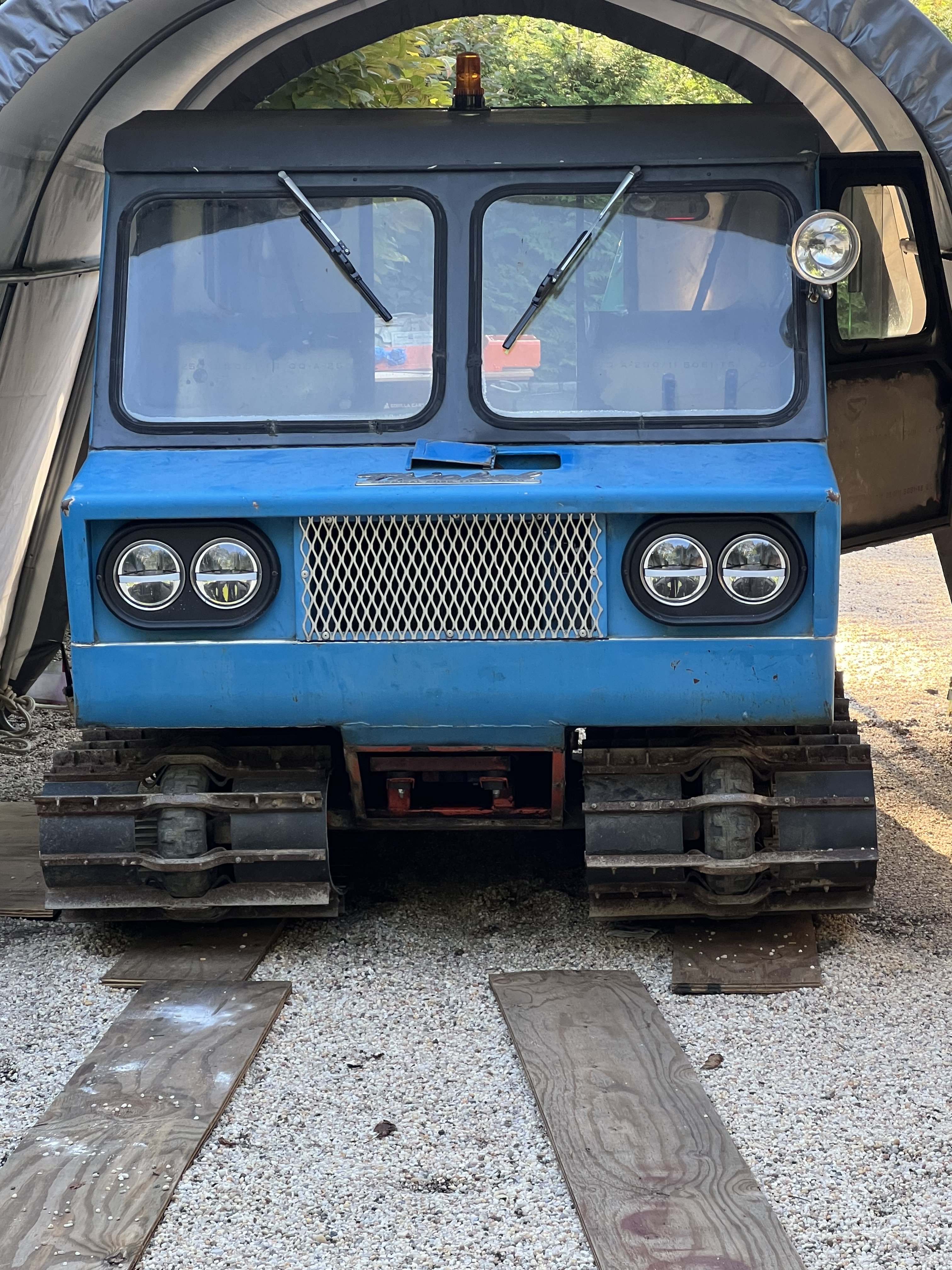

I am finished - at least I hope so! Last major item was Changing out the two master cylinders and flexible brake hoses. I changes the master cylinders because I broke the reservoir covers trying to get them off and the master cylinders had different strokes - one engaged immediately and the other pulled back 4 " before it started to engage and pump fluid out. The brake lines were full of nasty gunky cloudy fluid. Blew out both lines and then flushed the lines with a quart of brake fluid before filling and bleeding system with new fluid. I don't think I have any leaks - time will tell.
So this fall's journey:
Rewired the imp
Replaced the four headlamps with Led bulbs
Replaced rear spot light
added digital voltage meter and charging ports for i-phones etc
added interior lights
added a 120 volt converter
Two new 800 amp batteries with three way switch
Tested alternator - works but not a big power producer
added induction tach as backup to factory tach
new engine temp gauge and thermostat
new fuel gauge and sender unit
new fuel line and filters
replaced electric fuel pump to get rid of led light flicker - mostly but not all gone
new radiator hoses, heater hosed, engine hoses and fan belt
flushed and replaced radiator fluid
eight new idler wheels, tubes and 16 bearings and seals - all air filled
replaced two front idler wheels solid wheels
replaced rear left axle bearing to hopefully fix leak
drained and replaced differential fluid - interior and brake bands looked good
changed engine oil and filter
replaced carb and added vacuum takeoff for distributor advance
serviced oil bath air cleaner
checked cylinder compression - all good and consistent
set engine timing using vacuum gauge
new spark plugs and wires
Replaced exhaust system - old one leaked into cab
repaired tracks - replaced missing bolts and several missing backing plates
cleaned up interior and painted interior front cab
added seat belt
replaced master cylinders, flexible brake lines, flushed and refilled system
greased all fittings
new wiper blades
A shout out and thank you to Nancy at Sprite Improvement for many of the harder to find parts
Now to find some snow!!
