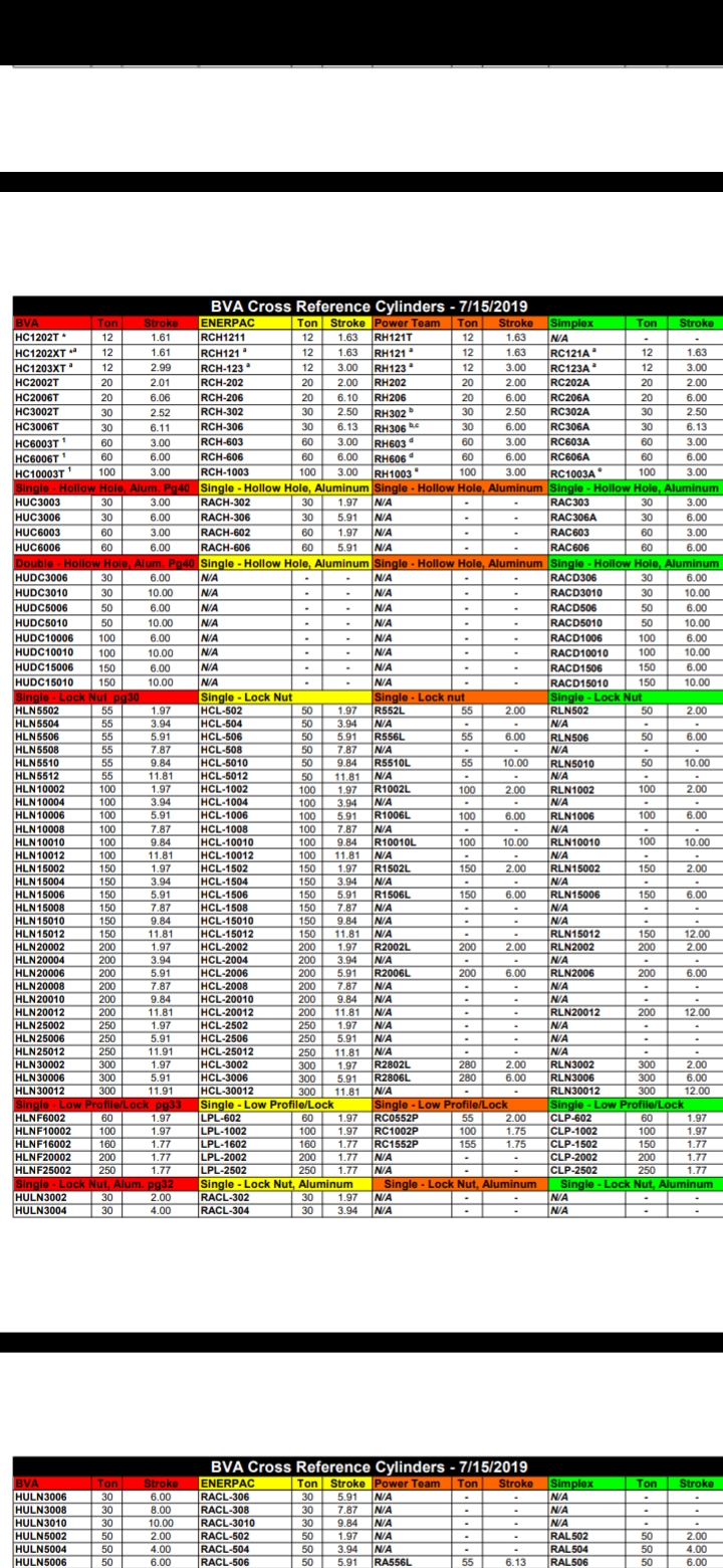

Here's a list I found awhile back for cross reference. Not sure if it'll help you or not, but it has the brake slaves on my 601.

On my 601 the slaves are right at the top of the sheet of cross #s. The bva brand is under 700 bucks a piece for them. Should be the hc1202t. For what it's worth.
