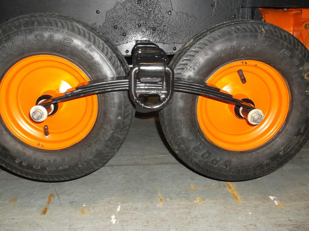

The first picture is of my 1402 springs. I added a 4th 12" leaf and arched them to 3-3/4" sitting on the the bench to the top of the upper leaf. You could go to 4" but if you go too high the tire guides on the upper track will hit the axles. The second picture is of BearGap's 1450. The springs look like the drawing above.
