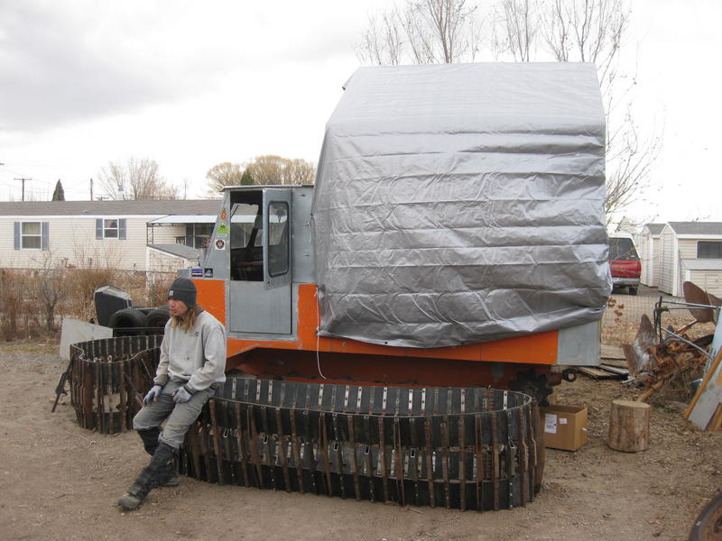

Also bought 24 used grousers and cut & drilled them to fit. Photo #2 shows, top to bottom, the originals, home made, and recycled used units. I spaced the recycled units every 5th spot so I don't have all the 2" deep blades grouped together; same with the home-made 1 1/2" bladed units. I did have to move some of the old grousers and re-mount them because I only replace 48 of the 118 grousers; made sure that there are few places with 3 in a row old grousers hoping not to have them all break at the sprocket and leave me stuck. Photo #3 shows the tracks off and results of a day and a half knuckle bustin'.

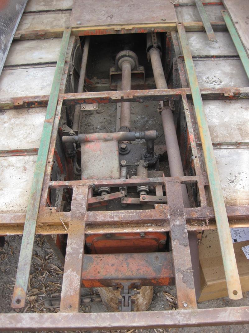

I added tube supports with factory connectors to make a canopy for the bed; I'll put a canvas top on it. And I added aluminum diamond plate to replace to rotten plywood deck. Photo #4 shows the drive train below the deck...yes, I know I am missing the bilge pump but I don't plan on running this cat on the lake.

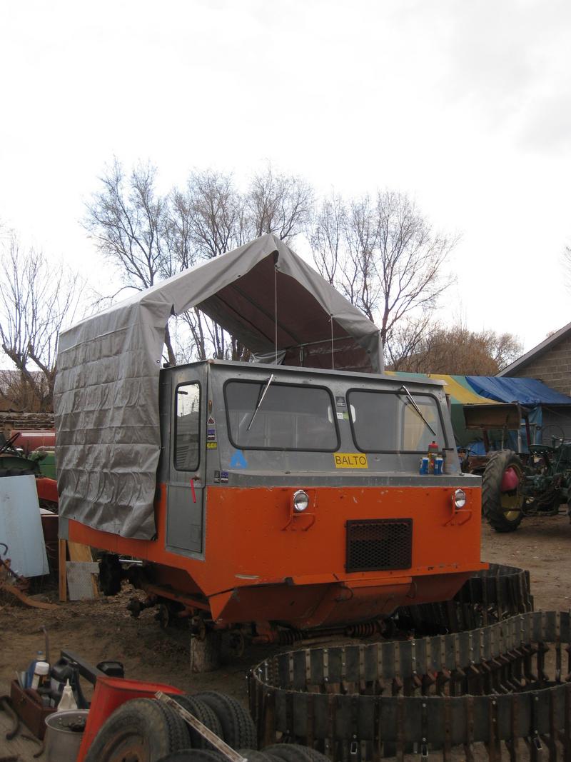

Work on the restoration continues. Scheduled test run next Tuesday at Powderhorn Ski hill. Photos attached show the new canopy...I bet I have to lower it 12" once in the field, and I sure can't trailer it and drive the roads with the canopy on.

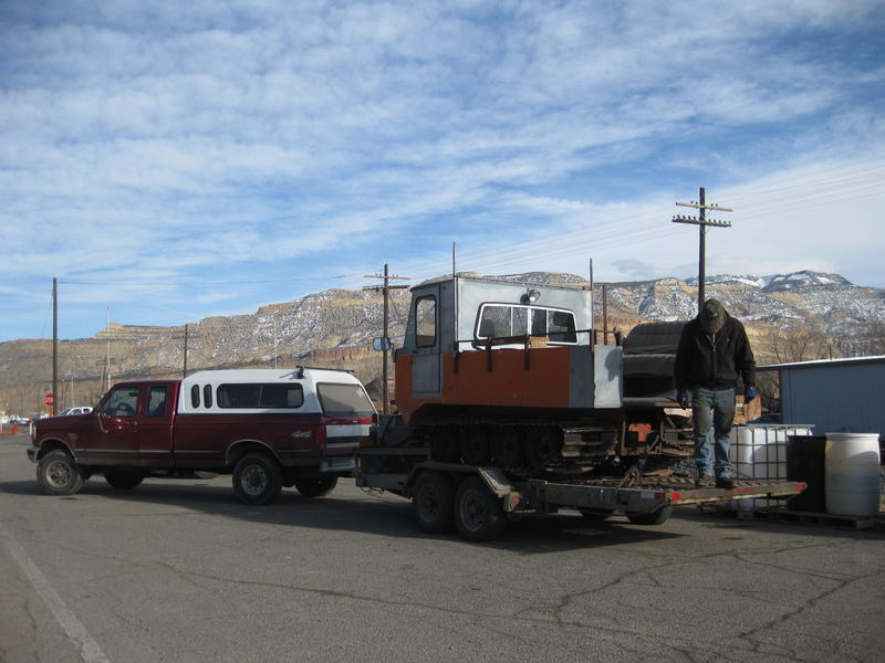

BALTO has left the junkyard; finished re-installing the patched up grousers after deciding to add new axle shaft bushings. Kind of a poor boy restore but I put it on a trailer and we'll be out to give a try on snow.

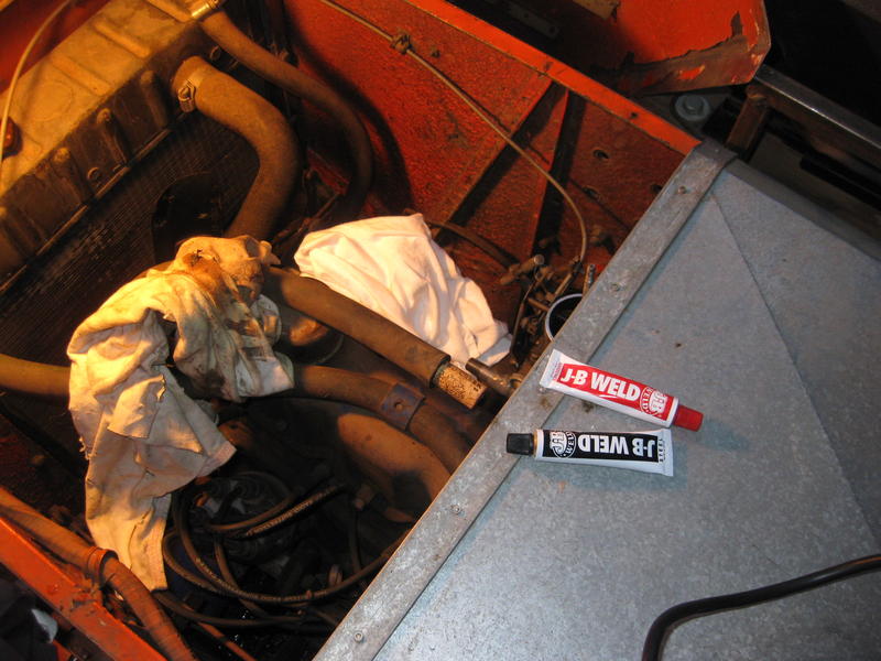

I got Balto down to Silverton; cut the track up the first 3 miles towards my property and all is well. Thought I'd make a few tweaks on the engine...adjusted the idle stop and leaned out the fuel (running at 10,500' to 11,250') and all was fine until I noticed the water hose from the pump suction to the engine looked leaky. All I did was touch it and it broke off, honest. Looks like the Ford 6 cylinder 170cc motor has a widget on the coolant side that allows pre-heat for the carburator? Anyway it broke at the hose connection. So I made repair with a 1/4" NPT tap, a 3" pipe nipple, and of course the JB Weld. Spent the night sleeping in the back of the snowcat while waiting for the JB to cure; tried using a 100watt light bulb to keep some heat on it overnight. Woke up it was 2 deg f and the JB did not cure so well. But I re-connected the hose, filled the radiator and off we went for a day of skiing. Never leaked a drop, but this summer I'll make a more robust repair.
